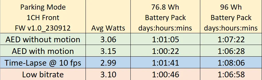

ran a power consumption test with firmware v1.2_240227 installed using an A229 Pro 1CH configuration. I tested the four parking modes with and without the GPS enabled in parking mode via the new setting in this firmware version.
With the GPS configured to be left on during parking mode (old behavior), the power consumption results were much higher than my previous tests with firmware v1.0_230912 installed.
Comparing the power consumption results with v1.2_240227 firmware installed, when the GPS is disabled during parking mode, there was a reduction of about 0.10W to 0.14W (8 mA to 11 mA @ 12.6V). This increased the projected parking mode recording times by 46 to 67 minutes (96 Wh battery pack).
I'm a little confused about the motion detection in parking mode - I thought motion detection should be a power saving feature where the camera only records when motion is detected but it seems like that's the most power hungry. Is that not how motion detection works?
The camera has to be on and processing the image to detect motion in it, that's why it's using up so much power.
yes but why is motion detection mode a higher power draw than just regular parking AED recording? Does it mean that regular AED records only when impacts are detected, and AED + Motion records when either motion or impacts are detected?
VIOFO dash cameras only offer Auto Event Detection (motion & impact), time-lapse and low bitrate parking recording modes. There is no "motion detection only" parking mode. AED parking mode creates buffered recordings for the triggering motion or impact event. That requires the dash camera to stay awake to detect visible motion activity and impacts and so it will have the 15 seconds of video/audio before the triggering event to write to the 45 second video files.

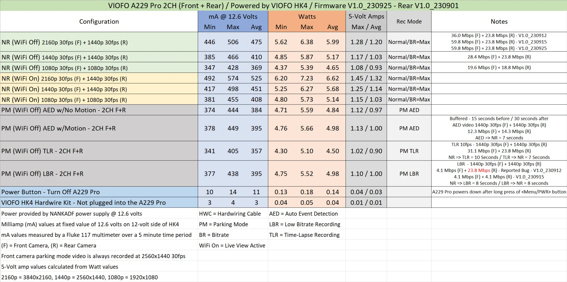

Power Consumption Test Data
3-Channel Front + Rear + Interior
View attachment 68450 View attachment 67783
2-Channel Front + Rear
View attachment 68449 View attachment 67785
2-Channel Front + Interior
View attachment 68448 View attachment 67787
1-Channel Front
View attachment 68447 View attachment 67789

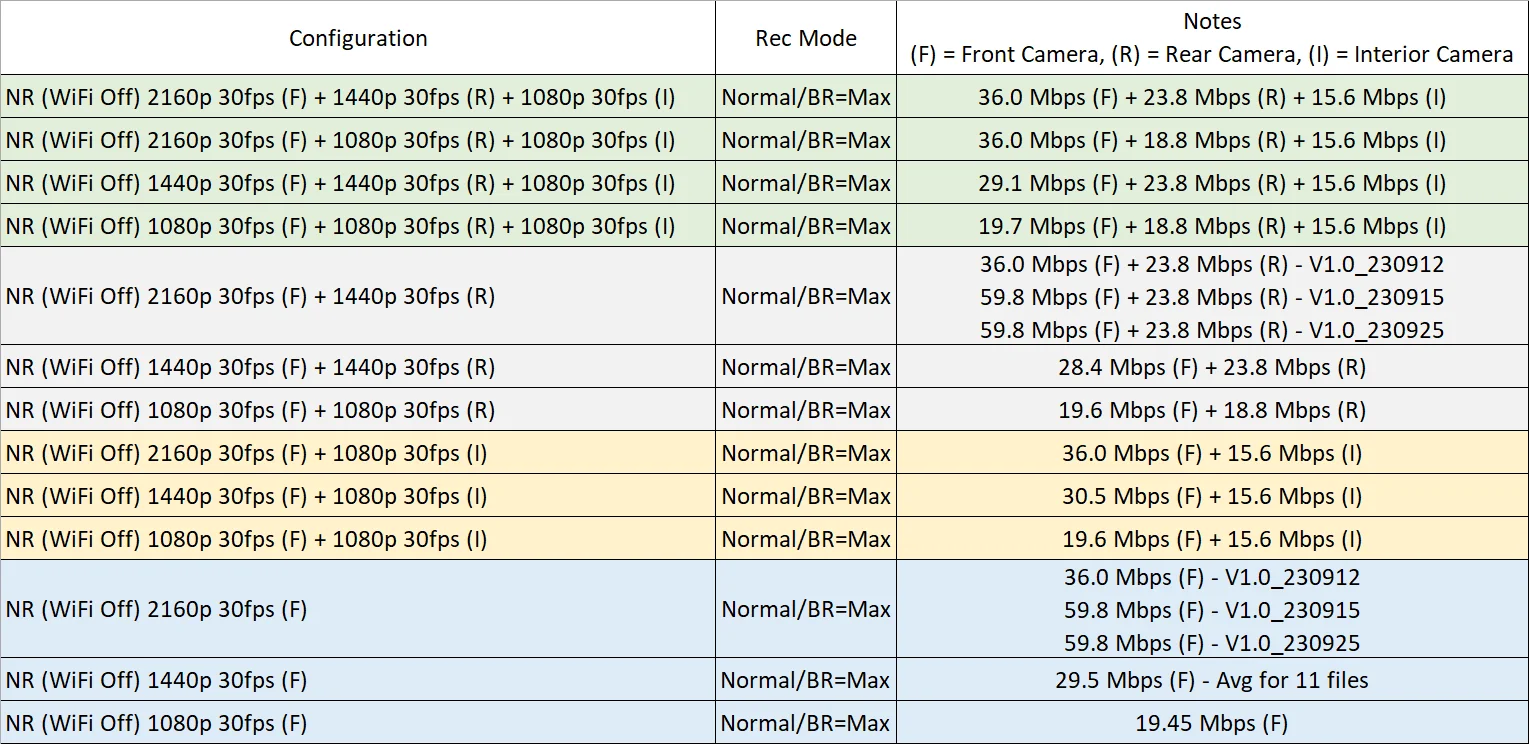

Summary Of Video Bitrate Data
