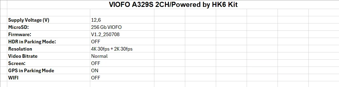

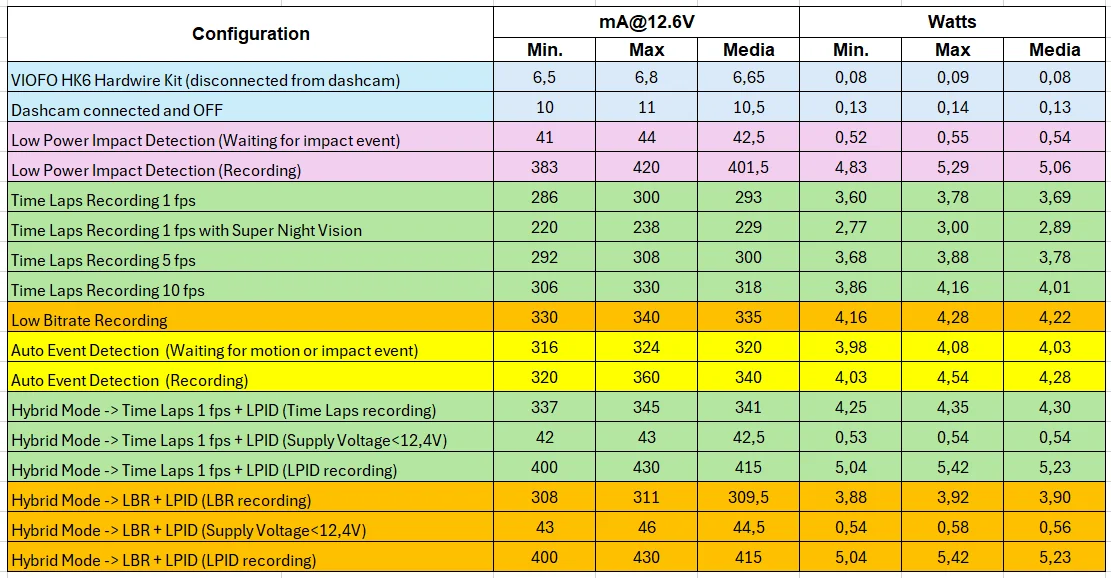

I find maybe a error in the chart. As it states Low Power Impact is .041 amps at 12.6 volts but what I get is .041 amps at 5.oo5 volts. That is a fair amount difference. So I would question if the amp readings were 12.6 volts or 5.0 volts ?? The reading I took was after the HK6 but before the a329s. The amp reading of regular 2 camera recording during driving was .853 amps at 5 volts.
I find maybe an error in the chart. As it states Low Power Impact is .041 amps at 12.6 volts but what I get is .041 amps at 5.oo5 volts. That is a fair amount difference. So I would question if the amp readings were 12.6 volts or 5.0 volts ?? The reading I took was after the HK6 but before the a329s. The amp reading of regular 2 camera recording during driving was .853 amps at 5 volts.
Those were at 12.6v since I monitor the 12V side of the hardwire kit since that’s the actual load on the car battery or dash cam battery pack

If you connect a tester between the 5-volt USB-C connector of the HK6 cable and the dashcam, you will see readings reflecting the power consumption of ONLY the dashcam itself. (41mA at 5V, or 17mA at 12V)
These readings do not account for the current consumed by the HK6 hardwire kit, which is situated in the circuit between the 12V battery and the dashcam.
Therefore, to determine the total current draw from the 12V battery, you must add the current consumed by the HK6 to the 17mA value of the dashcam, and the combined consumption may amount to 42mA at 12V, or so.
You can measure this total current between the 12V battery and the HK6, using a multimeter - take measurements on the black wire.
EDIT: corrected decimals - mA vs A.
