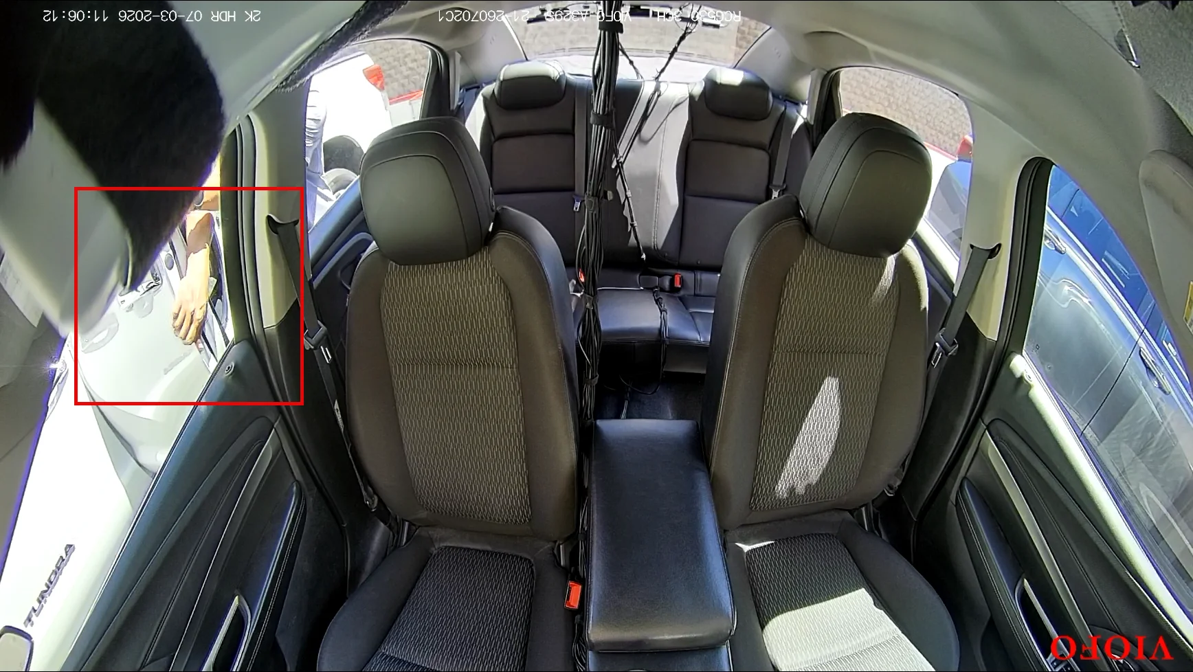

Sometimes, only the interior camera can catch the impact event to your vehicle while parked. While parked at a local Costco, it appears the person parked next to my vehicle opened the rear driver side door of his Toyota Tundra pickup and struck my vehicle's front passenger side door handle. That driver did nothing to report his impact to my vehicle. Granted, my vehicle is a high mileage ex-police vehicle that has a less than perfect body / paint job. His pickup's rear door was "stuck" on my vehicle's door handle so much that he had to apply a lot of force to remove his truck's door from my vehicle's door handle. What a guy!
Before I left home, I had just installed a new firmware in the A329S 3CH. I forgot to adjust the settings for the interior camera to rotate it 180 degrees. That's why I had to rotate it for this screenshot.
How did you find out about the impact? Loomis Costco not to much parking there. Is there a new update for A329S 3 CH?
Just prior to this incident [at 11:00 AM], I had returned to my vehicle to drop off some items in my trunk [new eyeglasses]. That is what I expected the impact notifications to be about when I started the engine. I have seven dash cameras all squawking at me when I start the engine, so I dismissed the impact warning. When I arrived home, I copied the video footage from those dash cameras to my NAS drive. I reviewed the parking mode impact events from each dash camera. That's how I found this particular impact event. If I had paid closer attention to the Thinkware U3000 Pro's LTE module impact notification, I would have detected this while at the Folsom Costco. There's a scrape on the bottom of the door handle, but it's an old car with a lot of war wounds from being a former police patrol vehicle for the San Joaquin Sheriff's department. At least he didn't dent a door panel.

I should also say that a BlackVue Elite 9 also notified me of the impact event. I had my phone is my pocket while I was walking around the Folsom Costco building. I really don't know how I missed both push notifications for the impact event, but I did.
I assume that whilst the interior camera was the one to record the actual impact, either your front or rear camera was able to identify the other vehicle arriving or leaving, if you had wanted to follow up on the indicent.
Yes, eventually there was rear camera footage of the vehicle backing out of its parking spot and leaving.
It comes down to which parking mode configuration you have selected. Low power impact detection [LPID] parking mode would likely have started recording 1-second after the initial door handle impact event. LPID would not have captured the vehicle backing out of its parking spot since there was no impact event caused by that action and it was several minutes after initial impact event. The other dash cameras in my car that were configured for their "energy saving" parking mode or impact based parking mode, did not capture footage of the pickup truck leaving.
Time-Lapse and Low Bitrate [the one I was using] parking modes would have footage of his vehicle leaving. Auto Event Detection would likely have been triggered by motion within the field of view of the rear camera as well.
After this guy removed his pickup truck's door from my car's door handle, he simply returned to the loading of groceries into his pickup truck. He then walked the shopping cart away from the area and returned several minutes later. As the guy is beginning to drive away, you can see the guy's face looking towards the rear of my car and it almost looks like a bit of a shock to him to see the large number of rear dash cameras in the rear window. 🙂
