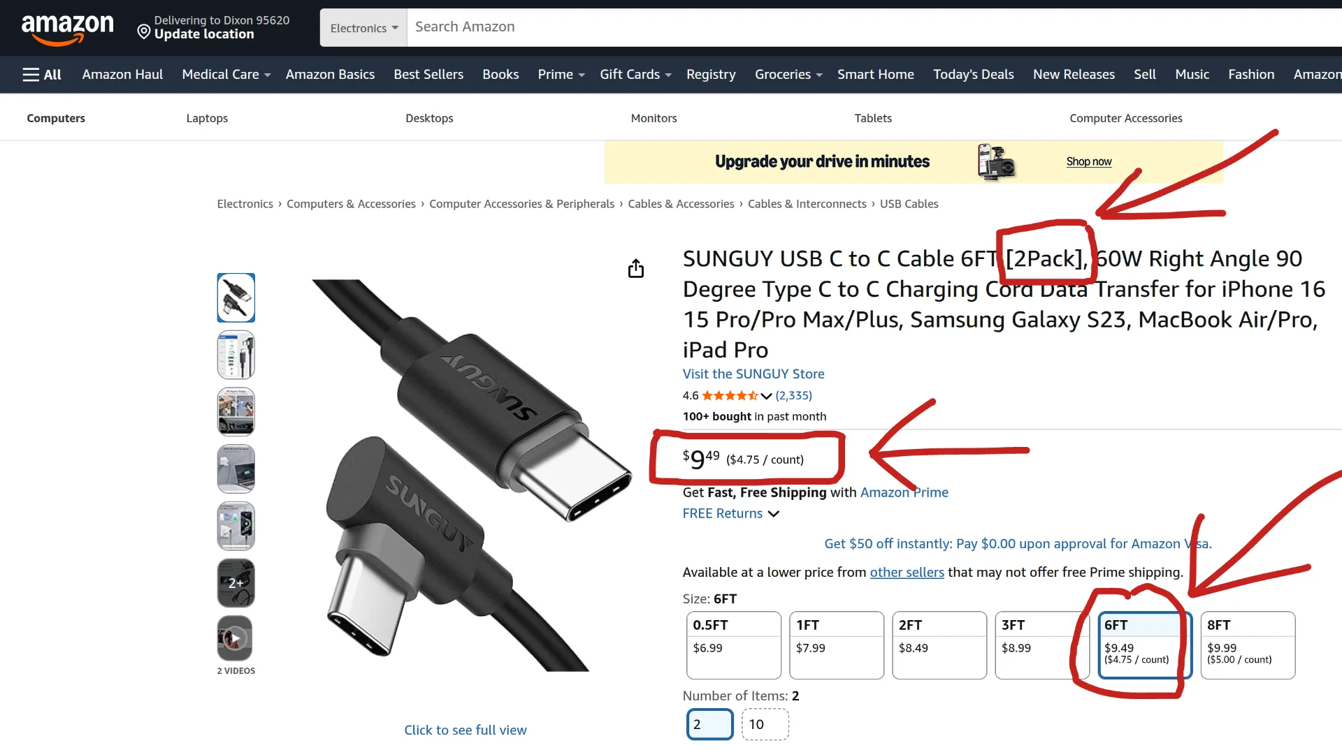

Here's a link to the cable. I'm using the 6ft version, which is actually 6.6ft/2m, but 8ft/2.4m cable is also available there, though I haven't tested it.
This cable cost is only about $5 each:
https://www.amazon.com/gp/B09CCL8H1Z
It's worth noting that the Viofo SSD Cable, which also works with SD Card Reader, is about 4.9 mm in diameter and a bit stiff, while the cable linked here is only about 3.8 mm in diameter and is softer, making it easier to install.

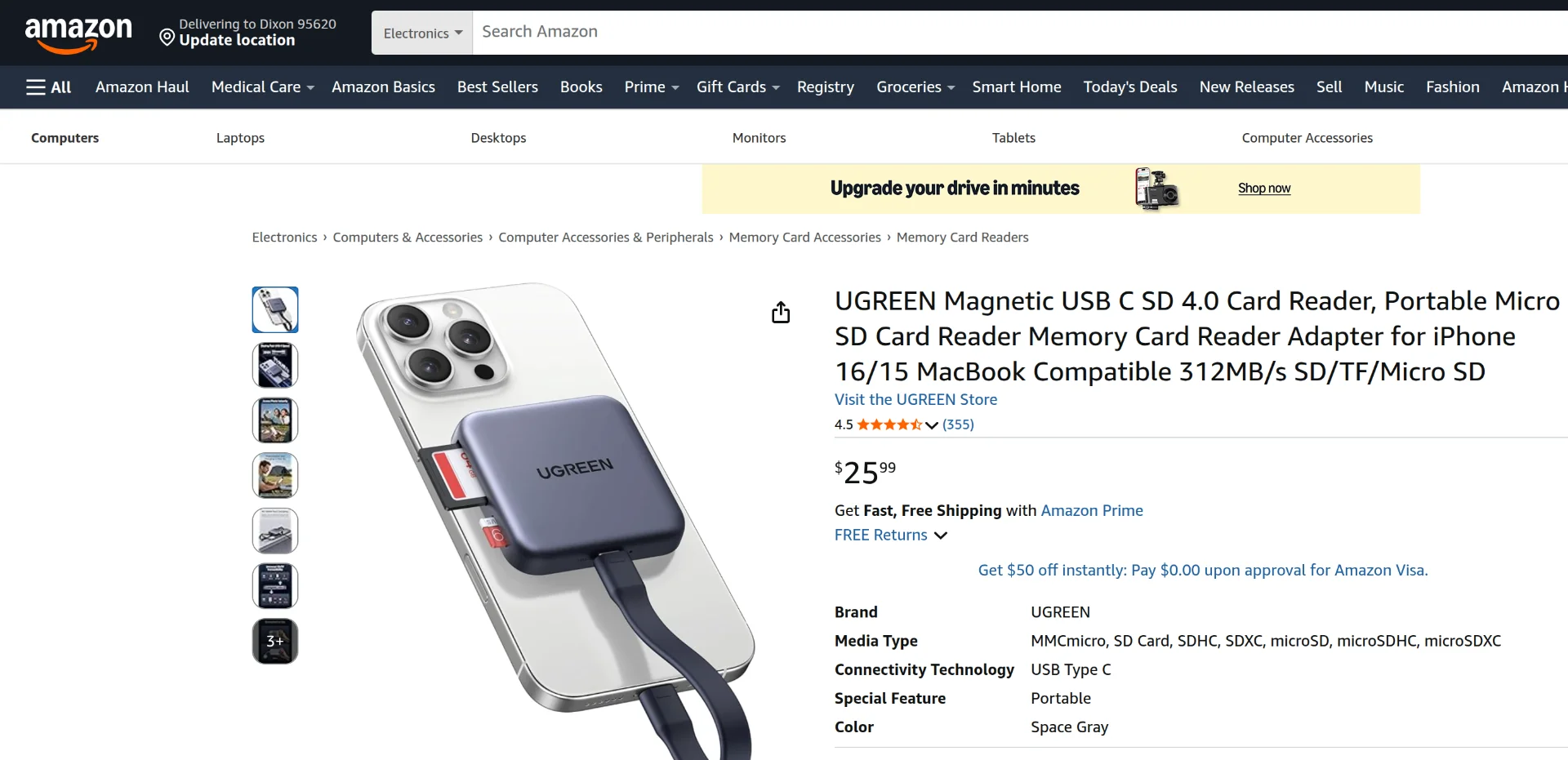

Here's a link to the Card Reader:
https://www.amazon.com/gp/B0DRNXG4X5
It works with all of my MicroSD cards: SanDisk High Endurance; SanDisk Extreme; SanDisk Extreme PRO; Samsung; VIOFO Industrial; from 128GB to 512GB.
However, it should be noted that Viofo dash cams do not recognize standard-sized SD cards in dual-slot card readers.

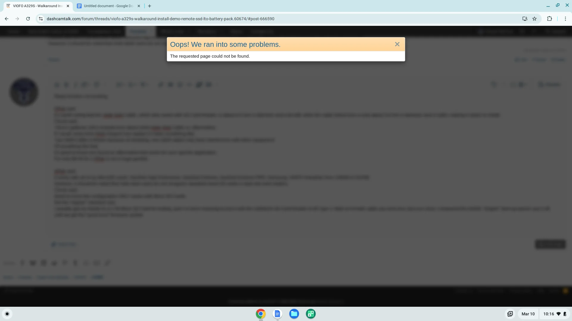

Reply function not working:
@GPak said;

There’s gotta be 100’s of posts here about OEM Viofo SSD Cable vs. Aftermarket.
If I recall, every time Viofo-Support has replied it’s been something like;
“Our OEM Cable is thicker because of shielding, non-OEM cables may have interference with other equipment”
Or something like that.
It’s good to know you found an aftermarket that works for your specific application.
For only $9.49 for a 2Pak it's not a huge gamble.

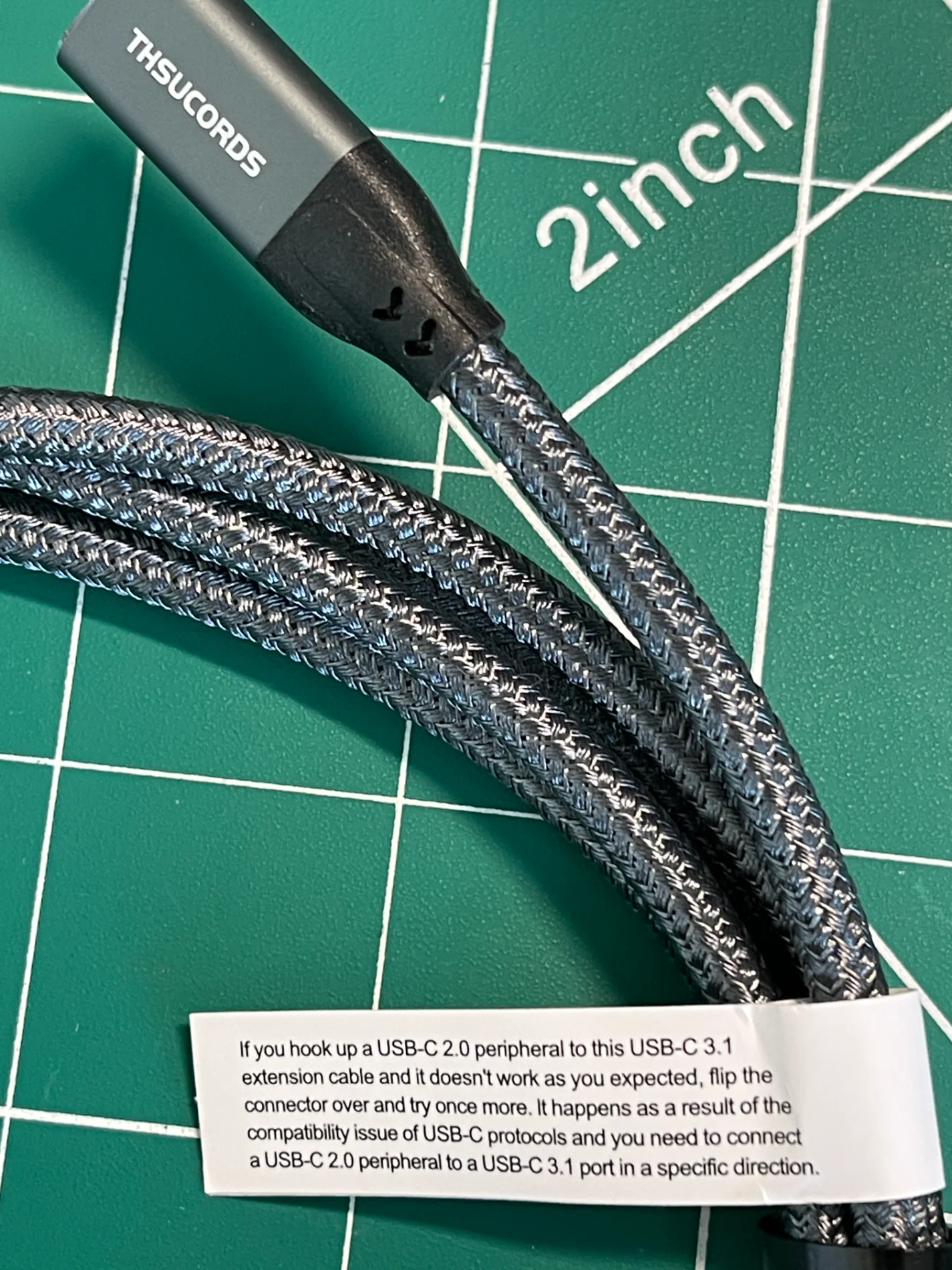

A little more on Cables.
Viofo is right that “non-genuine cables may cause interference”, and in the case of SSD and SD Card Rider it is specifically interference with the Viofo’s GPS.
Using the high-speed USB-C male to female cable (the one that you and I tested) I initially didn't notice any interference with the GPS signal since GPS was disabled (I didn't want my speed to be displayed).
However, with the advent of the geo-fencing, which I really love, I enabled GPS and noticed that the GPS signal was mostly absent or unstable.
I did some research on this and found that the key is to avoid using the newest and fastest USB-C 3.0+, 5Gbps+ cables.
Instead, use a USB-C 2.0 cable, with data transfer speed of up to 480Mbps. (I believe, Viofo uses USB-C 2.0 port/protocol)
But even among USB-C 2.0 cables, not all are compatible with Viofo’s GPS, so after trying a couple of options, including a shielded cable with ferrites on each end which also didn’t work, I finally found one that has been working consistently and reliably for about three weeks now in my 2026 Honda Passport.
For reference, attached is a photo of an interesting label on one of my USB-C 3.1 cables that surprised me;
I always assumed USB-C cables were symmetrical and worked regardless of orientation.
Also, the newer USB-C 3.1+ cables are generally thicker and stiffer than older USB-C 2.0 cables.

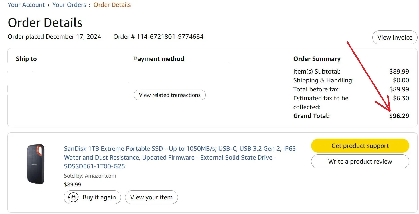

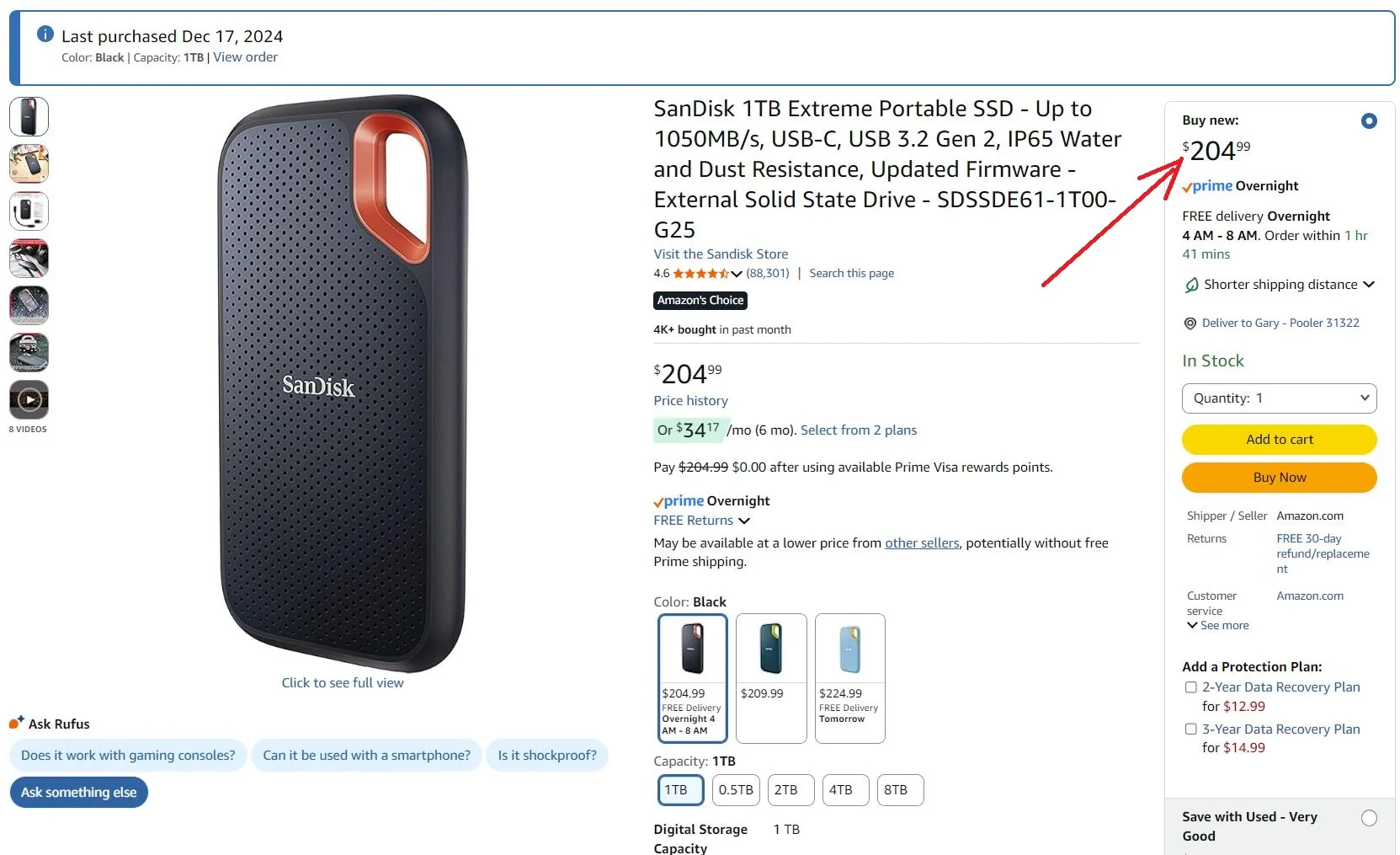

BTW, about a year and a half ago, when I bought this SanDisk SSD, I paid less than $100 for it. Today, the same SSD costs over $200!
