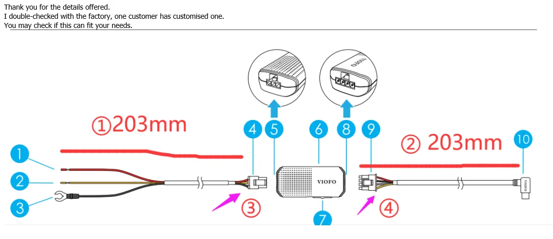

The support agent just replied this morning, telling me that a customer had customized one about 8". I don't know if that would be long enough.......thoughts..

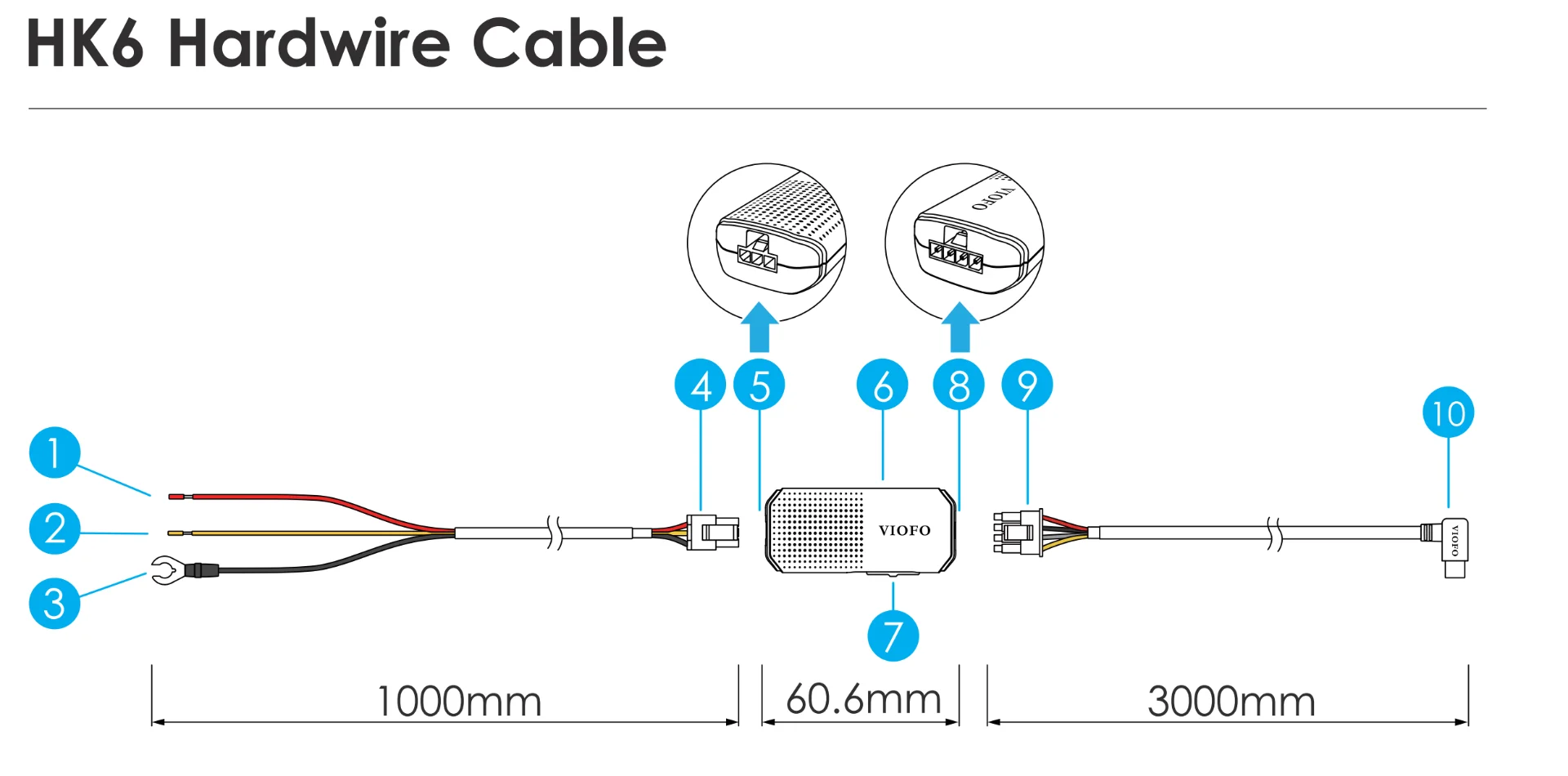

I’m confused, the standard HK6 is;
1 Meter Long: 12V Power Wires
3 Meters Long: Type-C Cable
4 Meters Total Length
I think 12ā€ inches of Power Wires, and 12ā€ inches of Type-C cable, (total length 24ā€ inches) would be OK.

I think she was using that as an example, but I stated I would need one 12". So I will have to wait till late this evening or in the morning for a reply. I think 12" cabling will work--it is rather compact. The wiring harness from the light console to the mirror power plug was about 12".

Absolutely! Will do all that before even attempting. Viofo Support told me that the short HK6 cable would be cost prohibitive. But Viofo support is going to ship out that 8" HK6 cable that they had. I will see if it fits. I will try to get the cameras and all that tested this afternoon and get it registered. Thanks!
