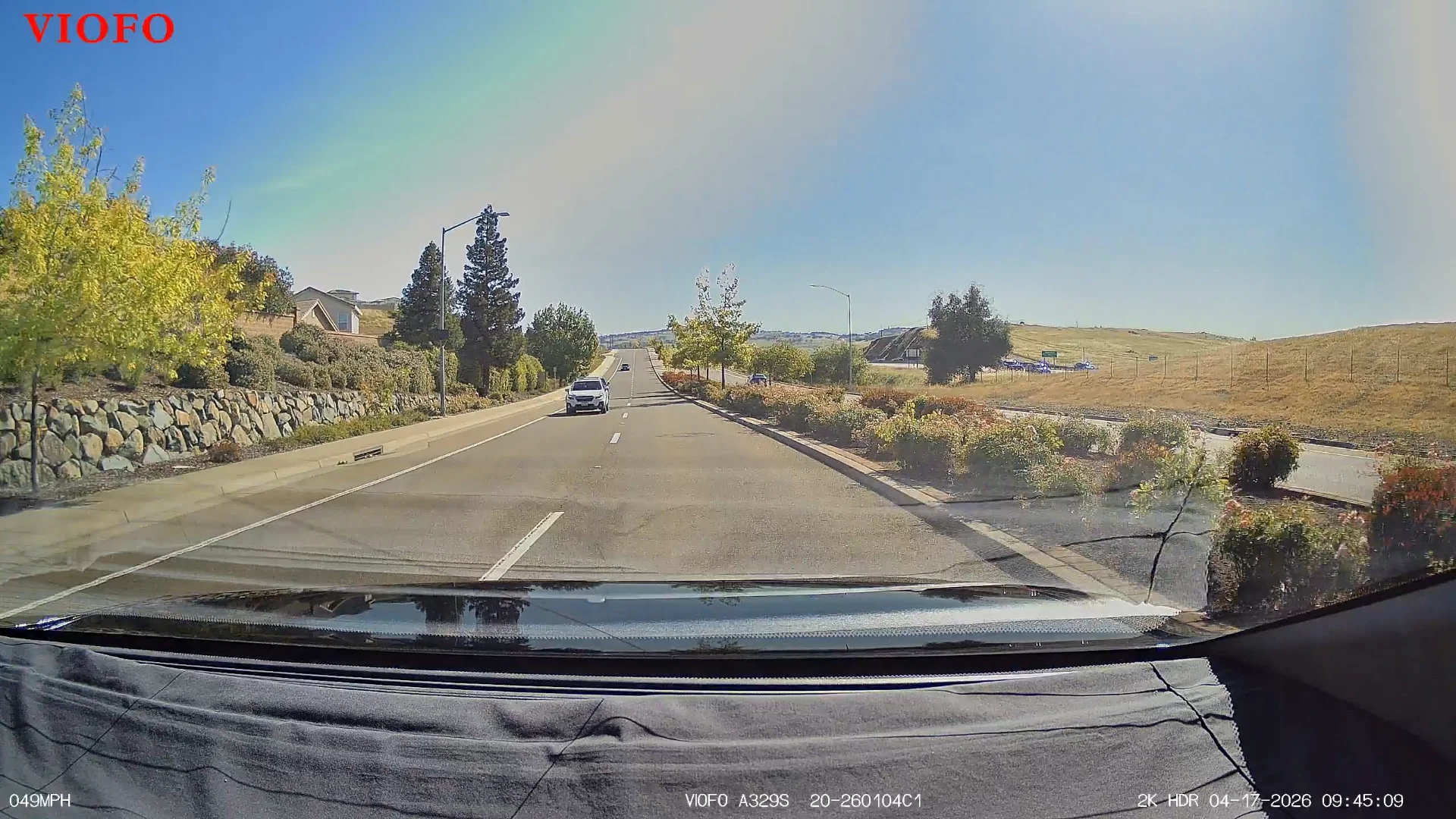

Can you elaborate further and provide a screenshot / video where colour / color banding is an issue? Does this happen with and without a CPL filter?
- Eliminate colour banding on rear camera in daytime HDR (may require new lens?)

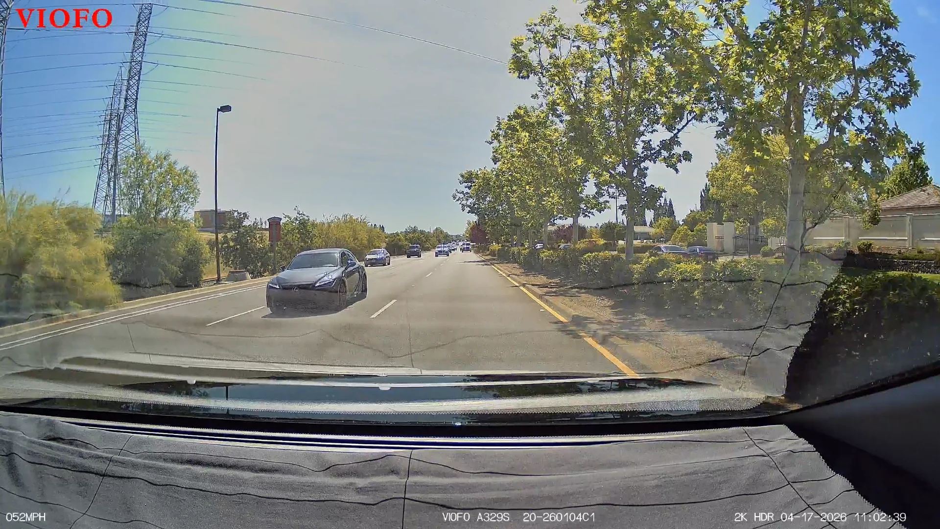

I've run into this as well. VIOFO has stated that the rear camera lens is likely the root cause of this issue. My A329S 3CH rear camera does not have any CPL filter installed.

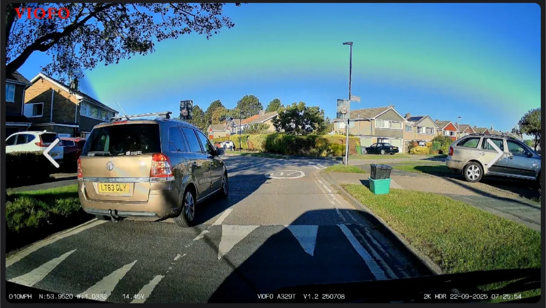

I observed this colour banding on the rear camera, with and without a CPL, but only with HDR enabled. My rear screen has no tint.
As @rcg530 noted, Viofo think the issue is the lens. I stopped using HDR on the A329S rear camera so it was no longer an issue for me.

On the banding, is this only on the Rear Camera? What about the Telescopic Camera with HDR enabled? Since my window is tinted (front and rear), I don't enable HDR on the rear as it's moot. Did Viofo say if this is a Firmware issue or is it a design issue? You'd think CPL would eliminate banding.

Your camera seems further away from the rear windshield than normal. Would placing directly on the glass make any difference on the banding?
The A329S rear camera is mounted directly on the rear window glass. The rear window glass does have a steep angle to it, but it's not abnormal for a 4-door Chevrolet/Holden sedan.

The color banding is very noticeable with HDR enabled and the sun usually must be behind the vehicle shining directly onto the rear window glass / A329S rear camera lens.
Another A329S rear camera in my Chevy HHR also shows the color banding with HDR enabled. The rear lift gate window glass for the Chevy HHR is near vertical and the A329S rear camera is mounted directly on the rear window glass.

I think it's a combination of a lens issue (e.g. flare) accentuated by the HDR processing.

I reported this to Viofo in Sept 25. I believe they were already aware of Robert's similar report.

Just tested holding the camera outside the car, it's still there.
