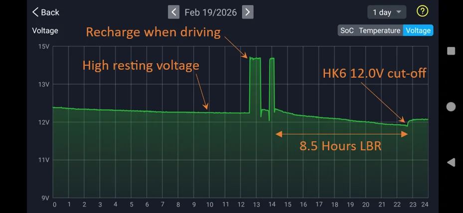

Here is a screenshot from the BM200 battery monitor, overlaid with my own annotations, showing 8.5 hours of low bitrate parking on a day where the resting voltage was high prior to commencing parking mode.
- I note that the battery voltage recovers by about 0.1V when the load is removed as the HK6 shuts off.
- I can also see that the voltage reported by the HK6 is slightly higher than the BM200. The voltage at cut-off according to the BM200 was 11.89V.

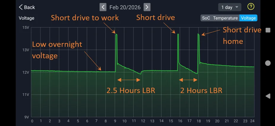

The following day I made the short drive to work then left the A329T in low bitrate parking mode. As shown in the graph below, the HK6 reached the 12.0V cut-off after only 2.5 hours. Later in the day I took another short drive, after which the battery dropped to 11.93V in just 2 hours of parking recording.

- I can also see that the voltage reported by the HK6 is slightly high. The actual voltage at cut-off according to the BM200 was 11.89V.
How do you know HK6 is reporting “high” and BM200 is not reporting “low”?
Do you have a FLUKE to check accuracy of BM200?
We've had this discussion elsewhere on DCT before. I'm not really bothered whether the HK6 reads slightly high or low, so long as it is consistent in what it does. If I want the HK6 to cut-off earlier I'll set it to 12.2V, if I prefer later I'll set it to 11.8V which is what I have at the moment. Using the BM200, I can see that the battery voltages vary by much more than whatever the tolerance is within the HK6, so I'm not concerned about it.
I updated my post above to say that as an observation from looking at the graph, the voltage reported by the HK6 is slightly higher than the BM200, and in the summary I added a note that I'm not concerned if they read slightly different voltages, provided each device remains consistent.
In my view, it's nice to know the HK6 actually does cut off to protect the battery.

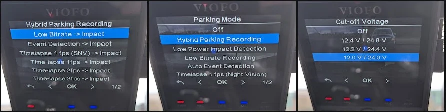

In post #25 above I showed that the small 12V battery in my car is not ideal for powering the A329T in Low Bitrate parking mode for 9 hours whilst I am at work. One option for me is to purchase a dedicated dashcam battery. A lower-cost alternative is to purchase a HK6 hardwire kit and use Hybrid Parking mode in the A329T.
Hybrid parking mode allows the user to set 2No cut-off voltages, one in-camera and typically a lower voltage in the HK6. When the power supply voltage drops to the cut-off selected in-camera, the dashcam switches from the selected mode into Low Power Impact Detection (LPID). In the example below I set the in-camera cut-off to "12.0V", and set the parking mode to "Low Bitrate -> Impact". The HK6 was set to 11.8V.
