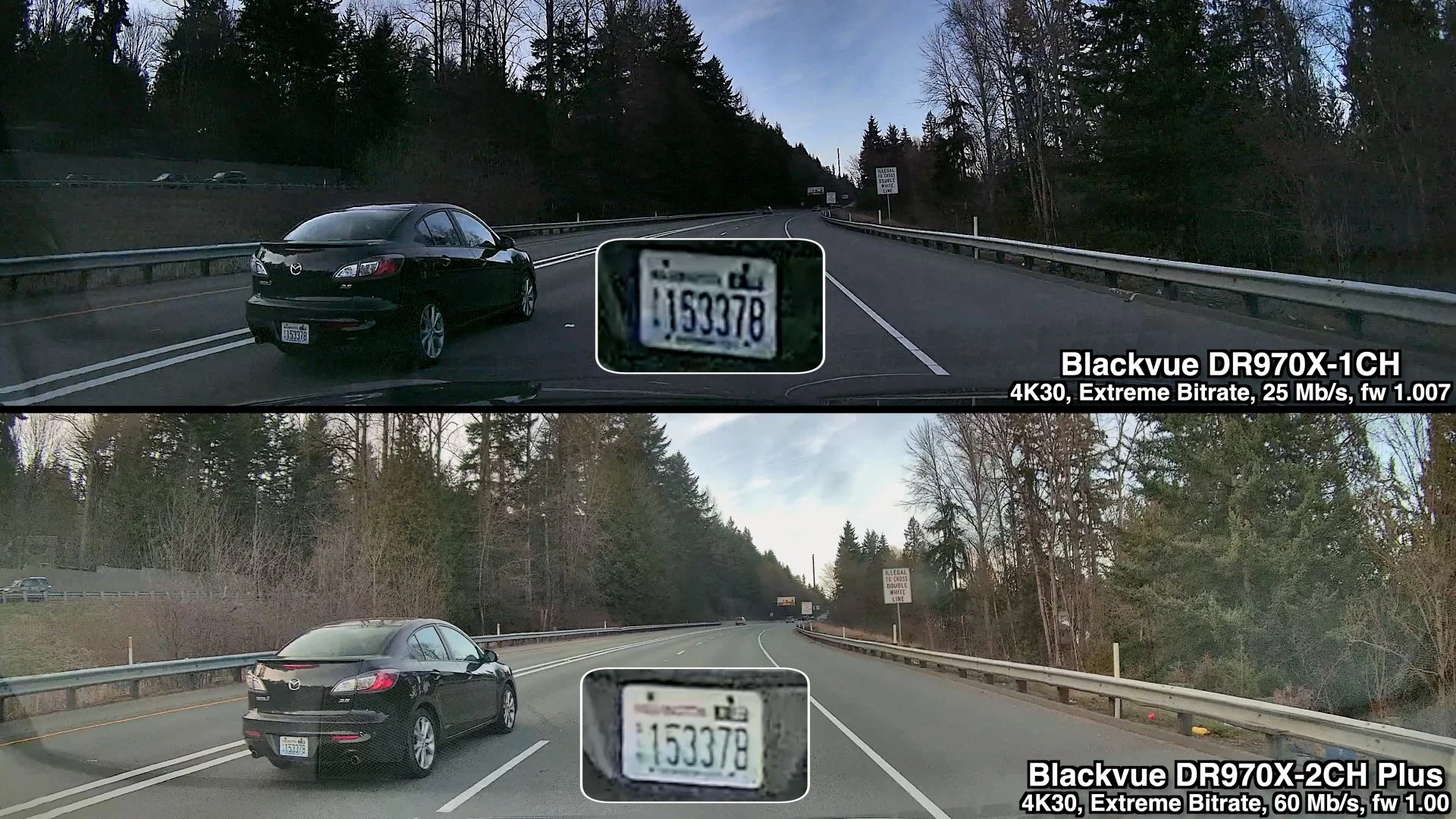

Here's a car slowly passing me on the highway. Since there's a small speed differential, both dashcams do fine.

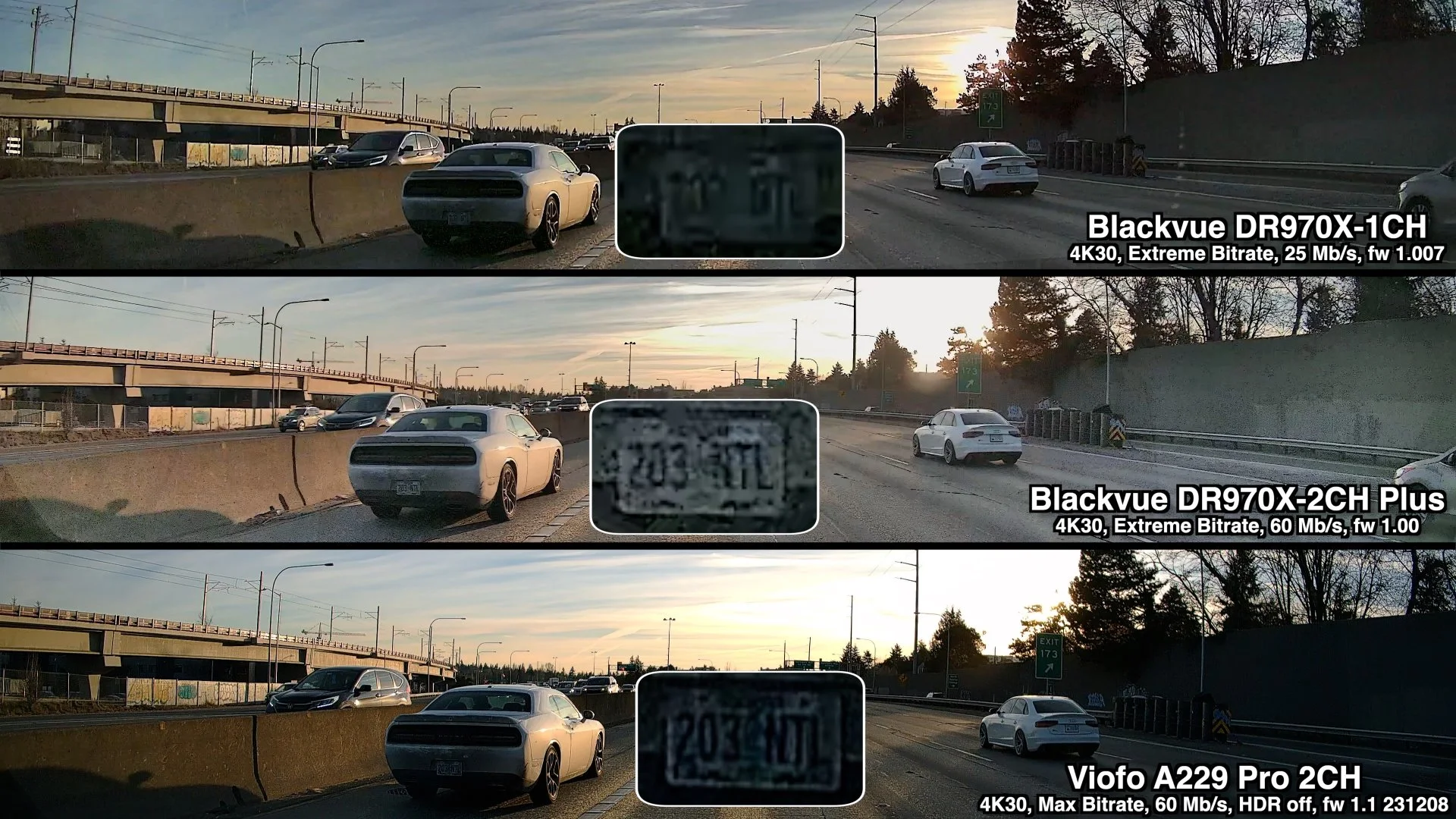

Here I'm passing cars with a faster speed differential and you can start to notice more of the difference between models:

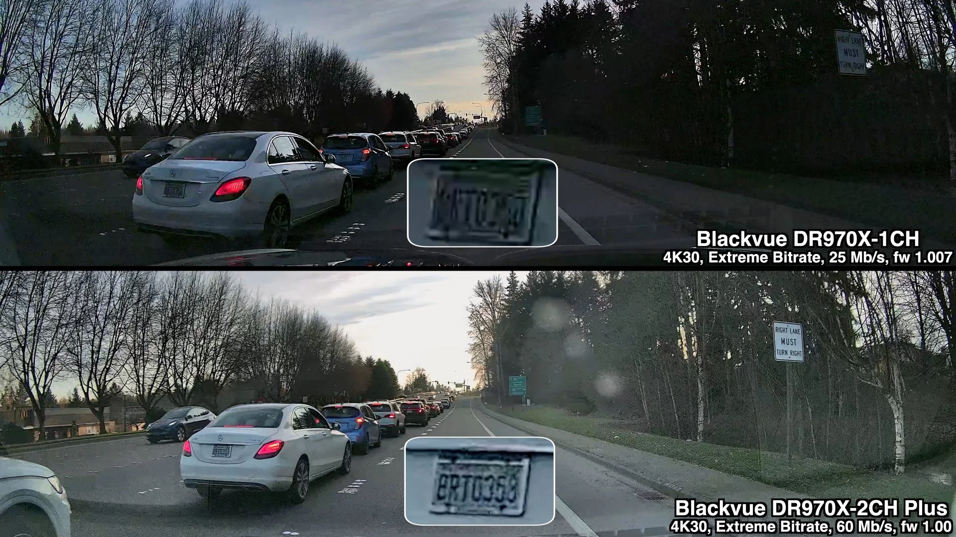

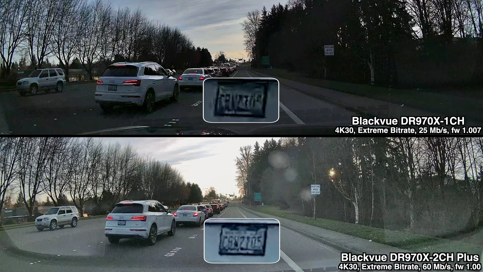

It's certainly not perfect, but it is better. Here's another with a car passing me quickly on the highway:

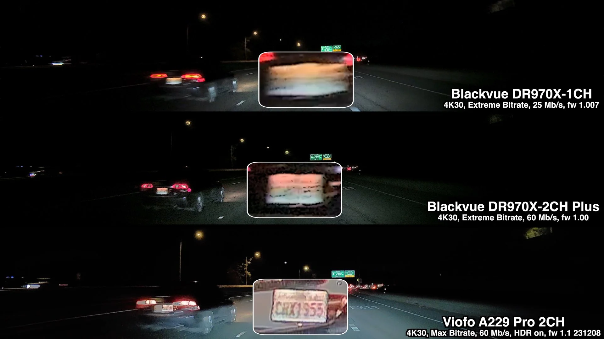

The video quality from the DR970X Plus does seem a bit grainy. The Viofo footage looks much more clear and crisp. I'll post some video samples later on so you can see.
As far as HDR, Blackvue didn't include it and while the faster shutter speeds help to stop motion, I feel like it's not enough to capture plates at night.
DR970X, DR970X Plus, A229 Pro comparison, Night highway plate with car passing me quickly.jpg
