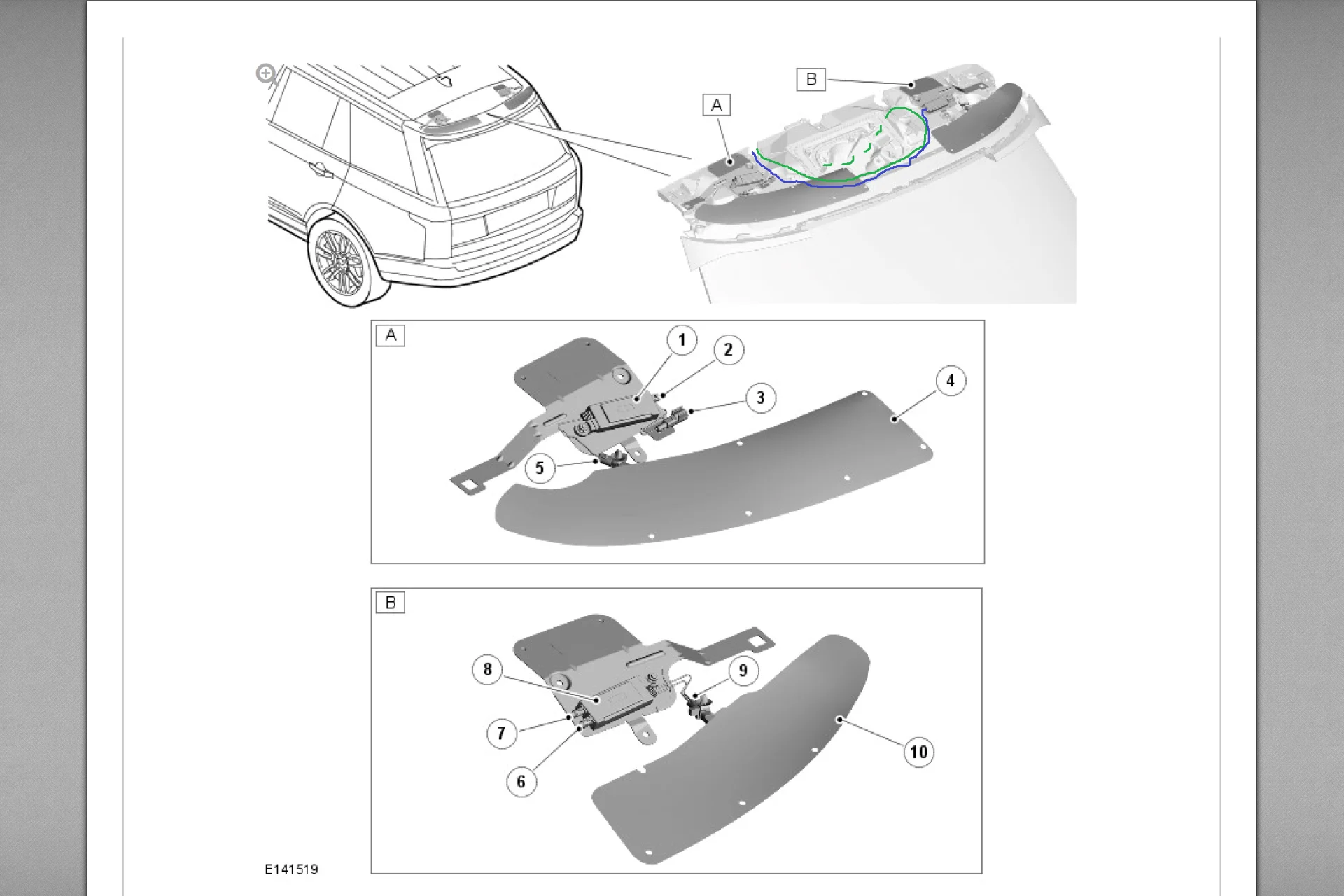

The image below shows the setup, of the two flat antennas, the one on the right 'B' is the DAB band III & FM antenna, the other is AM/FM. The amplifier is mounted adjacent on a metal ground plane, I've checked the ground connection and resistance measurement from the ground plane to battery -ve terminal is 0.06 Ohms. The DAB band L antenna is in the roof 'fin' along with GPS and GSM antennas.
The two badly drawn lines represent cable routes, the green one is the camera cable, the dashed section shows where it passes through an existing wiring grommet into the interior of the car, the blue line shows the existing co-ax antenna cables, these are RG174 with braid & foil shielding. Total parallel distance of the camera & antenna cables is ~700mm including where they pass through the flexible tube between liftgate & car body.
So, has anyone else experienced this? I have previously diagnosed similar on Audi & Mercedes-Benz vehicles where the DAB antennas are printed on the rear screen (not the case in my scenario) and the rear camera completely knocked out DAB reception, mind, the camera's were 'bargain basement' and the cables even cheaper...
Assuming I can definitively identify unwanted electrical noise from the cable or camera, although the camera is probably 150mm away from the antenna and 200mm from the ground plane, I'm considering applying some copper tape to the outside of the cable and connecting to a suitable ground inside the car. Although the AM/FM co-ax cables run to the front of the car, the DAB co-ax only run a short distance (about 1.4m) inside the car to the DAB receiver module where the output is transmitted to the amplifier on the MOST (optical fibre) ring so I'm sure the signal attenuation is occurring within the liftgate area.

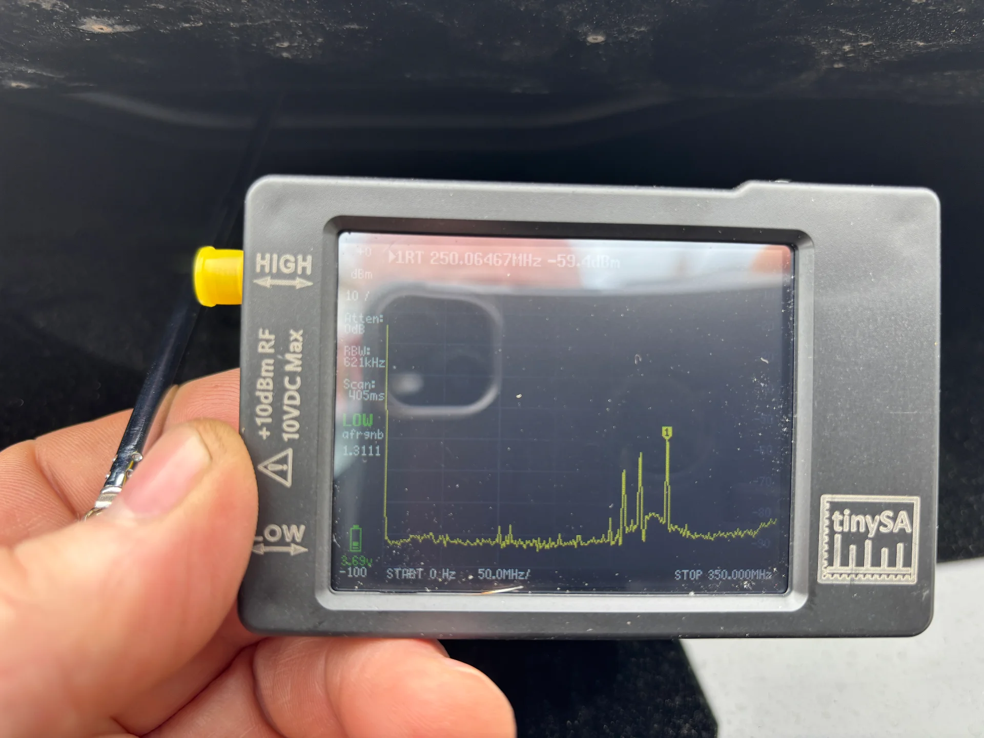

I managed to find time today to have a poke around with a RF SA,

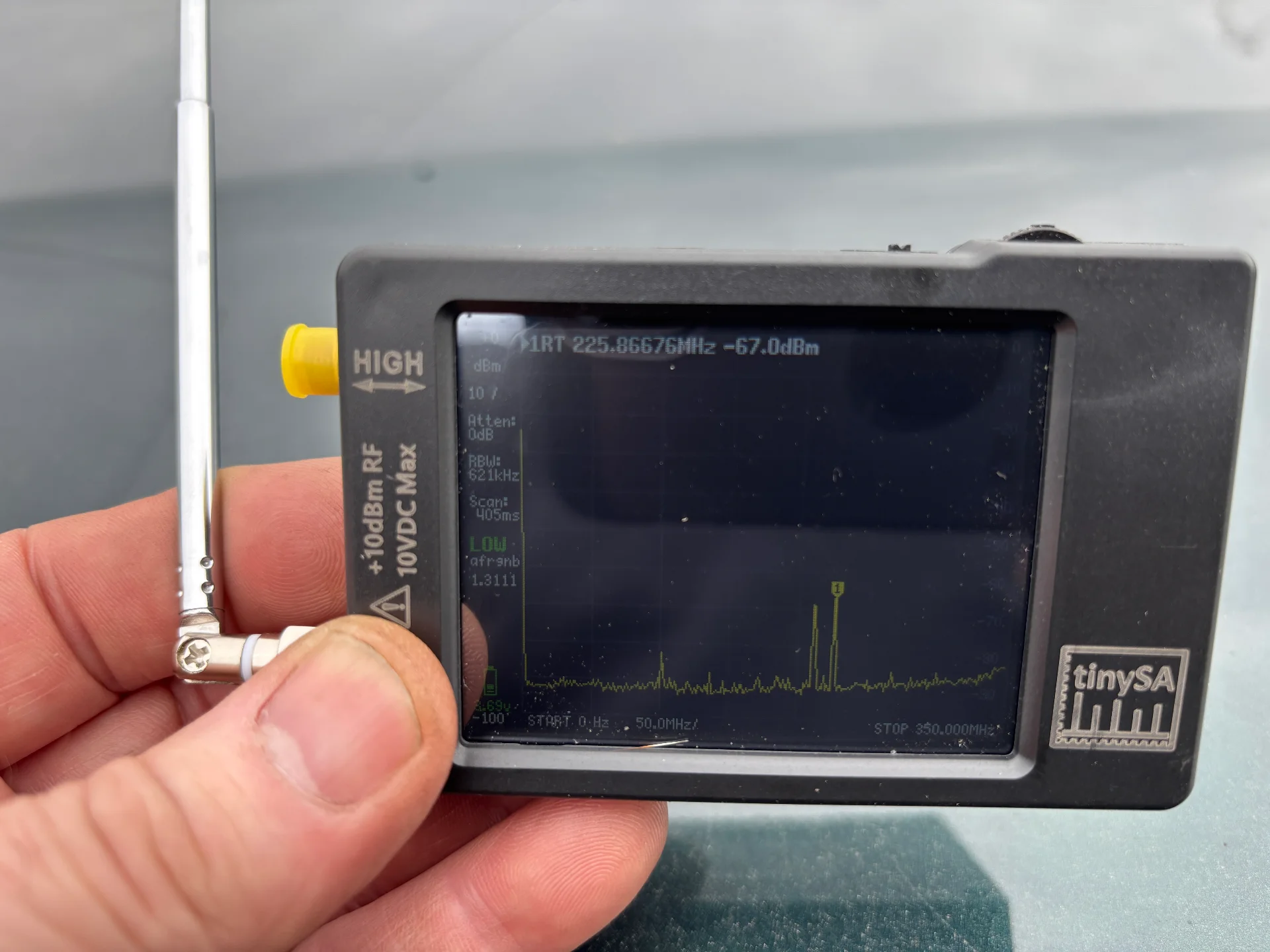

With a wideband antenna connected, I firstly established a baseline by scanning away from the vehicle, you can see the DAB multiplex 'spikes'.

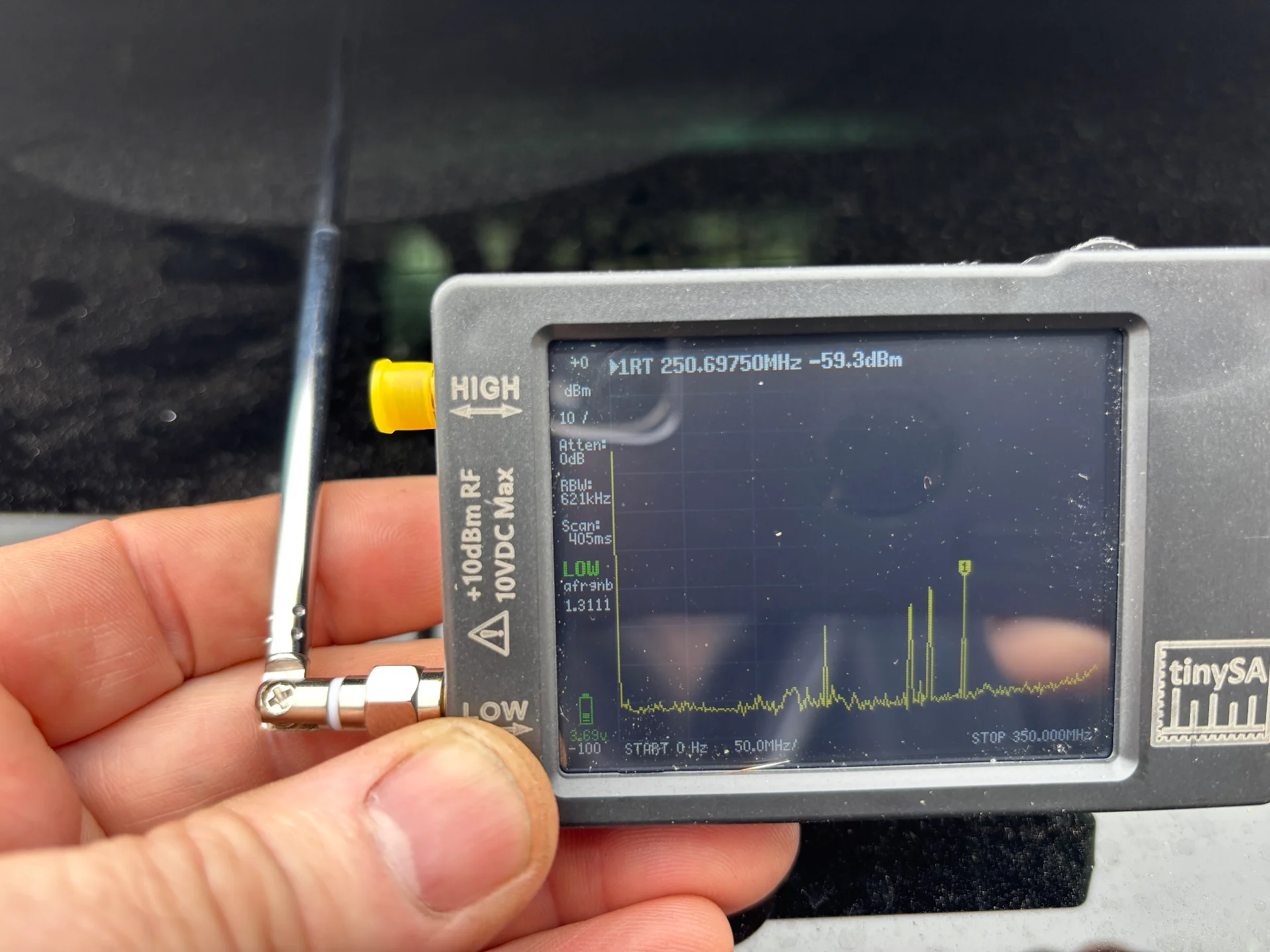

Then did the same scan for >10s with the ignition on and DAB active but with the antenna pushed up between the spoiler & antenna / camera cables
The following images show a spike at ~250MHz, this only occurs every few seconds and is stronger than the received DAB frequencies. This only occurred with the rear camera connected to the main unit. Disconnecting the camera cable with everything still energised caused the ~250MHz spikes to disappear, monitoring was for 5 minutes with the camera connected and 5 minutes with it disconnected.
There also appears to be an increase in background noise from 200MHz upwards, not always though.
I think my next course of action is to cover the camera cable in Copper foil tape, with a drain wire connected to the car body and re-test.
What I think is happening, is there is some 'leakage' from the camera cable, which is being picked up by the antenna, as it's essentially just 'noise', it's causing the correctly formatted signal to 'drop frames', which then have to be re-synched once the noise is below the level of the DAB signal. The spikes are only of a brief duration, probably 200-300mS. Unfortunately we don't have measurement equipment, only indicative so I can't be more precise than that.

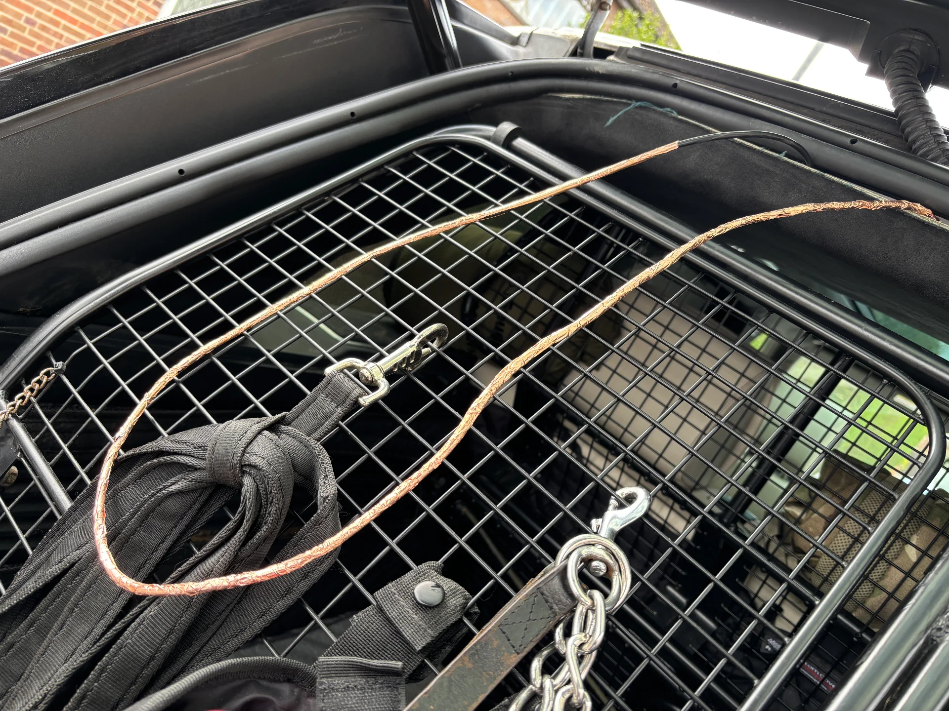

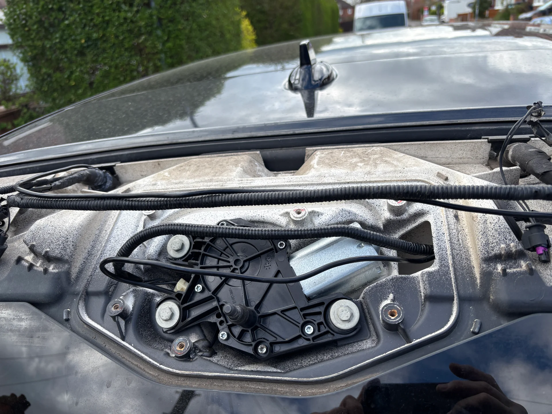

I managed to find time to whip the liftgate spoiler off and add copper tape, re-route and add loops to the rear camera cable
Unfortunately I got stuck in before remembering to take a photo, you can see the approximate route of the camera cable here
Once I'd got it out of the grommet, pulled through into the car but leaving the plug sticking out of the flexible containment tube, I applied the copper tape. my original plan was to apply it lineralrly then 'just fold it over' the cable. Nope, very sticky and very fragile, so after cleaning off all the little bits of sticky copper, I spiral wound the tape onto the cable - not easy, but better than my first approach (there's probably some old bloke at NASA that used to wrap bits of Apollo spacecraft that could do it in his sleep better than I did in half the time!).
I then pulled it back through the flexible containment, made another entry point (sealed with Butyl rubber tape) put a couple of loops in as advised by m'learned friend, soldered a drain wire to the copper tape and connected it to a ground stud, re-assembled everything....
Then went for a drive - Success!
