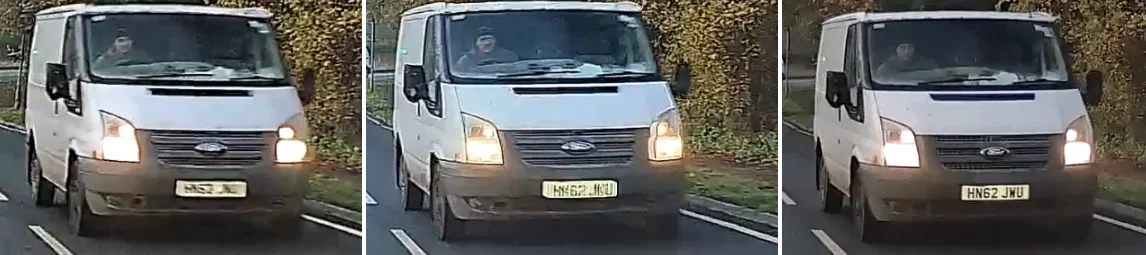

Comparing Normal and HDR+IPC:
- HDR+IPC is better for plate capture if the headlights catch the number plate
- Normal has a shorter exposure time and is my preferred option for overall image detail
Comparing the S1 4K to the Viofo A329S
- The S1 has significantly more blur than the Viofo A329S
S1 4K Normal // S1 4K HDR+IPC // Viofo A329S

Excellent - thank you, it's evident the image processing is working hard to resolve the registration plates.

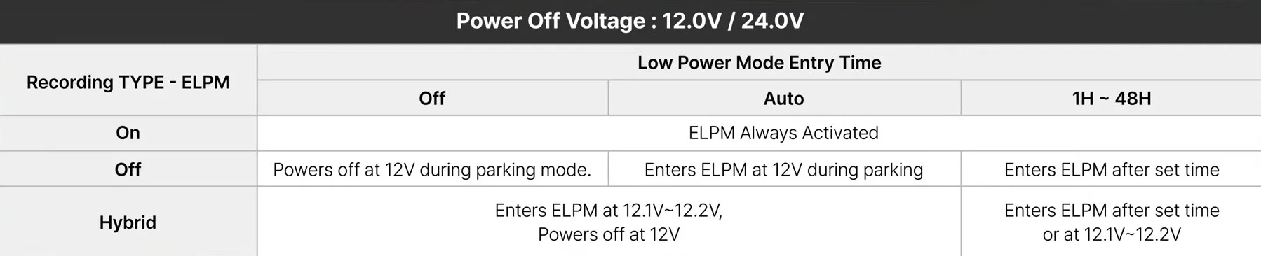

Improved ELPM functionality.
: Added a new Hybrid Mode to ELPM.
The new Hybrid option for Extreme Low Power Mode (ELPM) is described in this video - the functionality on the S1-4K is identical to the S1-QHD which already has this function:
The example below shows the difference in parking mode operation between On, Off and Hybrid when the Power Off Voltage is set to 12.0V.
S1 4K - Hybrid Parking Mode Example

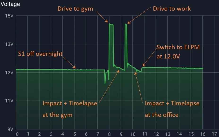

My personal setup is as follows:
Recording Type: ELPM - Hybrid, Impact+Timelapse
Power Off Voltage: 11.9V
Parking Mode Delay: 90s
Low Power Mode Entry Time: Off
This is how it works:
- When I park and switch off the engine, the S1 continues recording in Normal 30fps video for 90s, to avoid triggering event recordings by closing doors etc.
- After 90s the S1 enters Impact + Timelapse parking mode for continuous 1fps recording, with any impact events recorded as buffered 30fps video
- When the battery voltage remains below 12.1V for 1 minute, the S1 enters ELPM
- If the battery voltage later reaches 11.9V the S1 will turn off
This graph from my car's battery voltage monitor shows an example of hybrid parking recording in operation. I have short duration timelapse recording for 1-2 hours after parking the car, followed by continuous protection in extreme low power mode for the rest of the day.
