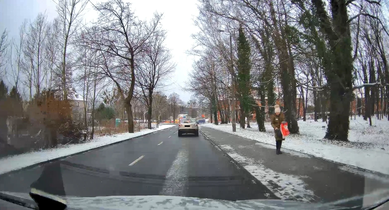

hi!
I'm used A119s with official firmware 4.0, 19020x1080, 60fps, normal bitrate
Please, take a look on pictures:
do you see these pixels ?

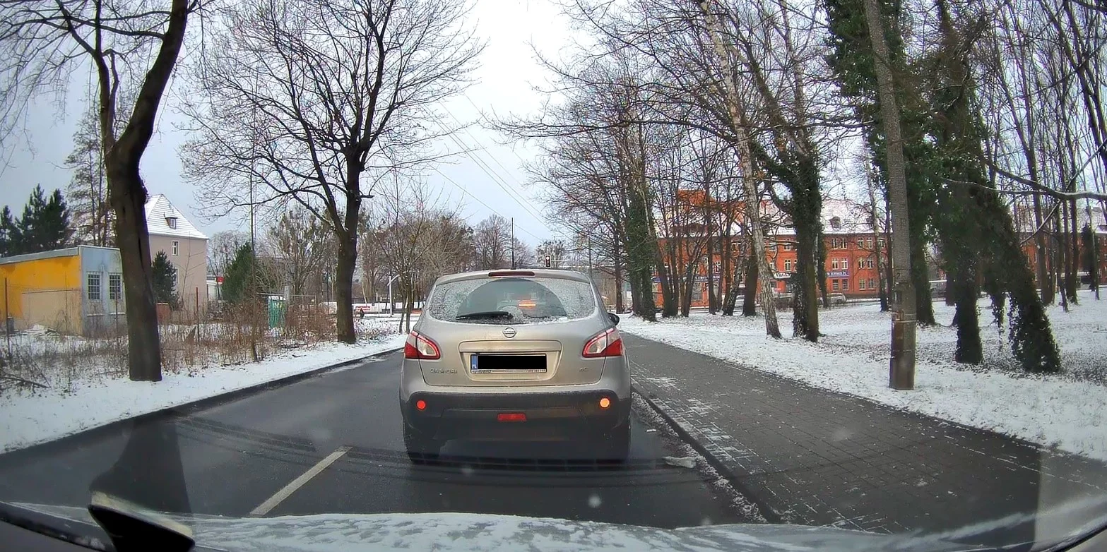

However... when car is stopped, picture is clear:
What I can to do it?
Change to higher bitrate or change to modified firmware - 6vj or 6vg?
Thanks, brothers&sisters :)
Jacek from Poland

This effect will appear on difficult scenes (grass, foliage, tree branches, etc.), caused by encoding Kodak and not high enough bitrate, firmware with high bitrate will fix this effect.
