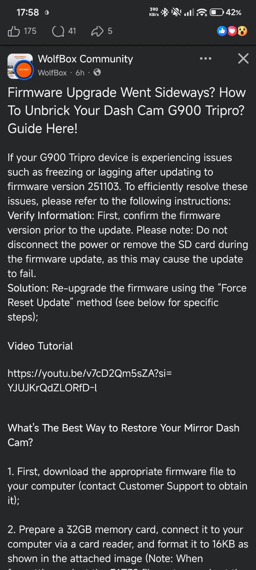

Hold on, are you referring to this post Wolfbox made today on Facebook? Because it's the first time I've seen them or any of their reps make reference to using the reset switch to unbrick units.
Happy to be proven wrong, but the timing seems a little suss.
