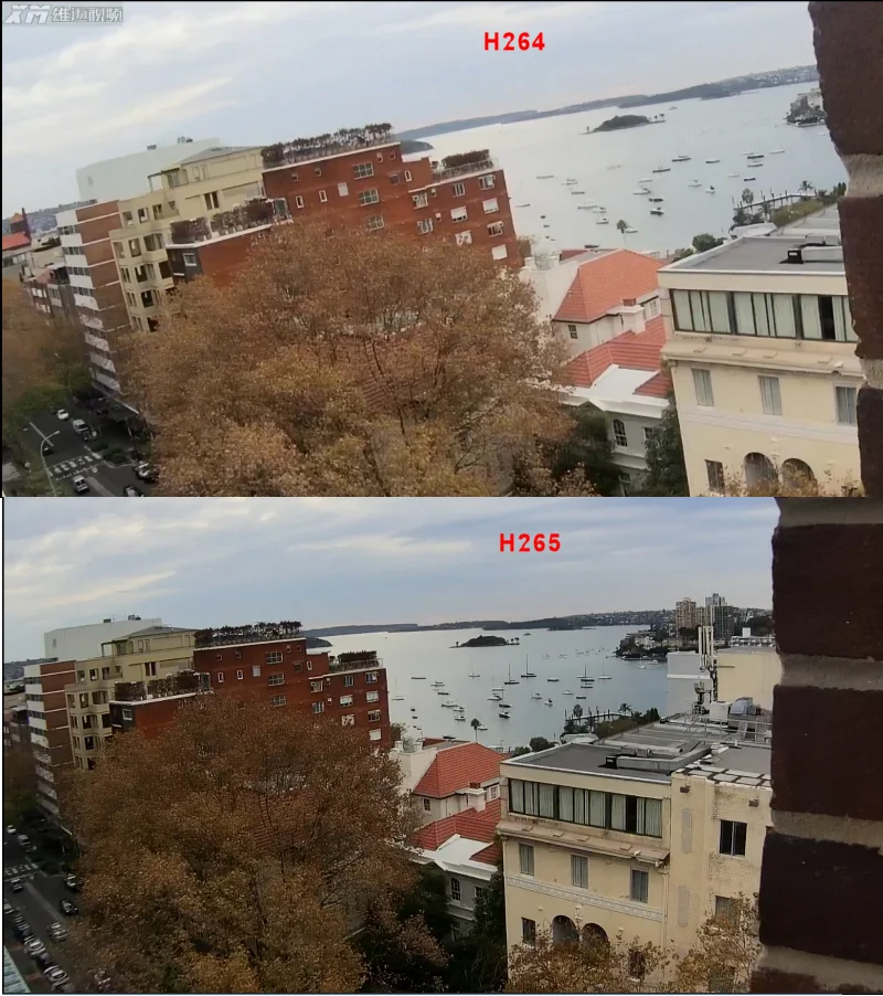

The camera supports H264 (Default) and H265 video compression. H265 reduced video file size by 40% but there is a distinct reduction in image brightness when H265 is used as the images below show - the H265 image is darker.

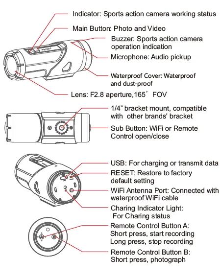

Controls
XM Warrior Instruction Video
Note: While in theory you could connect a Waterproof WiFi cable to the back of the camera you can only do so if the cap is removed and thus the camera will no longer be water-tight.
No external microphone support
