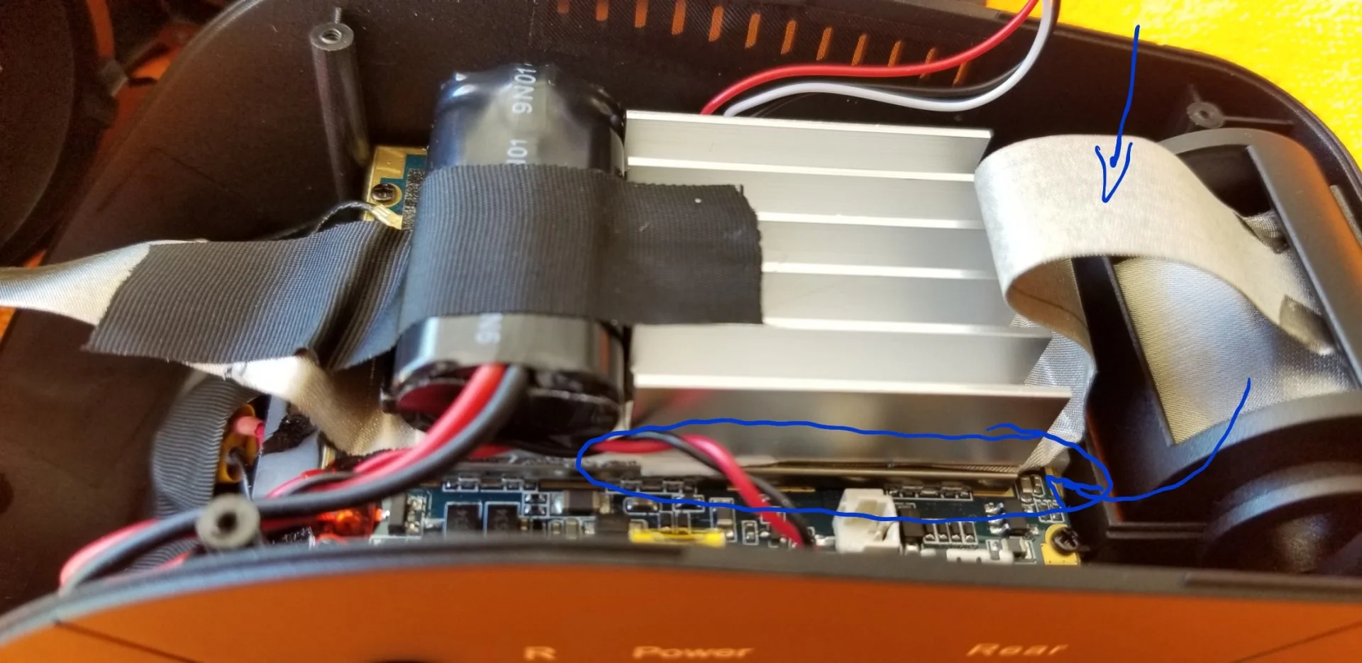

I suppose this tape helps to add protection and rf shielding to the ribbons connecting to the front and interior cameras, but why is it sandwiched between the CPU and the heatsink block? does it have good or better heat conductivity than heatsink compound alone? I have never seen something similar in the past. Doesn't mean that is wrong but I'm compelled to learn more about it, the pros and cons from someone who has direct knowledge on it's application.

not clear from your picture what's going on there
I took this picture about two weeks ago and didn't pay much attention until later when I was reviewing those pictures but certainly sparked a question. I will take a closer more detailed picture soon.

I suppose this tape helps to add protection and rf shielding to the ribbons connecting to the front and interior cameras, but why is it sandwiched between the CPU and the heatsink block? does it have good or better heat conductivity than heatsink compound alone? I have never seen something similar in the past. Doesn't mean that is wrong but I'm compelled to learn more about it, the pros and cons from someone who has direct knowledge on it's application.View attachment 52426
Excuse my ignorance but the item with the red and black wire, is that the supercapacitor? I know this camera doesn't have a battery, so I presume that would be the capacitor? That looks like a data cable ribbon???? Correct me if I am wrong there. And why on god's green earth its mounted under the CPU seems mind boggling? Couldn't that alone be cause the cameras to overheat? I mean it's absorbing the heat generated off the CPU.
