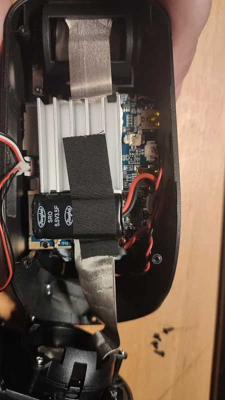

The heat sink in the T3 are actually pretty large,,,,,,, yes i peeked as my GPS issue had me looking for a loose plug inside.
Curious. Is the heatsink glued to the processor or can it be detached? I'm wondering if a nice coating of good thermal paste might solve the overheating problem.

I am sure it is put on either with a dual sided thermal pad, or thermal glue in paste form.
Either way this make it probably a no go if you want to take it apart.
Even regular thermal pads can get problematic, actually in some weeks i will be taking the original cooler of my 5800 XT GFX card to put a full cover H2O cooler on it, i am fearing how well it stick together now after over a year of use.

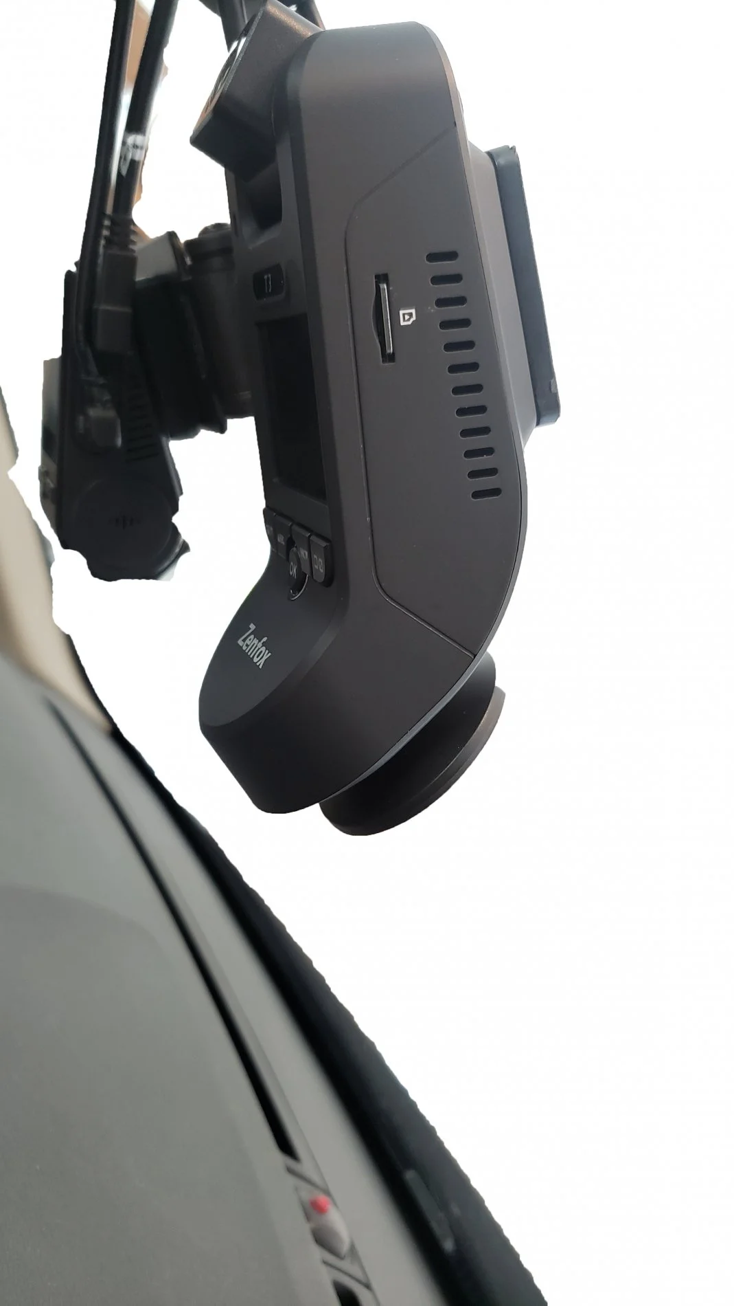

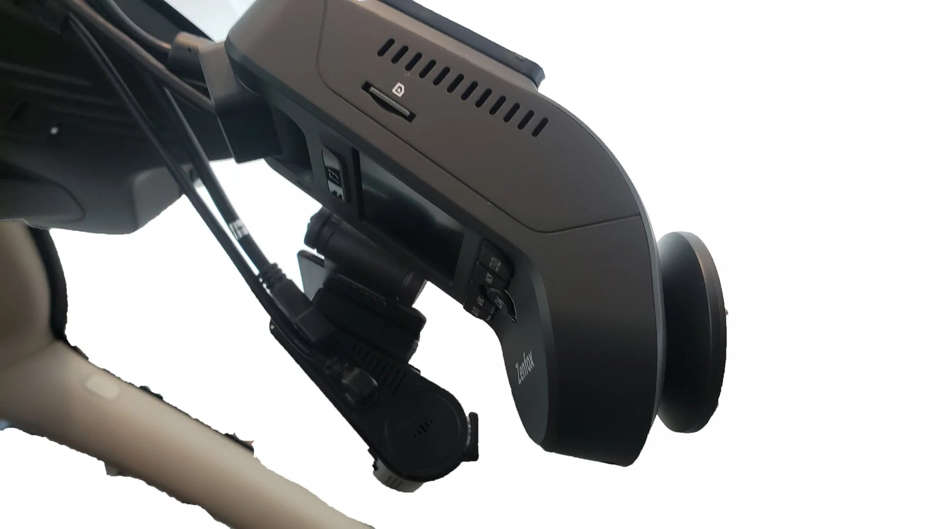

Not really when everyone else is experiencing the issue when it gets warm outside. The vents aren't blocked at all as the T3 only has vents on the side. Seems to be inadequate and possible design flaw leading to overheating. Also, the camera isn't flat against the windshield either. Look on page 47. Also here are two images of the camera. Either way, none of us have expectations that exceed what the camera advertises. It overheats during normal recording and parking mode.
My point was that your windshield appears to be fairly flat at the top, means the bottom vent is closer to the level of the top vent, which will reduce the airflow due to convection compared to my car.
If you really do only have a vent on the side, that would explain why yours has more problems than mine!
Took camera off mount and looked, it does have a bottom vent. Didn't see it due to tint. Also checked second camera, has vents in same place. Camera is not sitting against windshield and bottom vents are not touching windshield.
So Zero chance that's an issue.
