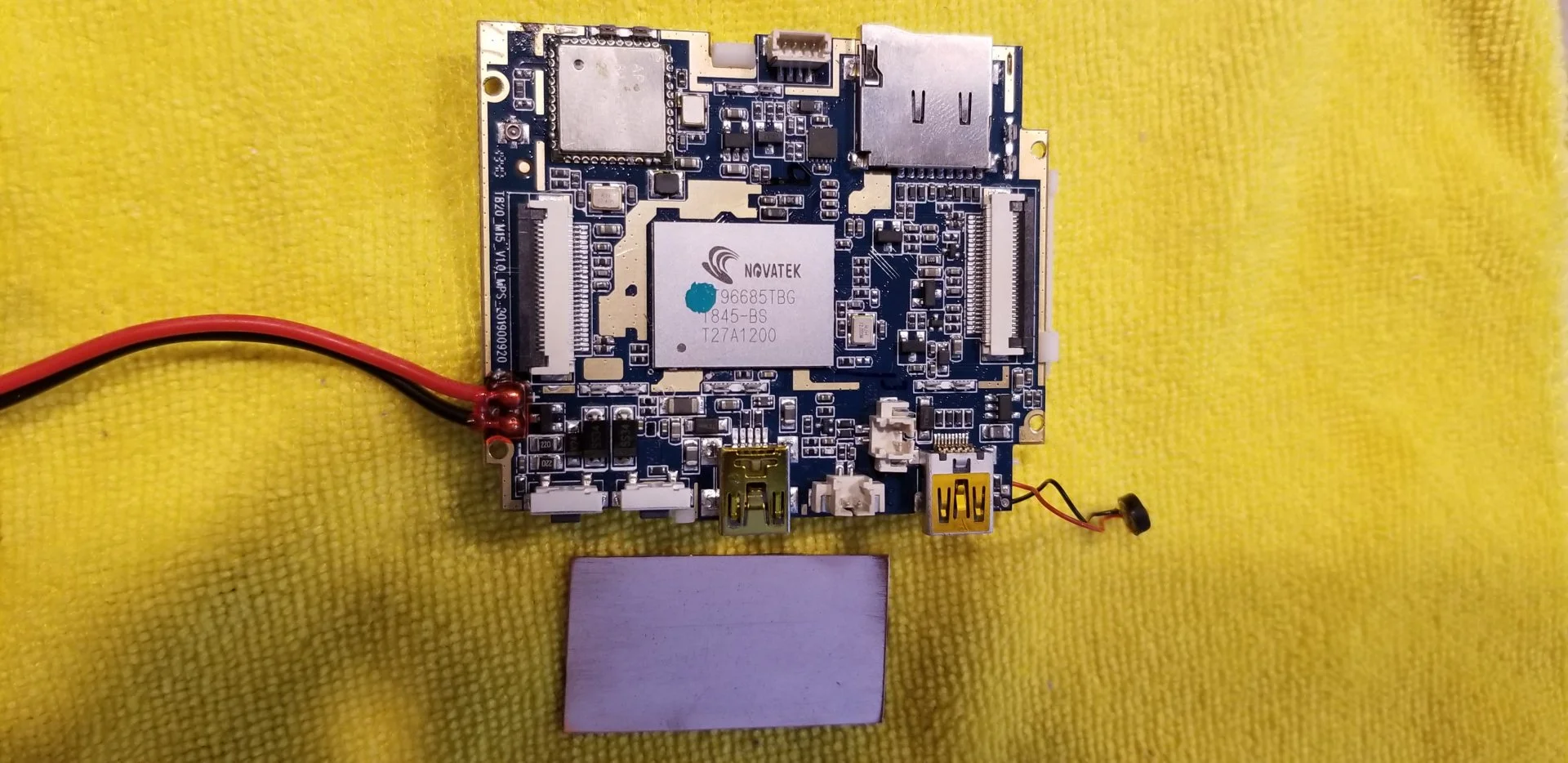

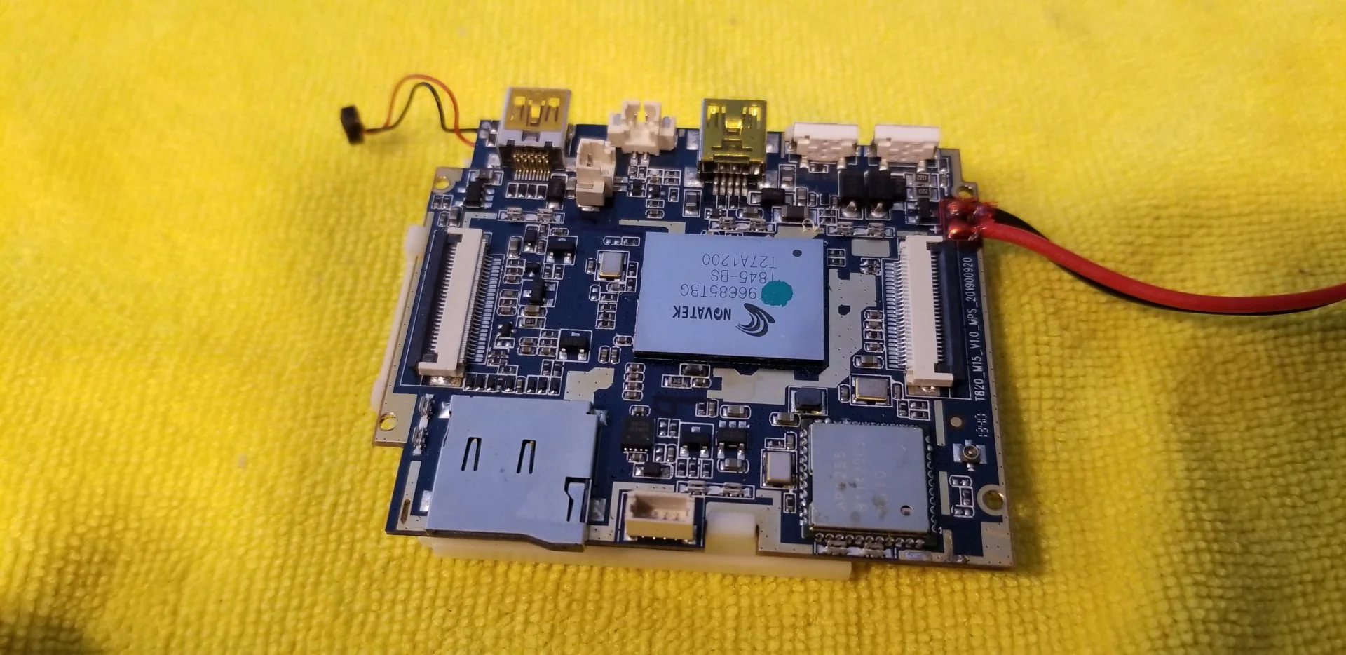

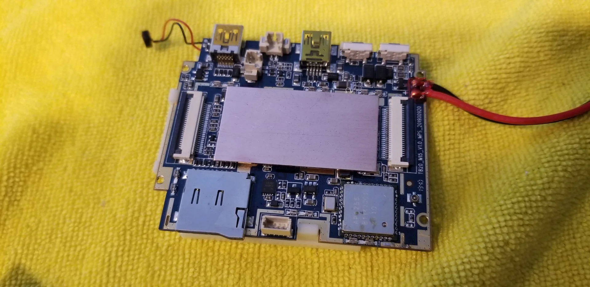

This is part of my setup. Will see what happens after assembling...20200707_172415.jpg20200707_172354.jpg20200707_172623.jpg
The copper spacer is .8mm x20 x36. I had to cut with a dremel tool and reduce the thickness by sanding it down.

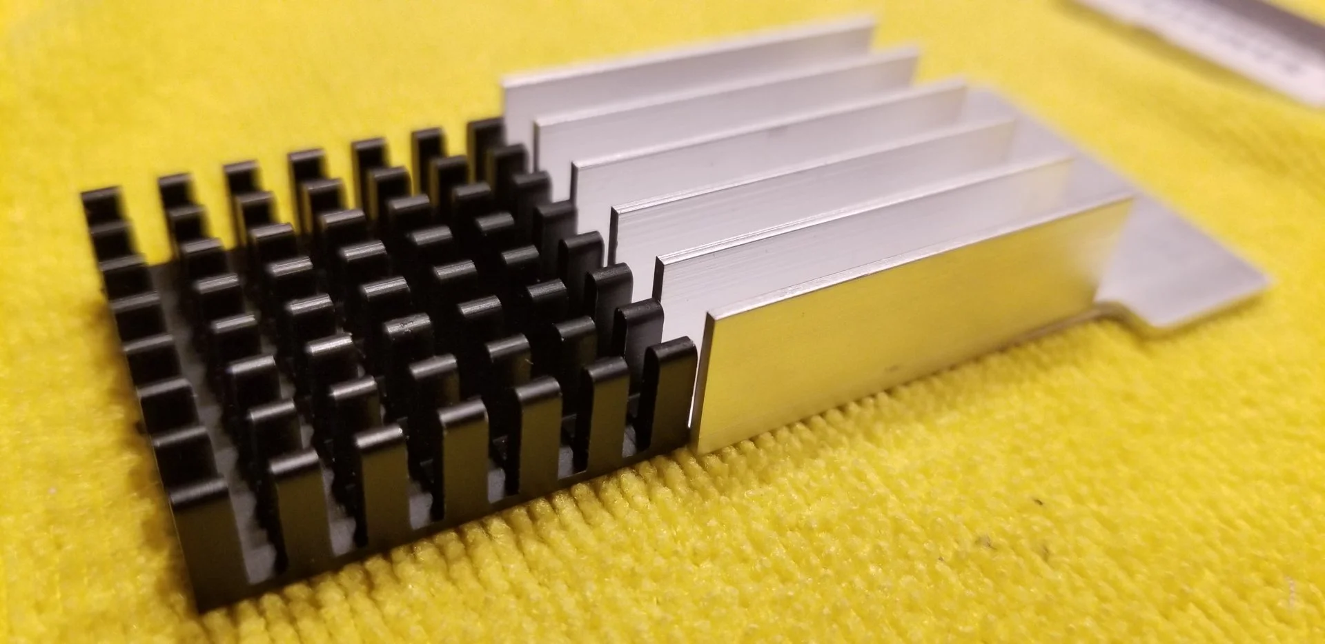

Do you think this one (black one) could do better even though it is smaller in size? I removed this one from a bad tv main board a while back.20200707_202906.jpg20200707_202958.jpg

Black radiates heat better, if you are not having a fan then yes, go for the black one.

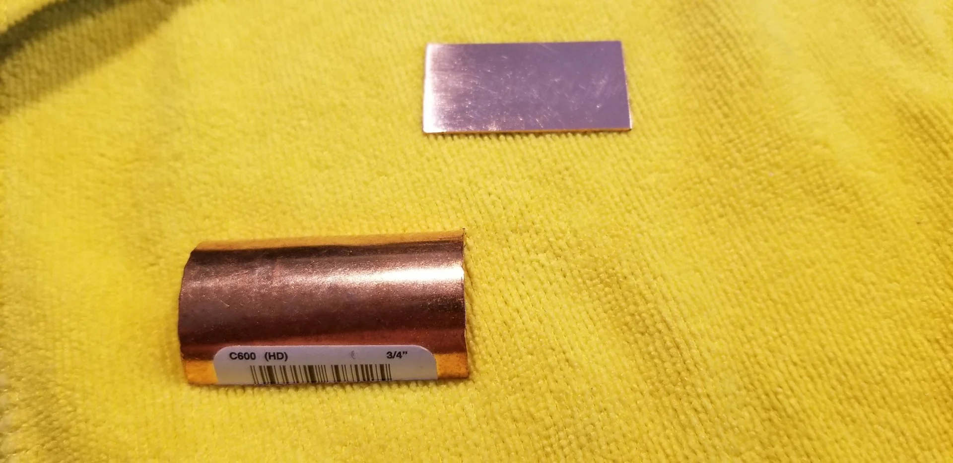

You provably don't want to choose this path, but I used a 3/4 piece of pipe and cut it in half, then flattened it as straight as I could. It took a lot of had sanding to remove surface unevenness and polished at the end. That is the only way I could get what I wanted. 20200707_172802.jpg

In my case, I could have stopped at .9 which is just a hair and could have been perfect.
