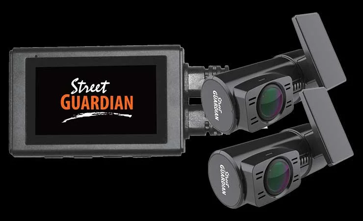

No still very few systems with a remote main unit, i tested two, the K2S and the SG9663DR, the K2S is pretty old now, i think like 3 years ago it came out, and it have insane small camera units, much smaller than the ones for the SG9663DR and the mini wedge shaped rear camera ones we see on many other brands / models.
I am a big fan of the remote main unit as that way you can make it large, and so accommodate really good cooling solution so you can run higher bitrates, and you can probably get the camera to do parking guard longer with the car parked in the mid day sun in summer.
And you could put in a SSD or M2 drive for storage instead of the silly little SD cards.
Exactly! As you stated:
- a huge benefit in cooling with the camera not directly exposed to sunlight.
- remote camera units can be tiny
- more processing power for additional cam units
- if someone breaks into the car and steals the cameras from the windshield, they would not get the main unit unless they knew exactly what/where to look for (and not get the data off of it)
If I ever designed a dashcam, it will be this style / form factor.
Both models i mentioned have pretty small main units, and i do not understand that as it dont take advantage of these possible upgrade options, i would not mind if it was cigar box sized, hell i might even take a camera system with half a shoe box size.
The K2S cameras are so small you will not be able to put CPL on them, at least not a CPL like seen today.
A main body / unit like that, it would also allow for connections of camera units specially designed for use on the side of the car, either on fixed glass filming out, or on top of door plastic filming out, or even on the back of front fender filming down the side of the car.
And then you could of course have regular front & rear camera units that are not as demanding as a side camera would be.
I have also argued for some kind of BUS on such a unit, so you could daisy chain other things like a box more for more cameras or maybe a alarm module ASO
But say you got the #1 model with two 1080 p cameras or maybe two 1440p cameras, either way, some time pass by and now there is a new model with two 4K cameras, so you could get that make that your new F&R cameras and move your older cameras to side use / maybe get special side camera modules, and BOOM you have 360 coverage.

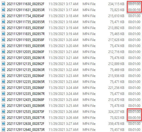

  2. I found a fairly serious problem regarding lost video footage during file transitions.
    1. I found numerous examples of the rear video file being listed as 59 seconds in length instead of 1 minute, but when you look at that set of front/rear video files and the next video files in sequence, you'll see that 4 to 5 seconds of video has been lost in both the front and rear video files.

2. I went back and checked several different days of driving and could find no example of any missing footage between clips. I have had two samples of this camera and neither showed this issue.
This is the most recent example I submitted to Zenfox support where I have two pairs (front/rear) file transitions where the rear file has a time length of 00:00:59 instead of 00:01:00. When I look at the front and rear video files in that pair of front/rear files and the next files in sequence:
First example:
20211129111630_002852F.MP4 => last timestamp in video 11:17:29
20211129111631_002853R.MP4 => last timestamp in video 11:17:29
20211129111734_002854F.MP4 => first timestamp in video 11:17:33
20211129111735_002855R.MP4 => first timestamp in video 11:17:34
The timestamps in the videos show that 4 to 5 seconds were lost. The filenames also are not in 1 minute increments like the other files with no time gaps.
Second example:
20211129112535_002870F.MP4 => last timestamp in video 11:26:33
20211129112535_002871R.MP4 => last timestamp in video 11:26:33
20211129112638_002872F.MP4 => first timestamp in video 11:26:38
20211129112640_002873R.MP4 => first timestamp in video 11:26:38
The timestamps in the videos show that 5 seconds were lost. The filenames also are not in 1 minute increments like the other files with no time gaps.
It's not just the timestamps that are messed up, if you review the video itself you'll see a noticeable gap in the video.
FWIW I did see somewhere that the file formats (or was it FPS?) are different for front and rear; that person said playback was choppy too. I experienced a similar problem with the W4K where the front cam was h265 and the rear cam was h264. It seems for good results file types and FPS need to be the same for both cams.
