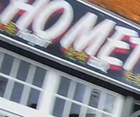

Is it possible to increase the ISO setting?
Looking at the video from yesterday I have a lot of motion blur but the video looks like we are using ISO50 when we could be using ISO400 and have 1/8th of the motion blur but still a OK quality image. There is no need to use ISO50 on a dashcam unless the image is so bright that you have reached maximum shutter speed, I think with this sensor ISO400 is still almost perfect and ISO800 is probably still OK quality. I don't know what ISO it was using, but I would expect less motion blur in those conditions from a fast sensor like this, for reading number plates we need minimum motion blur, not minimum ISO...
