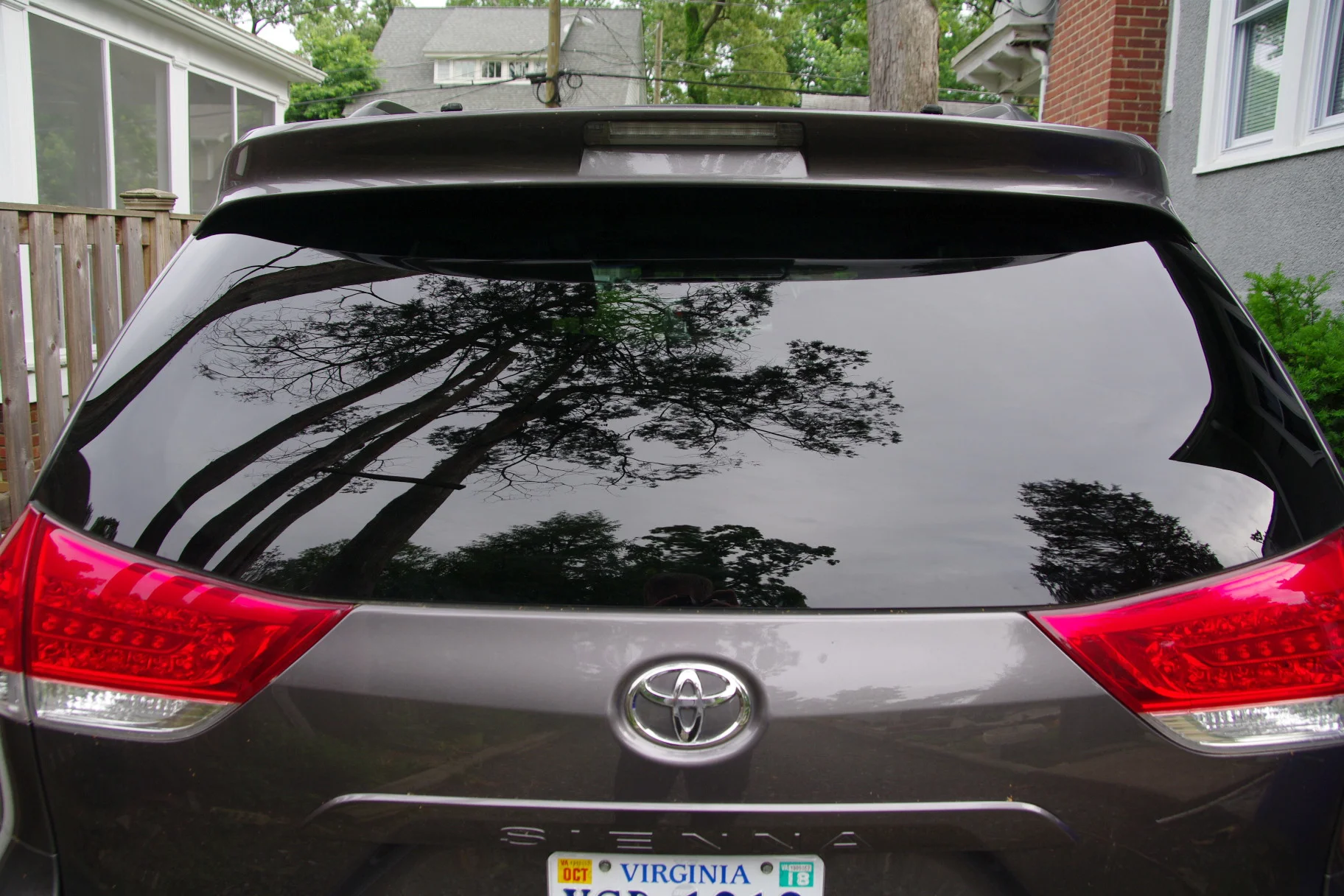

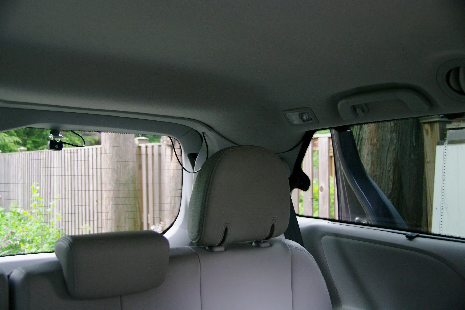

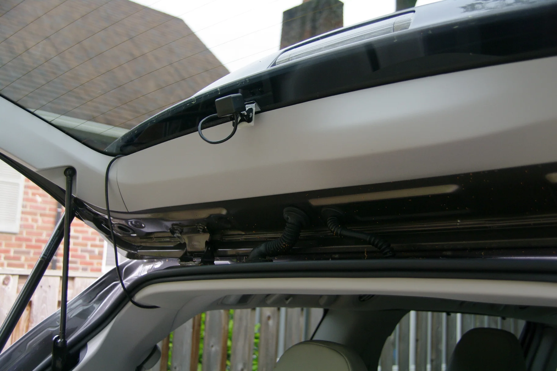

Here is from the back camera on a Toyota mini van. Very dark tint.

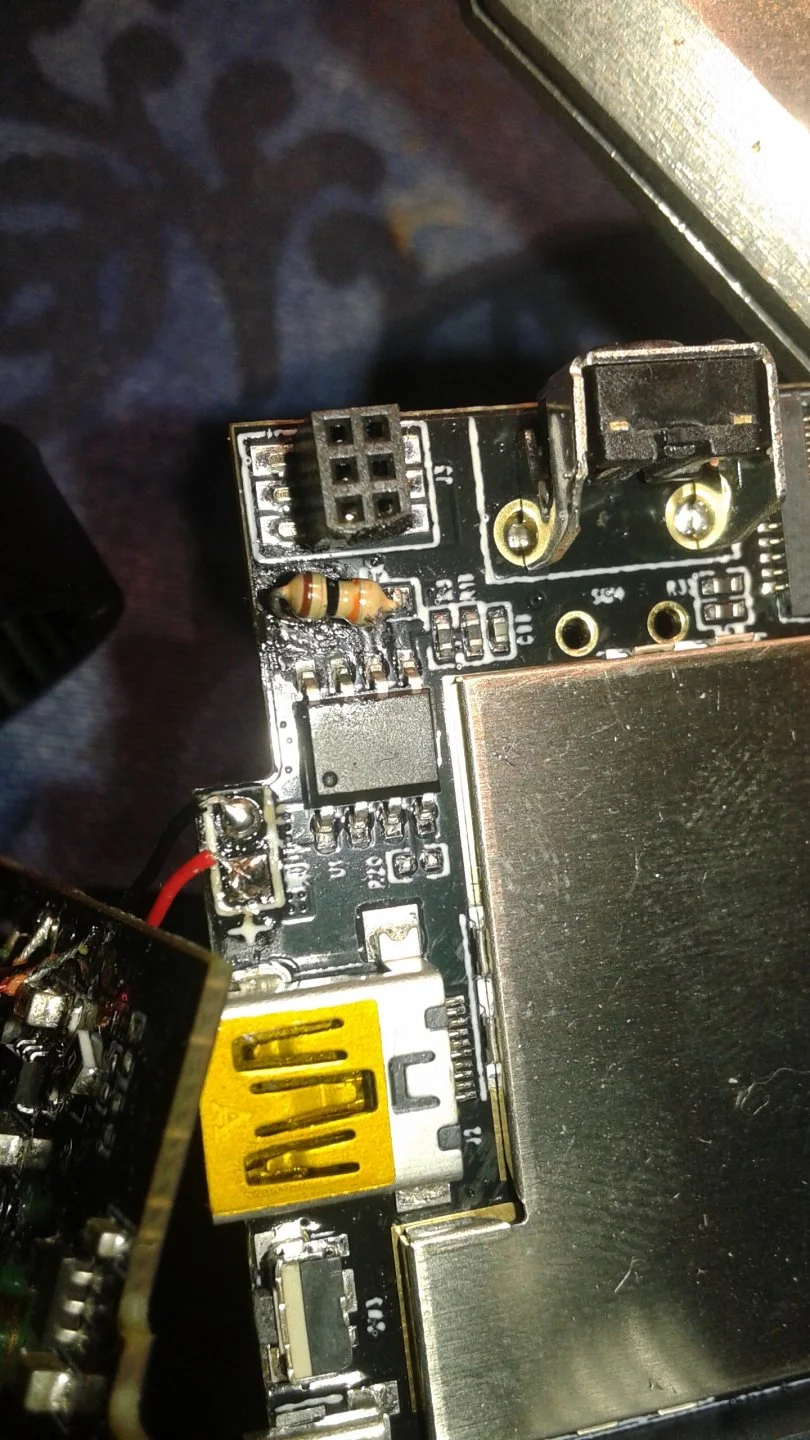

I finally received the new parts today (and didnt have to pay anything this time, no idea what happened :p)
Swapping the resistor worked better than expected, but I should have removed the remaining flux afterwards. (Yes I know theres way too much solder on the resistor but it was hard enough since it was really really small) We'll see if this helps with tempature issues

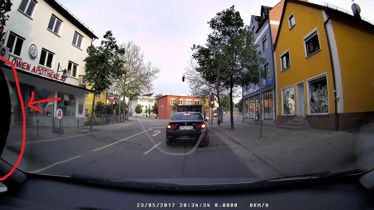

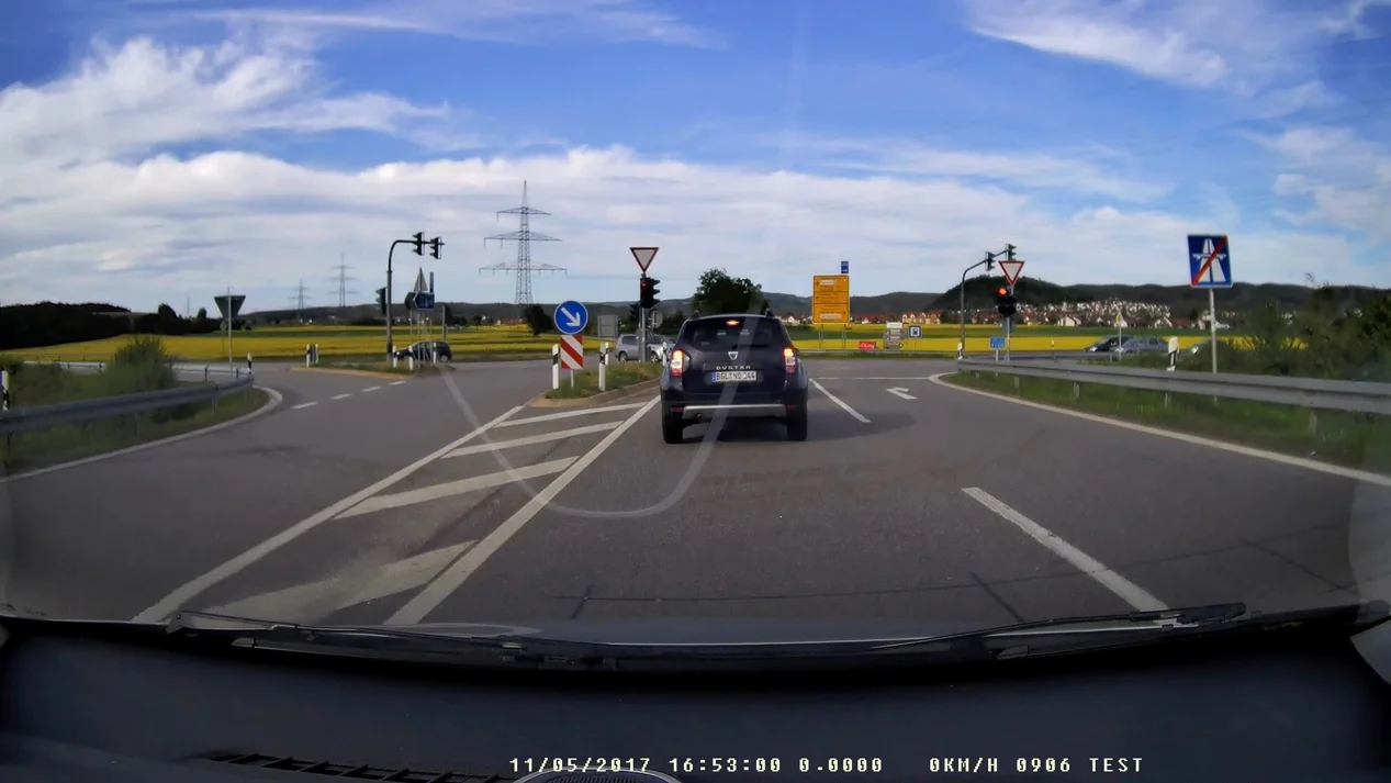

The new lens has a wider angel in my opinion, before exchanging the lens the camera couldnt see the SGGC next to it, but now it does. Seems like I have to remount it (maybe this also fixes my gps issues)
Before:
After (new lens):
That look really good.(y)
That resistor is small like a flee. Yes like a flee.:watching:
I got a Weller soldering iron with a needle tip, very thin soldering thread and I couldn't do it. :oldman:
So my temperature is 0c, but its better that it shut down all the time.:smuggrin:
Not as beautiful as yours replacement, but most important, it works.
I made a fine adjustment to the lens and took extra patience with the cable.
So I'm back in businesses for next firmware update.
