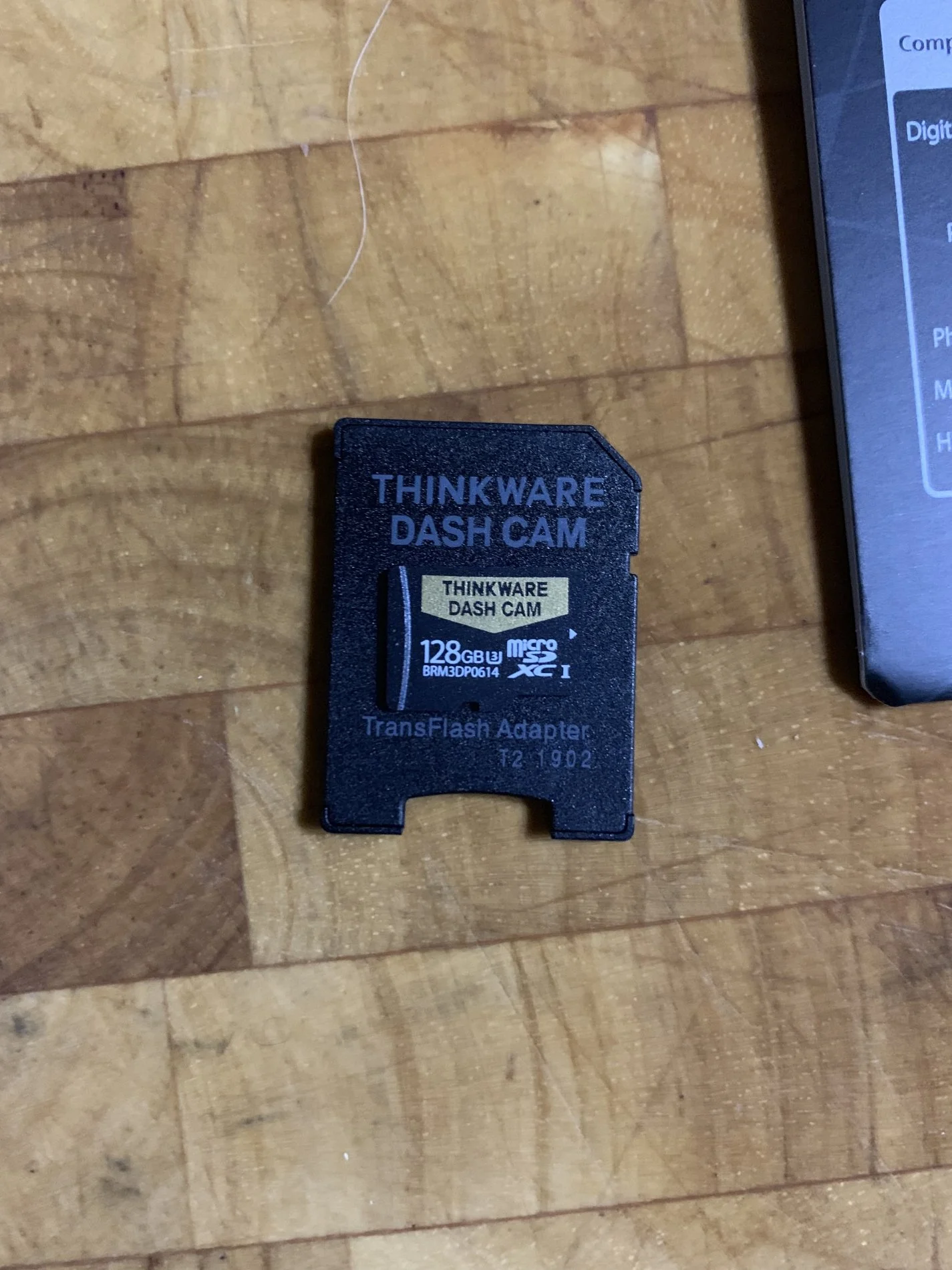

In case this helps anyone, this is the expensive real deal. Maybe there's something in the specs that may be relevant.
IMG_0110.jpg IMG_0111.jpg .IMG_0112.jpg IMG_0113.jpg .IMG_0115.jpg .IMG_0116.jpg
And if the type of NAND memory type on these cards is important (Thinkware 128GB card is MLC), then this is what Samsung say about their cards:
"Please be informed that Samsung uses two types of storage memory for its SD cards.
For the EVO and EVO (+)/Plus models, it uses the TLC storage memory, while for the PRO and PRO (+)/Plus Models, it uses MLC storage memory.
The MB-MP..., MB-ME... and MB-MC... models use the TLC Storage memory while the MB-MF..., MB-MD... and MB-MJ... models use the MLC storage memory.
