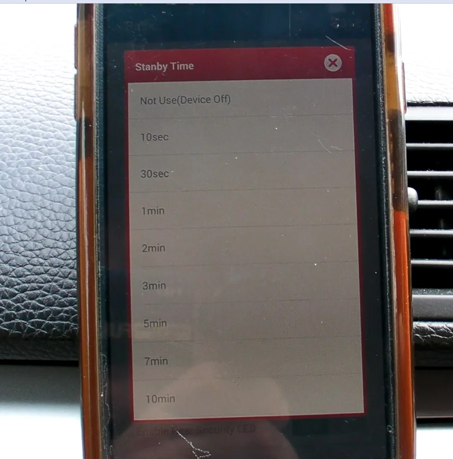

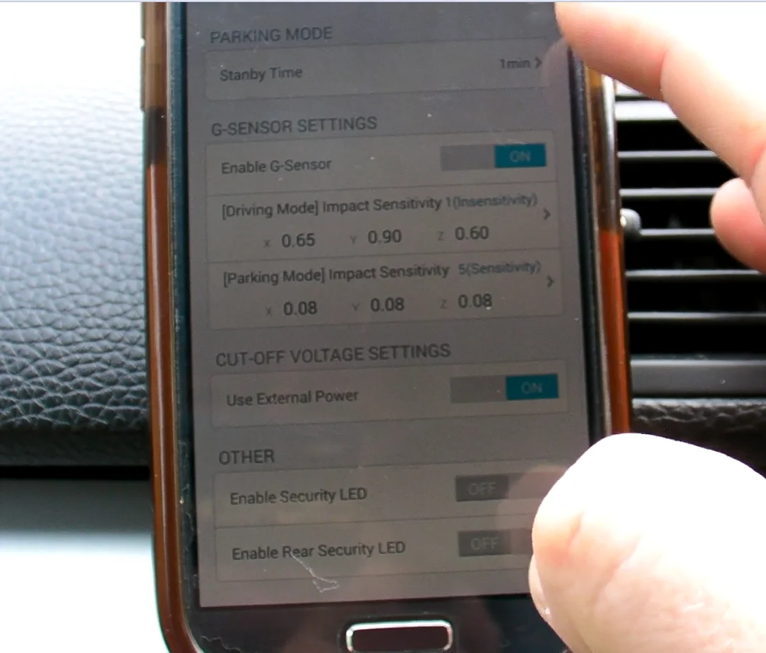

Parking mode is triggered by G-sensor. It enters into parking mode from 10sec to 10min ( time is selectable from menu )

I set it to 1 minute. I opened and closed the door within the one minute and parking mode still started exactly one minute after the engine shut down. Perhaps, I should try again by tapping the cam housing in 40 45 seconds after the engine shuts down. I have driving mode g sensor set to 1 and closing the door may not be enough to trigger it.

@"triggered by g-sensor" I meant that G-sensor all 3 values ( X, Y, Z ) affects time when dashcam is going into parking mode. If all 3 values are not changing within set value of time, then it goes into parking mode.

After trying for a few days, I can confirm g-sensor has nothing to do with entering and existing parking mode if the camera is hard wired.
What is your parking mode settings for stand-by time ?
Yes. Set to 10 sec now. Parking mode starts 10 sec after I shut down the engine. Driving mode starts as soon as the engine starts.
