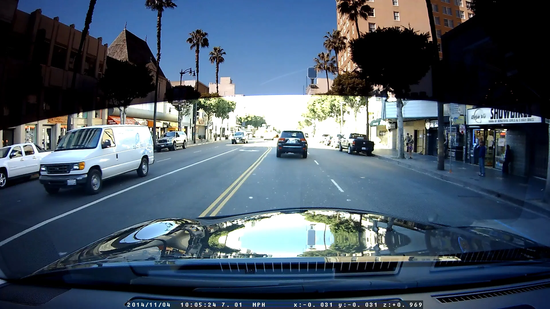

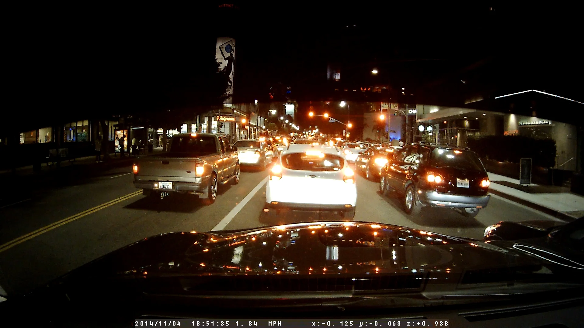

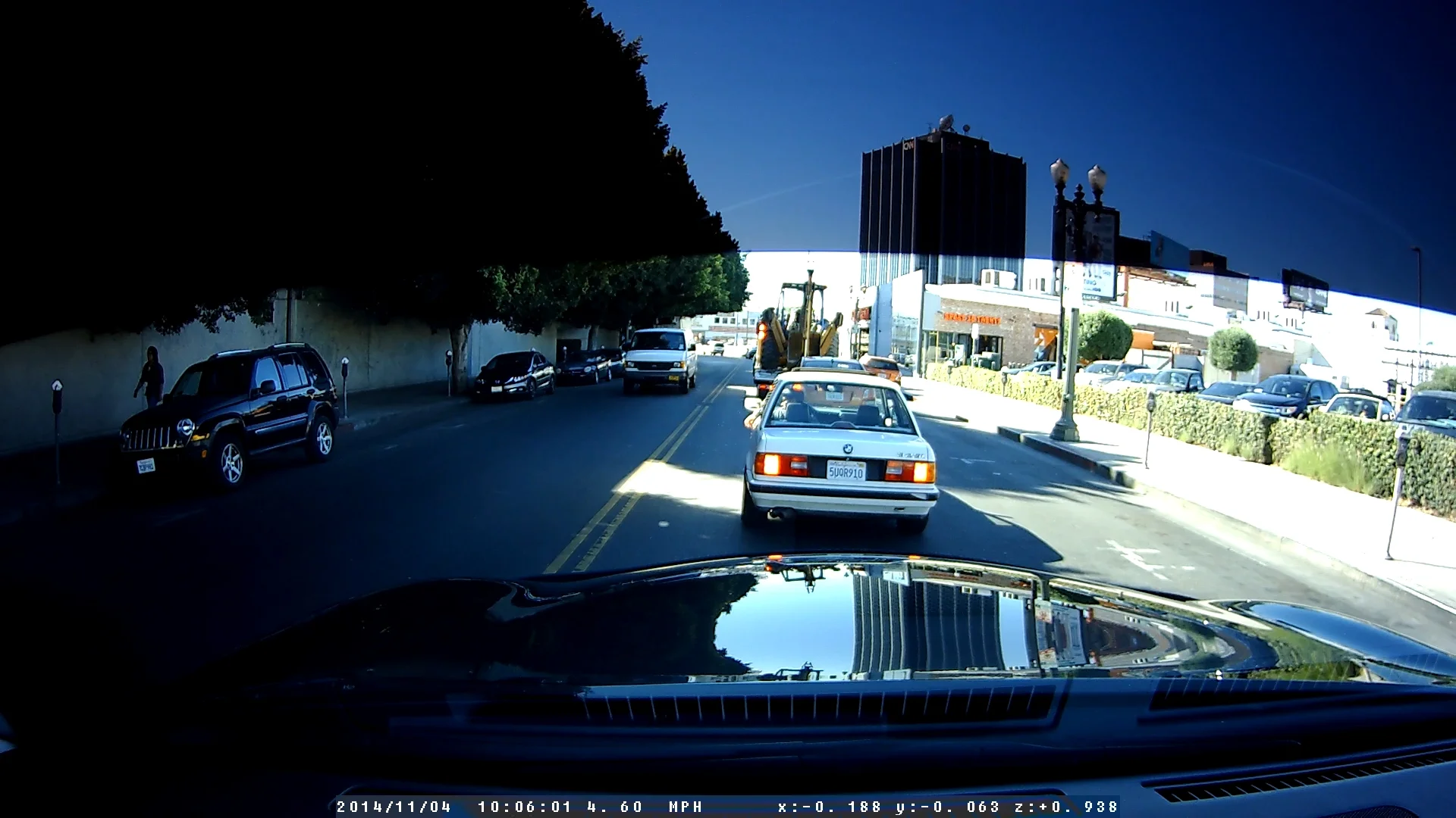

tilted the cam up more to get a bit less hood/dash and still have the blown out highlights...
I don't know how close you have to get to get the dimming to kick in as so far I've not managed to get that to kick in.
I had mine pointing even higher than that while testing - I'll get you some sample pictures up.
