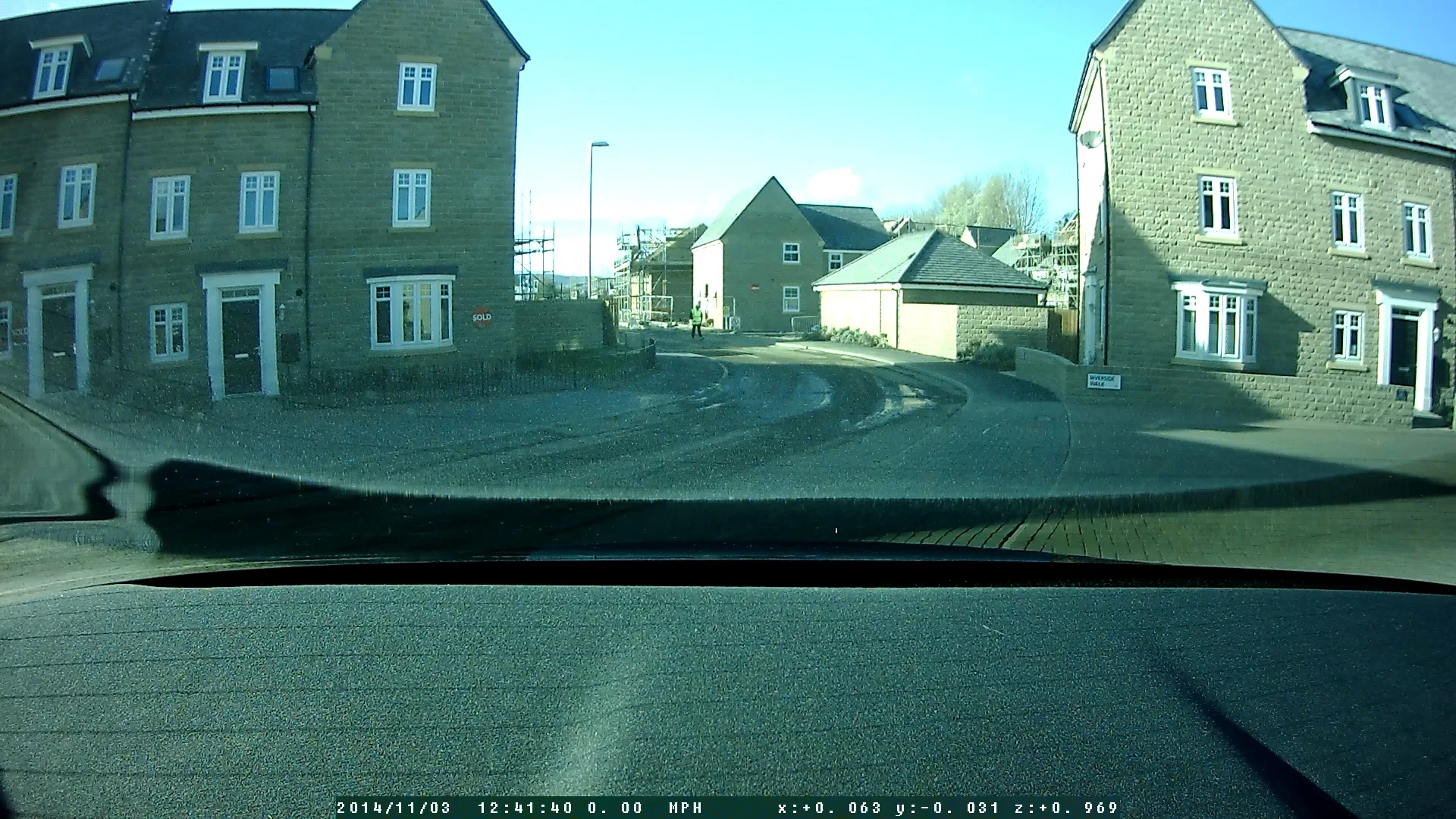

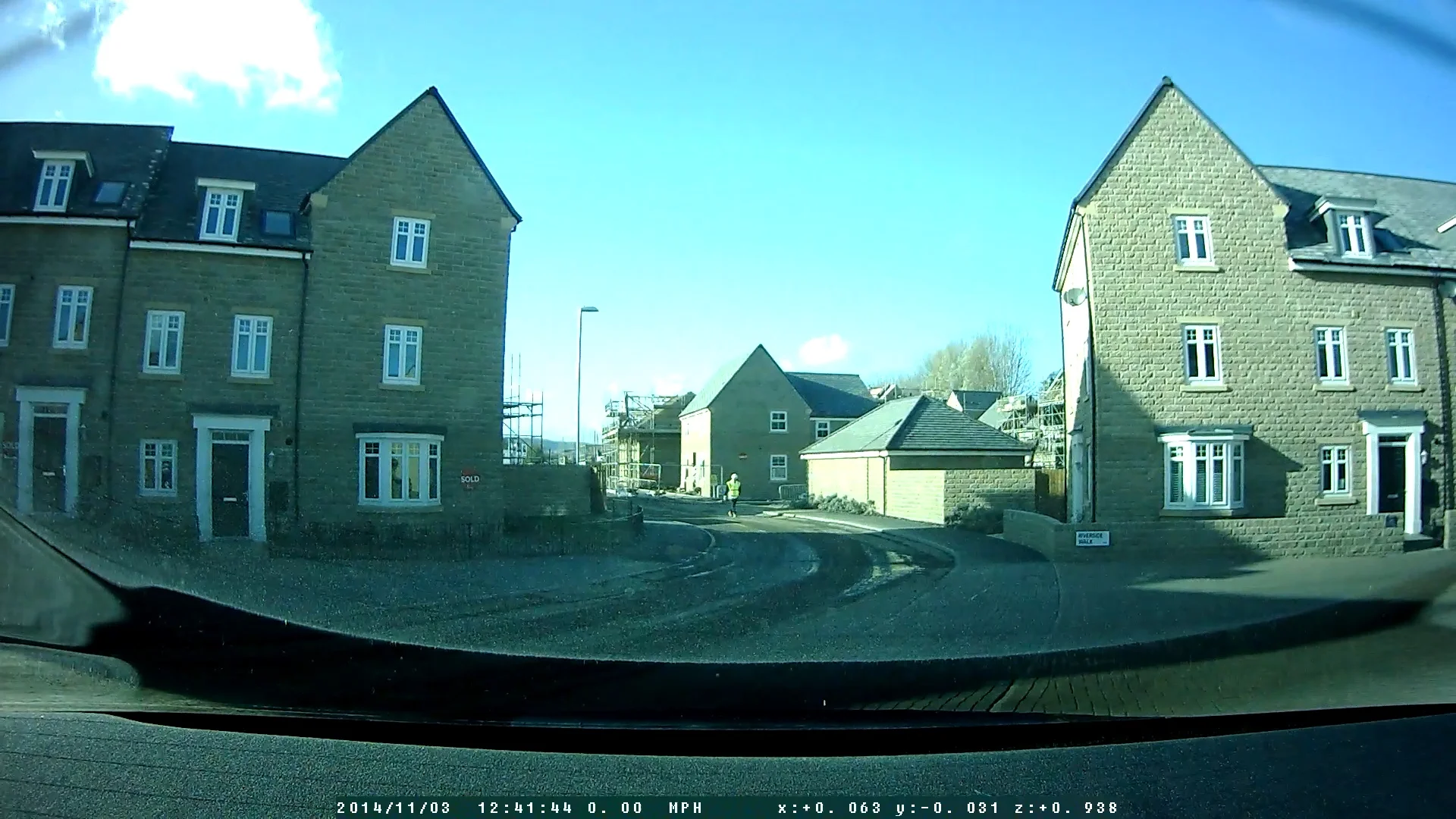

What's the recommendation with Panorama devices for aiming the cameras? I always tend to go for 60/40 or thereabouts with less sky than horizon but the X2 seems to run better in my car the other way around in the current beta firmwares.
Just to have a play I've angled both the front and rear cameras up and it's still not doing a bad job - a bit dark in some situations but numberplate capture is improved for me. If I did this with a lot of other cameras I'd be getting a lovely sky and wouldn't be able to see anything on the road - guess it's the dynamic range at play and better firmware coming into play here.
We had a nice day today so I got some footage and some is stunning - nearly took a hit though on a blind corner folks love whizzing around:
Here are three pics showing the difference on the rear camera with just the angle changed - you can see the third picture is the best in terms of not clipping brighter stuff straight to white in my car:
It just goes to show how much difference can be made from something as simple as the angle of the camera 🙂

Angle it up for now and it will help with the blowing out while you wait for new firmware 🙂
aiight,
in the morning i will angle up more. i tried this before but did not have much success, but that was older firmware...
