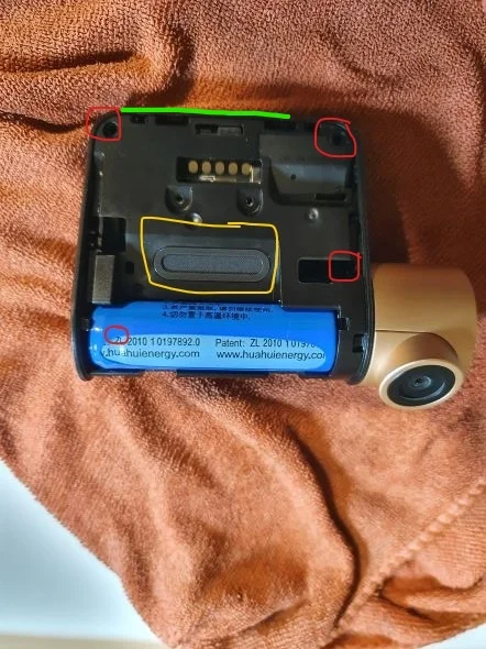

Step 1: Gently peel off the sticker at the back of the dash cam, and this will reveal 2 Philips Head screws. Remove the 2 screws and set aside.
Step 2: Gently pry off the cover along the line highlighted in green. Only minimal force is required and be very gently to ensure you don't break the plastic cover. The cover should then pop off.
Once cover is removed, you will need to remove the 4 Philips Head screws, circled in red. Note: 1 of the screws is actually below the battery, so wiggle out the battery (no need to disconnect) and unscrew the screw. Set all 4 screws aside.
The speaker module is behind the part circled in yellow.

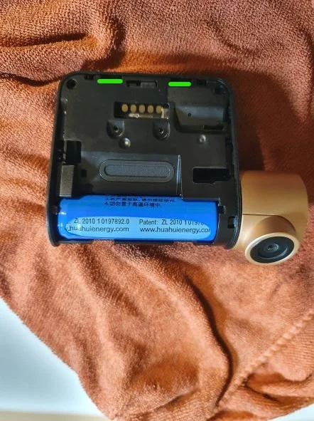

Step 3: Once screws have been removed and battery out of its housing (but still connected), dislodge the plastic housing (DO NOT remove the entire housing as cables are still connected) by gently prying through the slots underlined in green.
Step 3: Once housing cover is removed, use a flathead screwdriver and gently wiggle the speaker connector out of its housing, highlighted in red below. Voila! There will now be no more sound coming through the speakers, and best of all these steps are completely reversible. You may want to test the dash cam before reassembling the parts back together.
To reassemble the dash cam, simply follow these instructions backwards.
