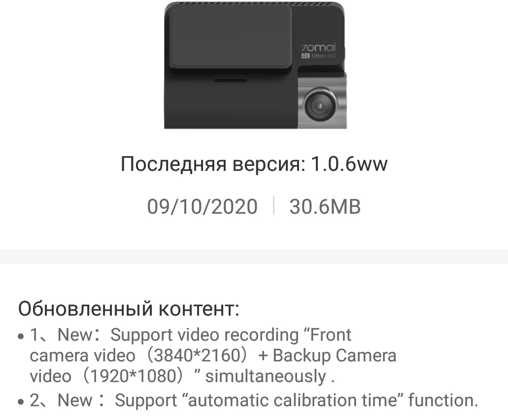

is 1.0.6ww of 2020.09.10 the latest firmware?
Still no 4k recording on front cam when rear cam is attached.
