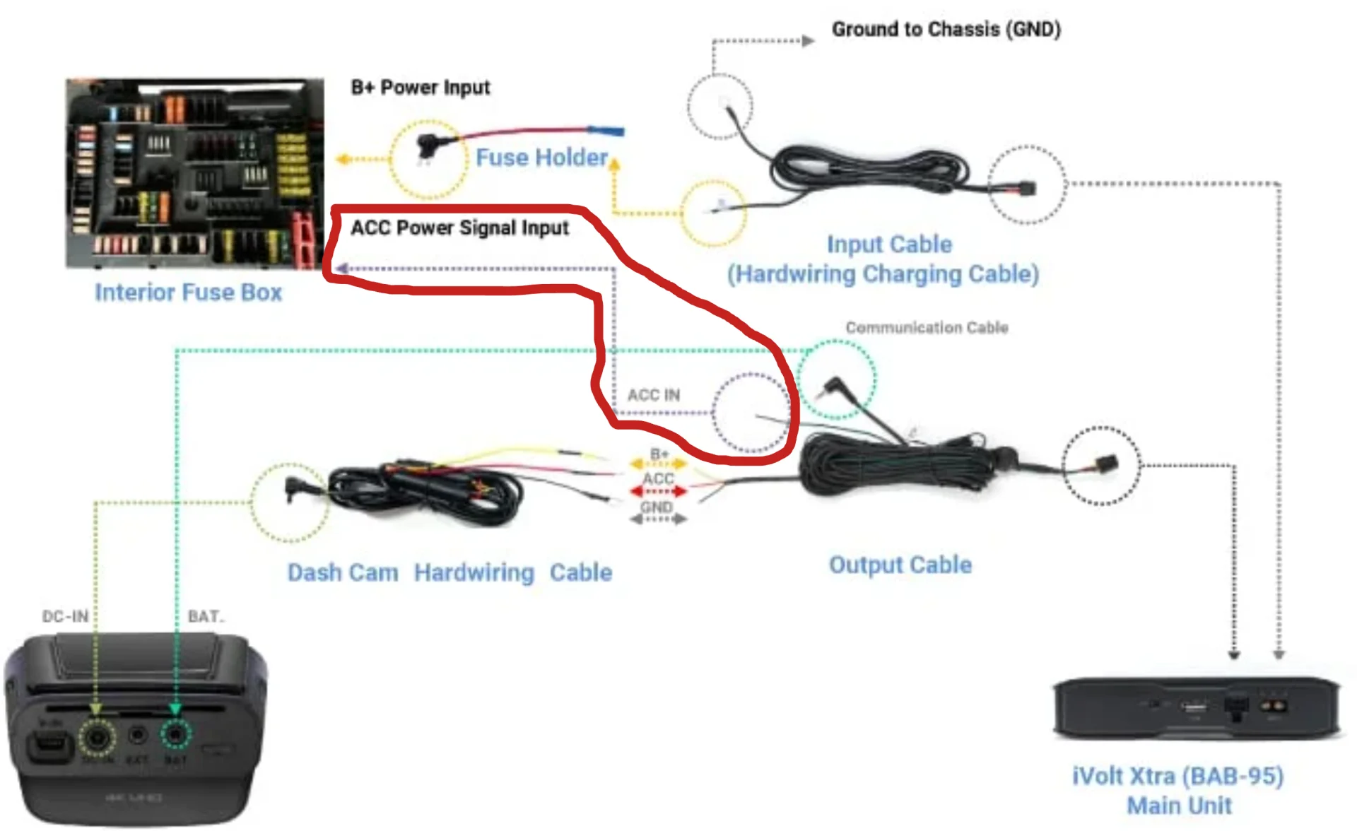

Why are there 3 pins for DC input unlike 2 pins for the Powercell 8?
The BBMC PowerCell 8, and BlackVue B-130X use a 2-Pin XT60 connector for power, and ground.
The power cable is connected to an ACC “switched” fuse.
When the switched fuse is energized current flows to the pack to begin charging.
The Thinkware BAB-95, and IROAD Power Pack Pro use a 3-Wire strategy.
The power cable is connected to constant battery voltage.
The 3rd ACC switched wire is connected to an ACC switched source.
Basically the Thinkware BAB-95, IROAD, and 70mai have a built-in relay inside the pack, and it only allows current flow when it gets “signal” from the 3rd wire even though the main power wire is connected to constant battery voltage.

Excellent summary. I figured the third pin was adding constant +12V with respect to the Powercell 8.
It would be interesting to understand the benefits of constant +12V that make it worthy of adding that extra external wire.
If it was just the delayed charging function, they could have done it with a simple counter.

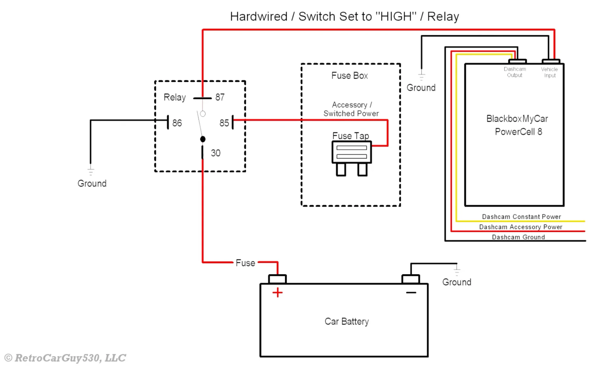

Minimum Two Benefits;
1.) Pulling 11-14 Amps through the fuse box either “piggybacking” on a circuit already being used for vehicle operations, or on a “vacant” circuit not being used is borderline dangerous because that amount of current may damage existing vehicle wiring, or start a fire.
That’s why @rcg530, and myself recommend installing an external relay for packs like the PowerCell 8, and B-130X.
See the chapter at 12:24 in tis video;
2.) Running the 11-14 Amp power wire directly to positive battery terminal, or dedicated junction will always be safer than “tapping” into the fuse box to pull high current loads.
Have you ever installed an aftermarket car audio amplifier for a sound system?
You would NEVER run power wire from an amplifier to the fuse box, ALWAYS directly to the positive battery terminal, or dedicated junction.

This diagram needs to be added to the PC8 and B-130X manuals as the preferred wiring method.
Honestly, it should have been an integral part of the battery.
