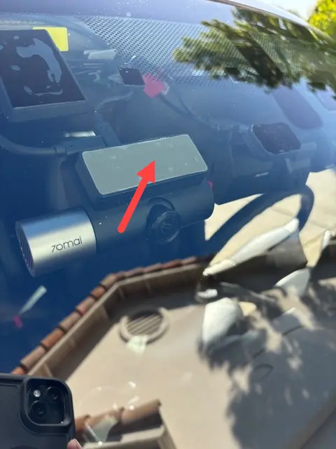

I received confirmation that 70mai is changing the double-sided adhesive pad color from the light grey to black.
The T800 dash cameras sent to reviewers still had the grey adhesive pads, but the production units will have the black adhesive pads. The black adhesive pads will start showing up in future batches of the X800/M800.
Hello @rcg530 and @Oliver_70mai, I thought that 70mai will now issue the black adhesive pads. I just received my T800 yesterday and I found that it is still has grey adhesive pads.
