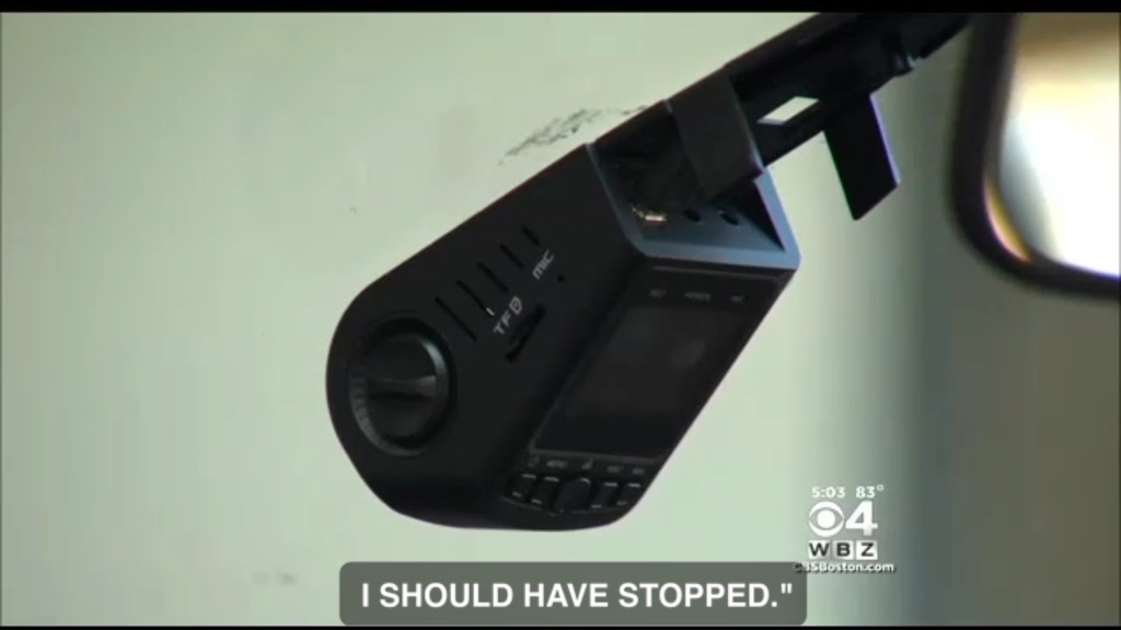

Not sure if this one has been up here yet but the A118 was on the news here from footage of a hit and run:
http://boston.cbslocal.com/2015/06/10/dash-cam-captures-hit-and-run-crash-on-route-2-in-lincoln/
I thought maybe it was the SG9665GC until I realised the image was a bit soft (Aptina tuned image)
the news sites often show stuff at lower res so hard to know really, guess he didn't like the full cable cover
Ah I already checked that and it didn't say Street Guardian on the time stamp banner ;)
Ah I didn't realize that - in that case it could be either :)
I've always said if we have our logo on screen we'd only do that if you have the ability to turn it off, appreciate some people might not appreciate it
of course if it were on and our brand ended up being shown on the news you might receive a free camera as a thank you so it's not all bad ;)
