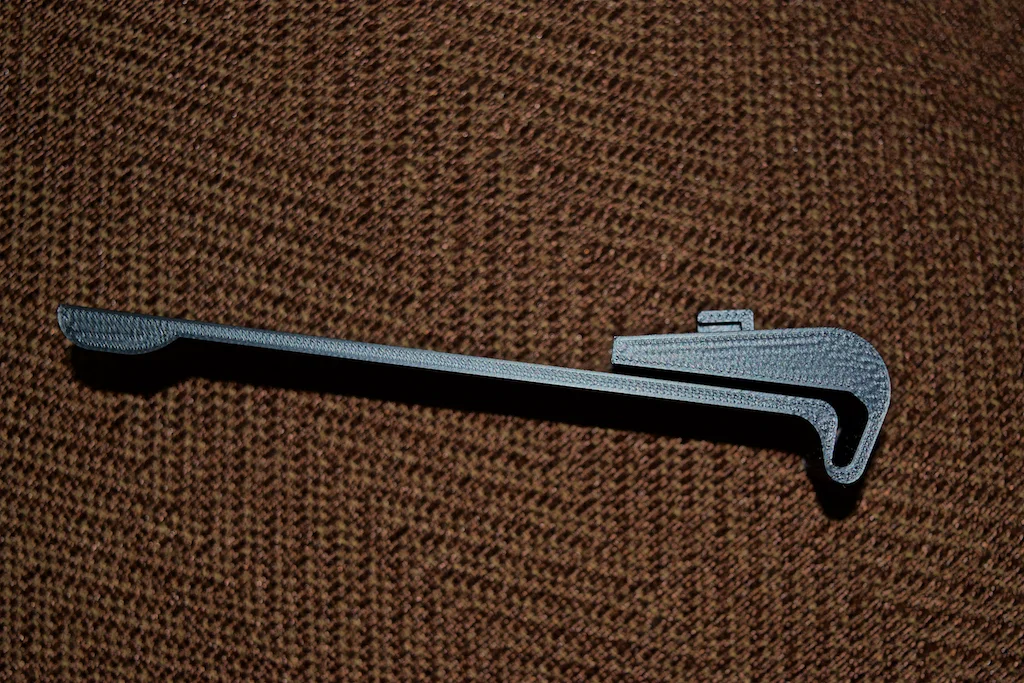

Mine's here but the space where the edge of the headliner slips into and rests, is unfortunately shorter by 3-4mm than needed. Forcing it a bit only alters the angle and doesn't give a snug fit.
Sounds like you'll need to customize / edit the file a bit and re-print it
STL editor. Hmm.. will give it a shot and see if I can do this myself. Thanks

I've been trying for quite some time to come up with a clean, removable mount for an A119 as a rear cam for my Mazda Cx5. This is perfect!
I pulled down the STL file and used the 3DHubs.com to have some brackets made. They work great. My only issue was a tonneau cover that is attached to the hatchback. It raises and lowers with the door, and when raised was bumping the lens of the camera. Simple fix...I cut the small mounting tab from the bracket (making it flat/flush) and used 3M tape to attach a standard A119 windshield mount to it.
I was able to position it farther back so that now the tonneau cover no longer bumps it.

Printed one for my Megane IV and doesn't fit ๐Ÿ™
But it was worth trying ๐Ÿ˜€
PS. Works with A118C

Updated new Mount! May fit more vehicles! check it out on the first post.
