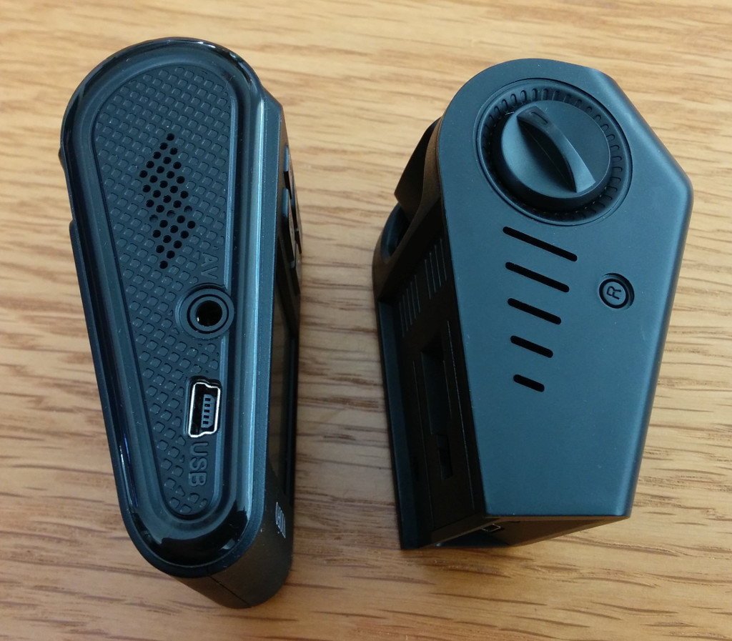

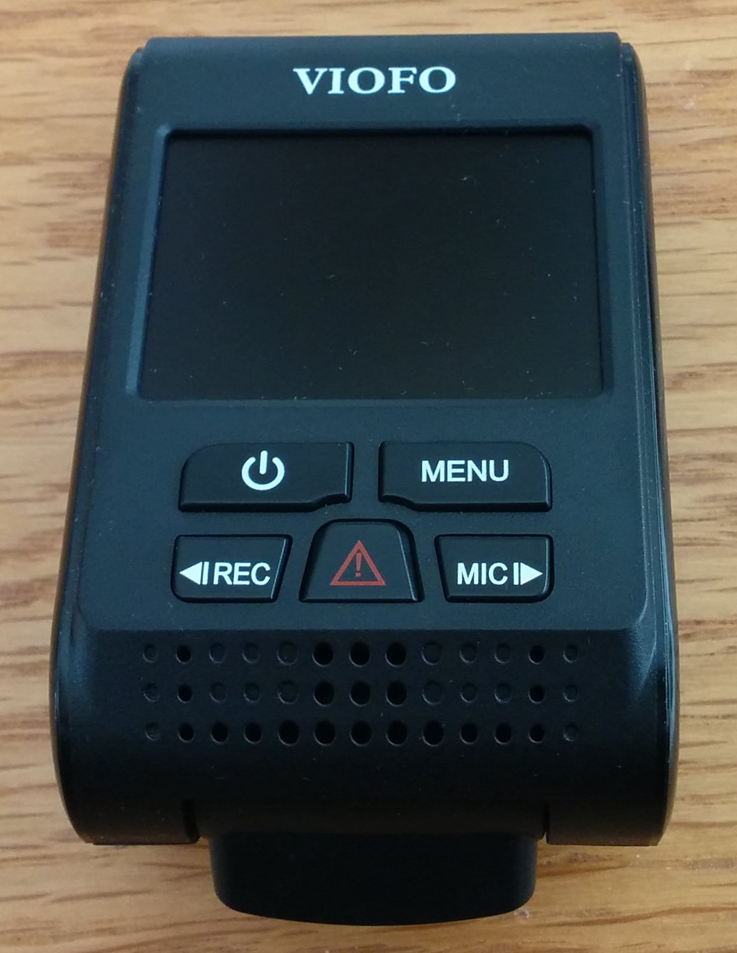

Images.
Box:
Camera:

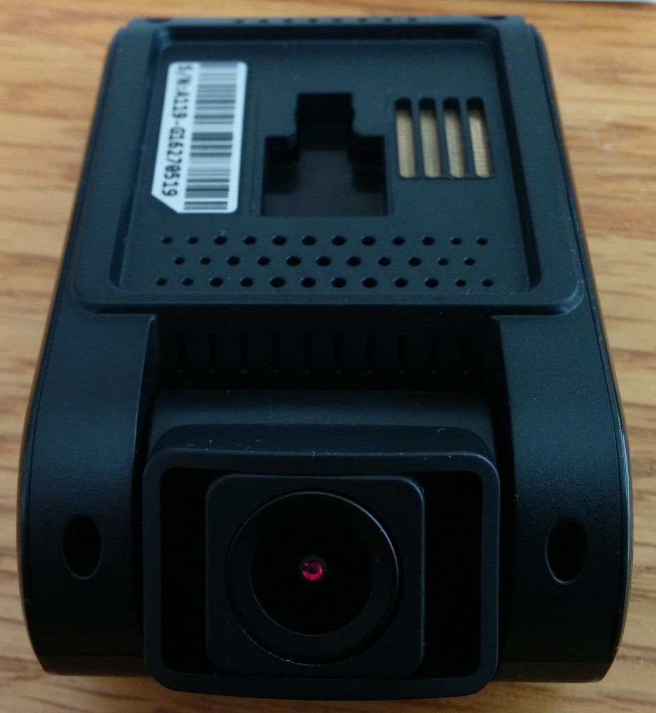

GPS mount:

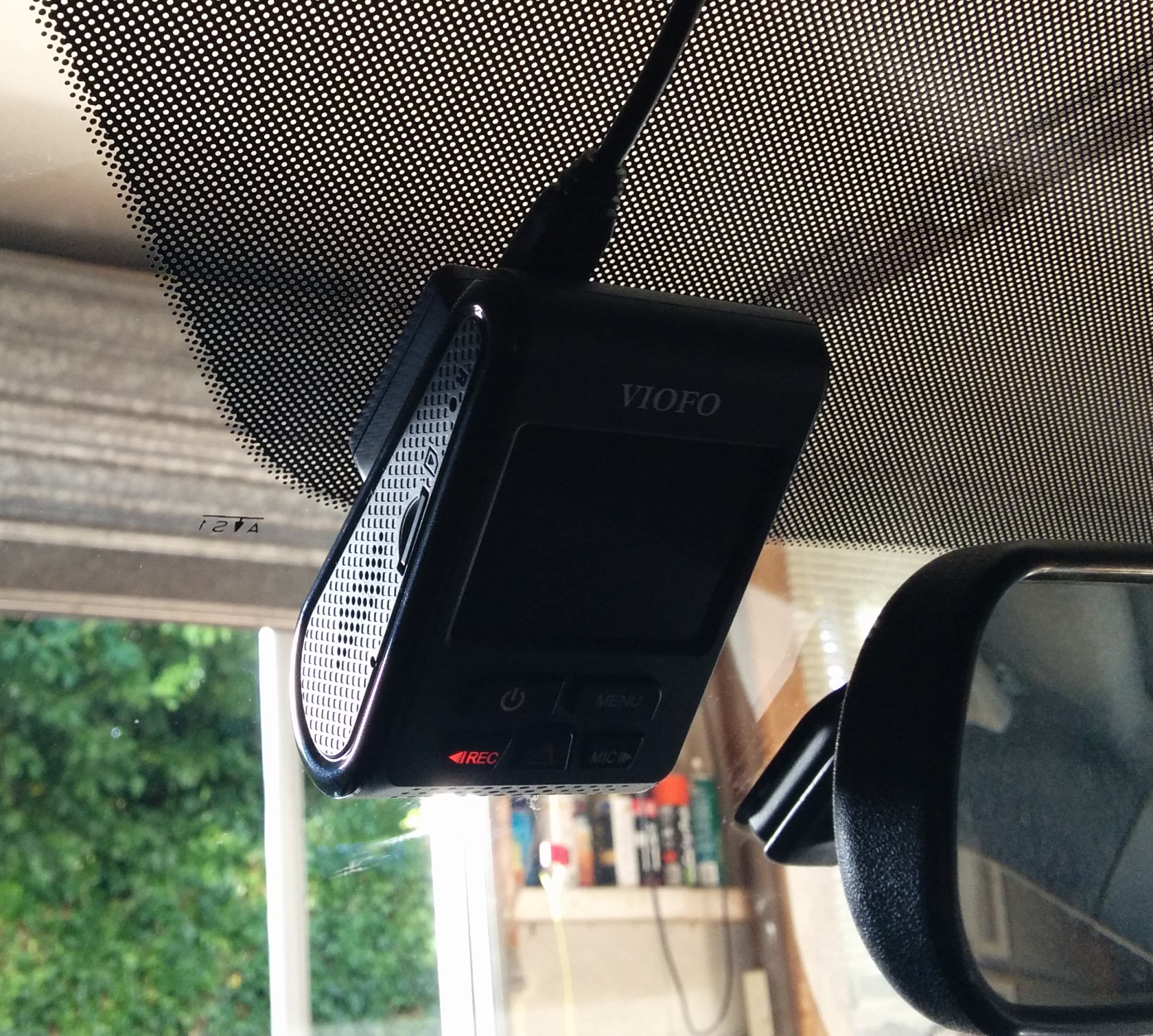

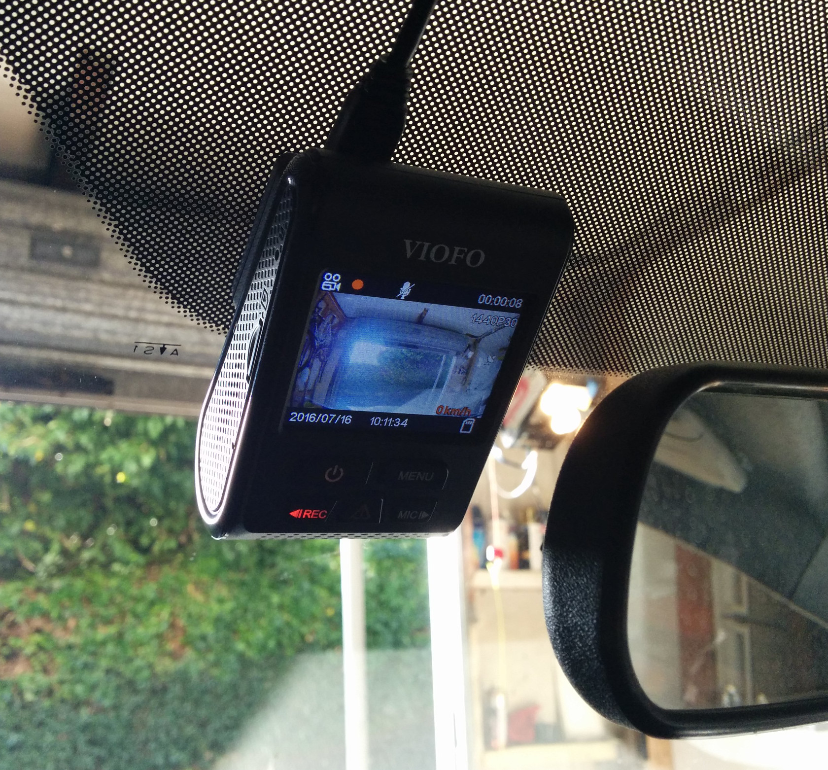

Mounting position:

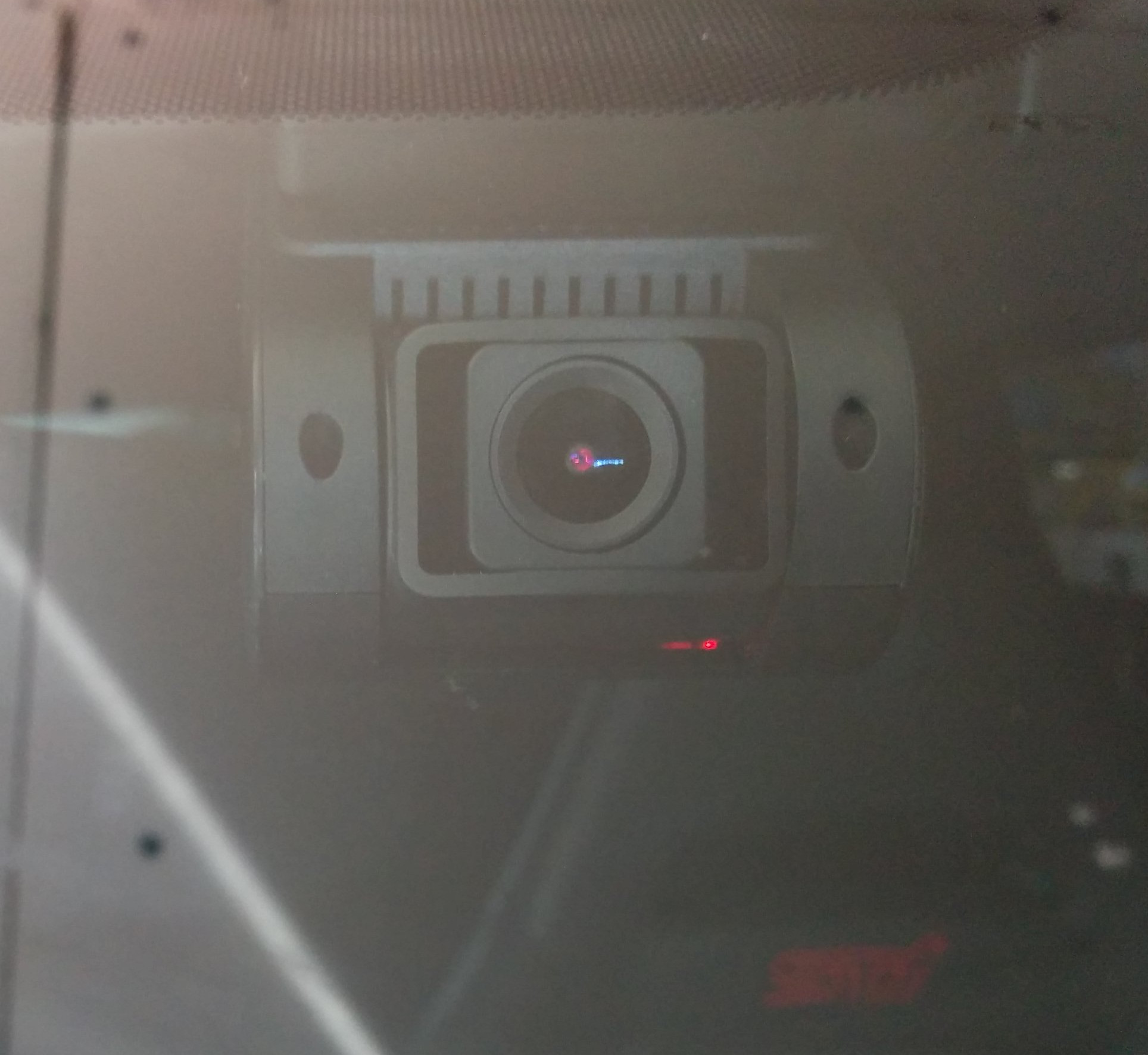

Note: record LED is bleeding through the clearance in the lens mount (LEDs can be turned off in the menu):

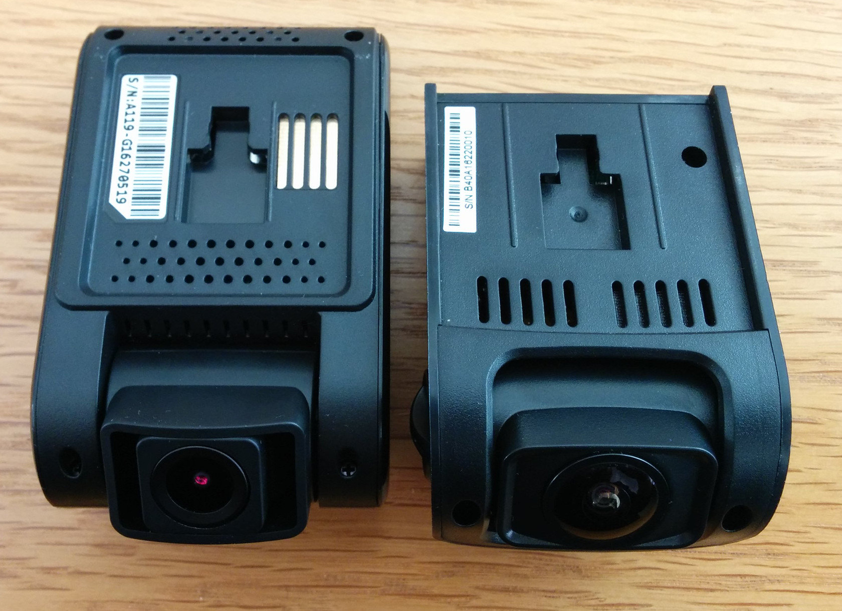

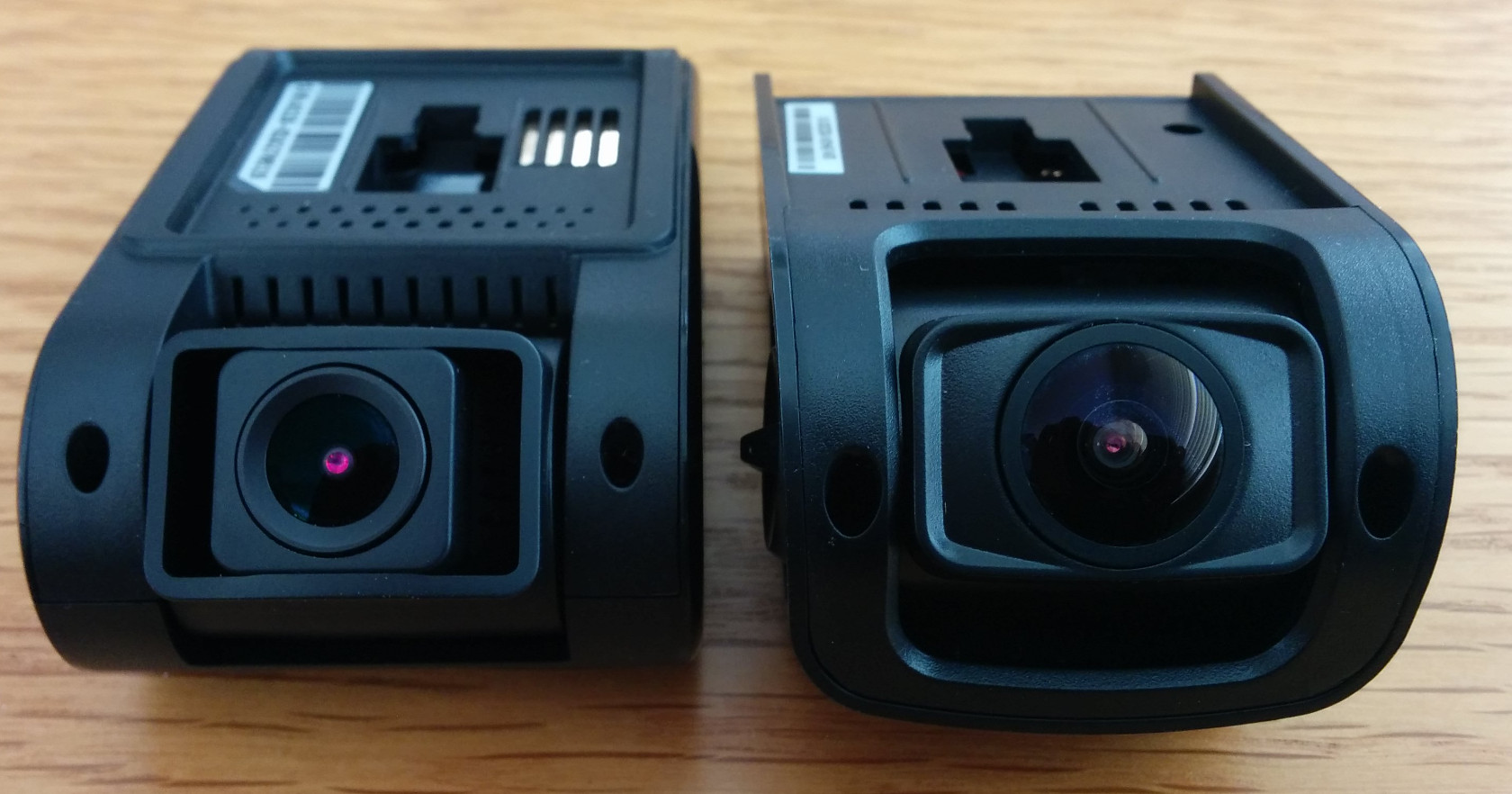

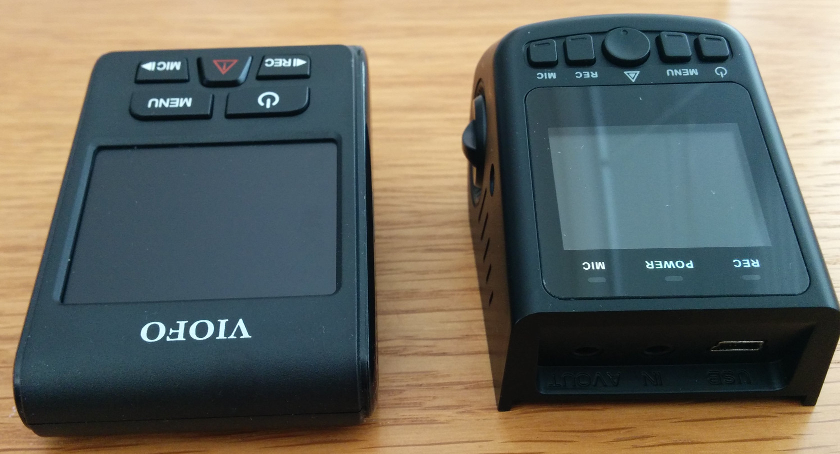

A119 (left) vs A118c (right):
Note: four contacts are for GPS mount connection.
Note: A118c has larger lens.

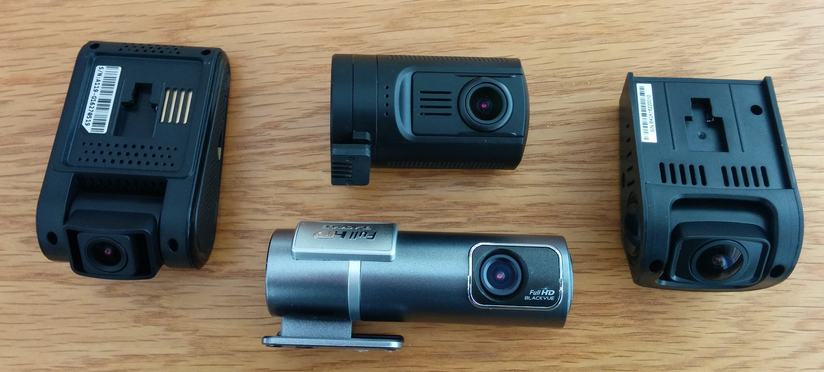

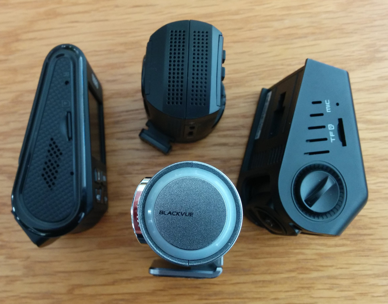

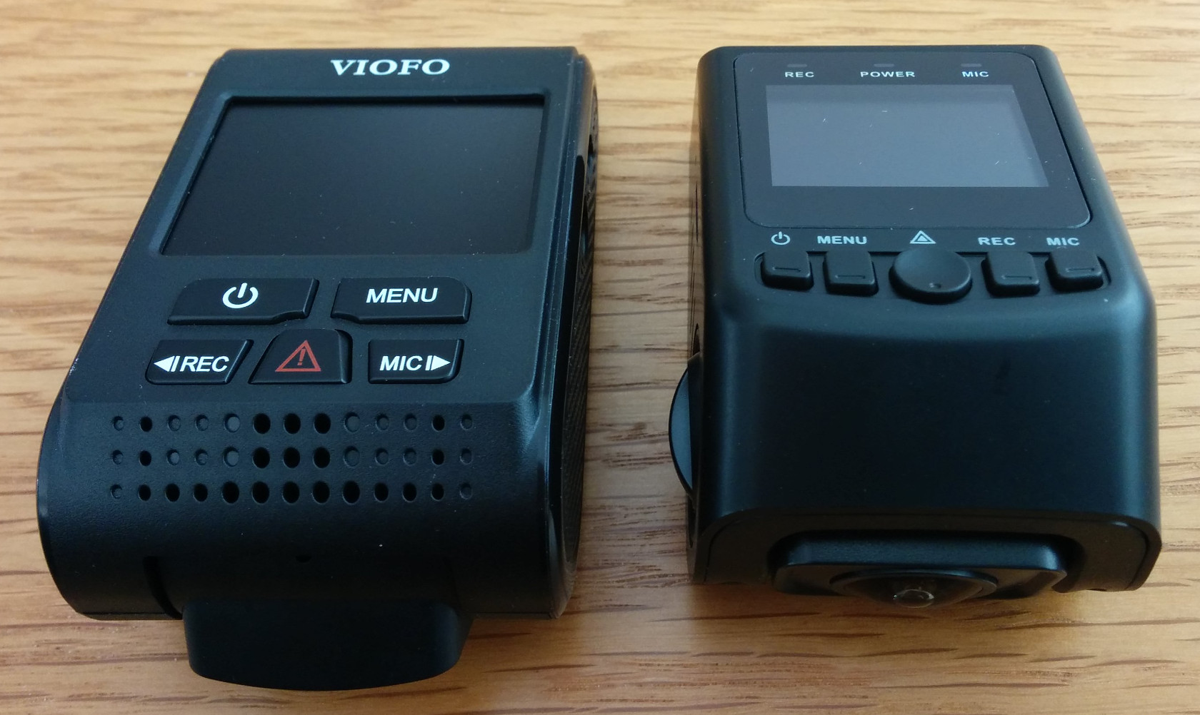

A119 vs A118c vs Blackvue DR400G-HDII vs Mini0806:

Another thing I forgot to add: when the LEDs are enabled they can be visible at the front of the camera via the clearance in the lens assembly.
Any picture of the unit itself? I'm curious about the lens/holder area, wondering what have been changed since the beta unit I've been using.
I will take some pictures in weekend (side by side with Mini0806 and A118C).
