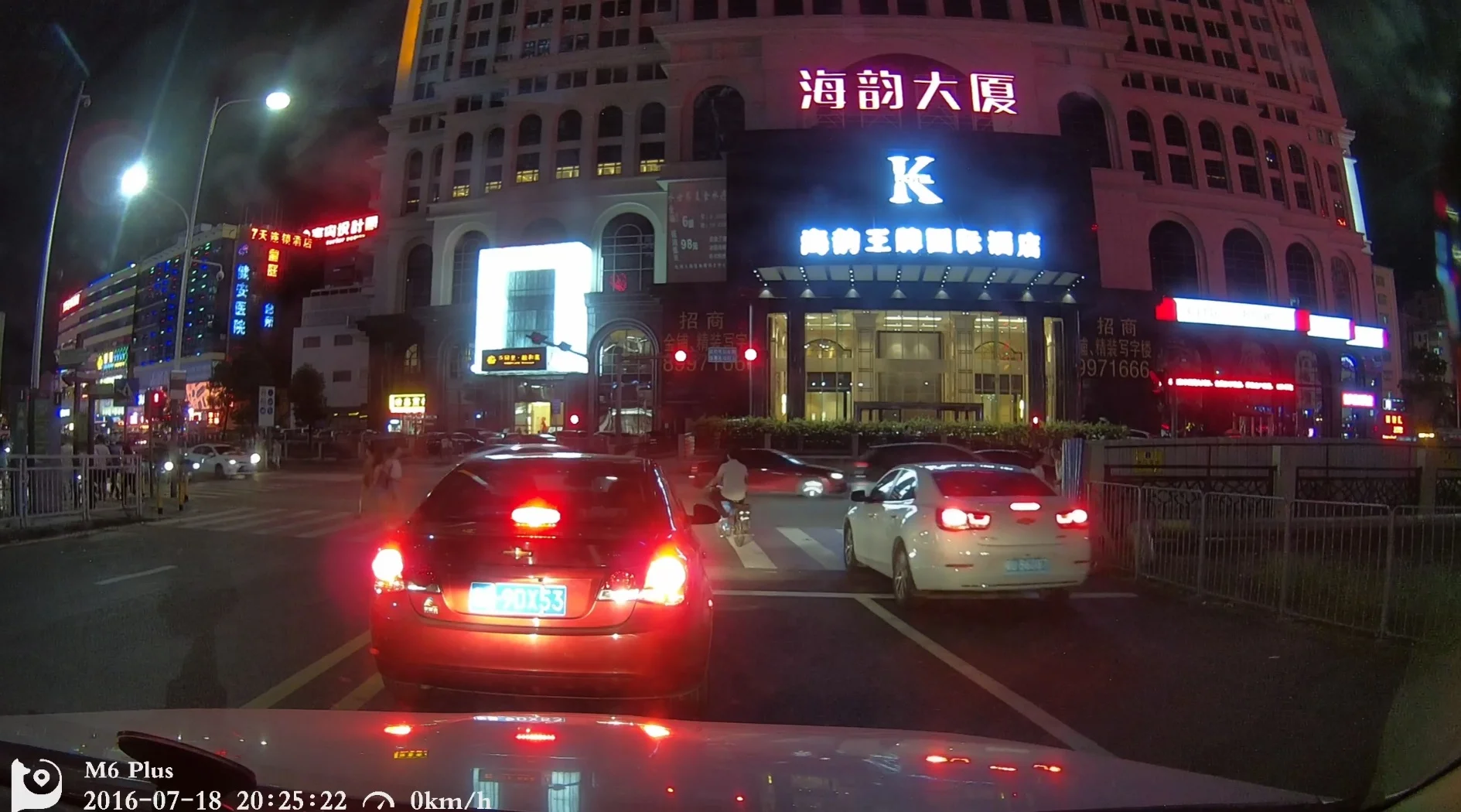

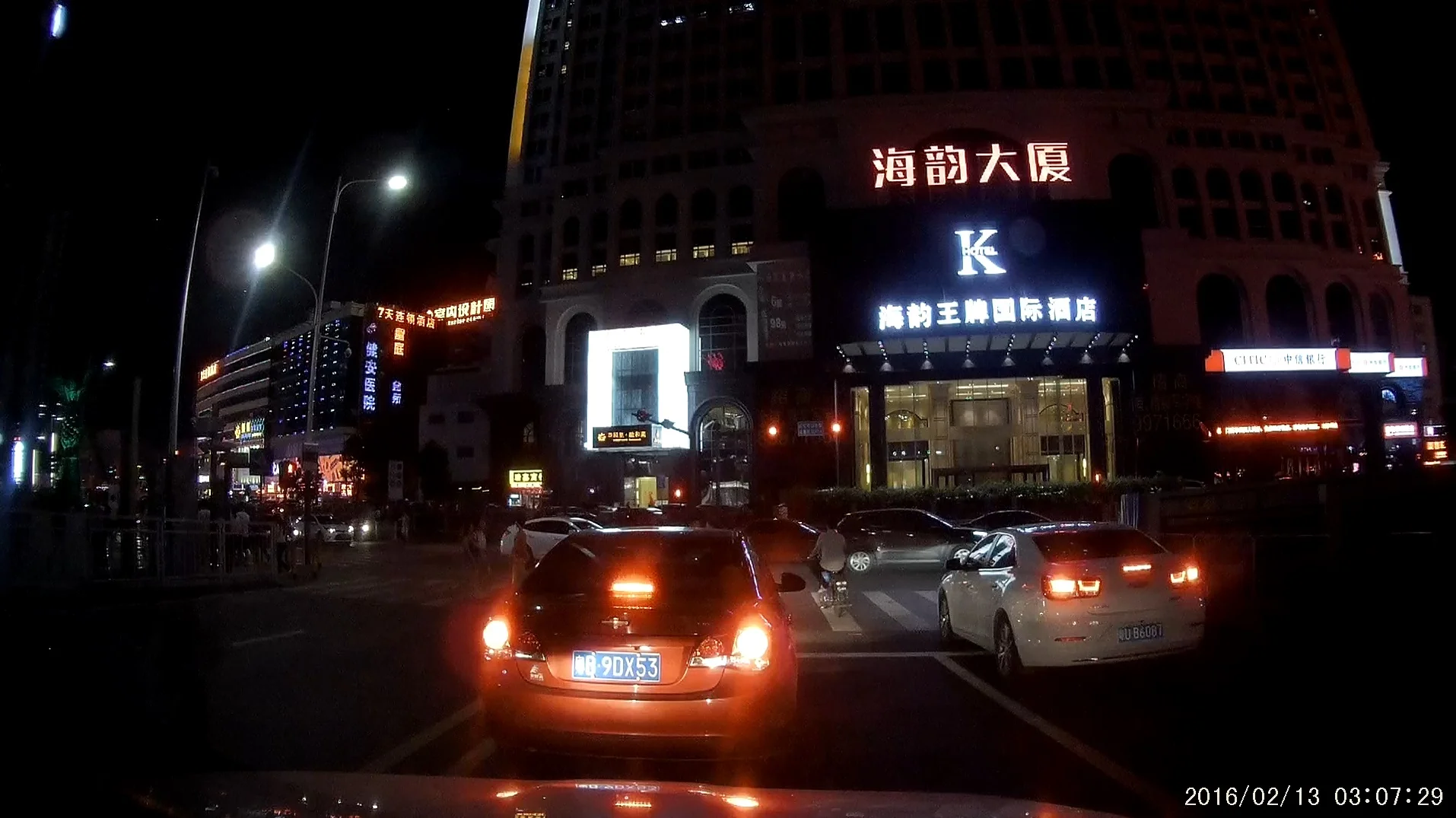

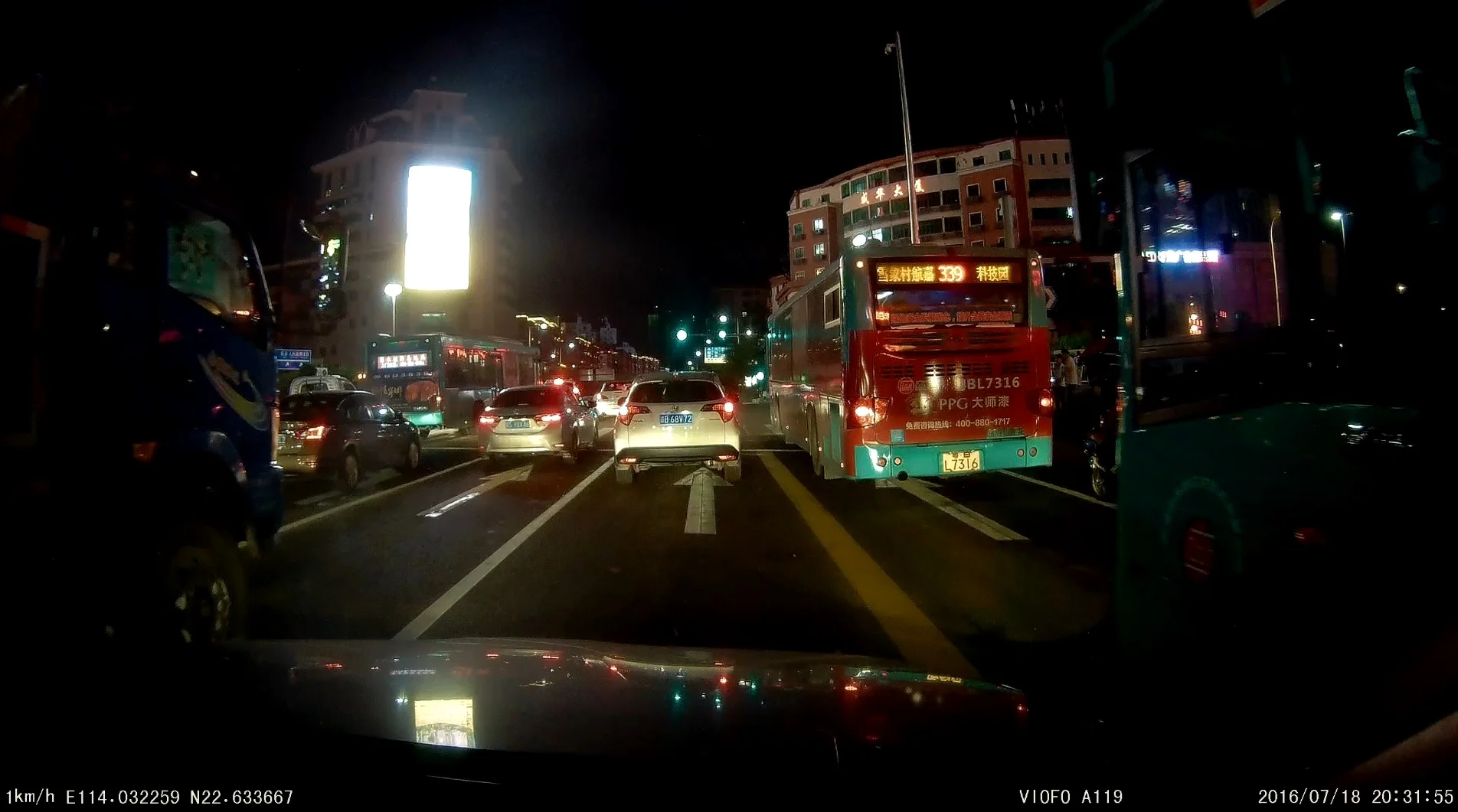

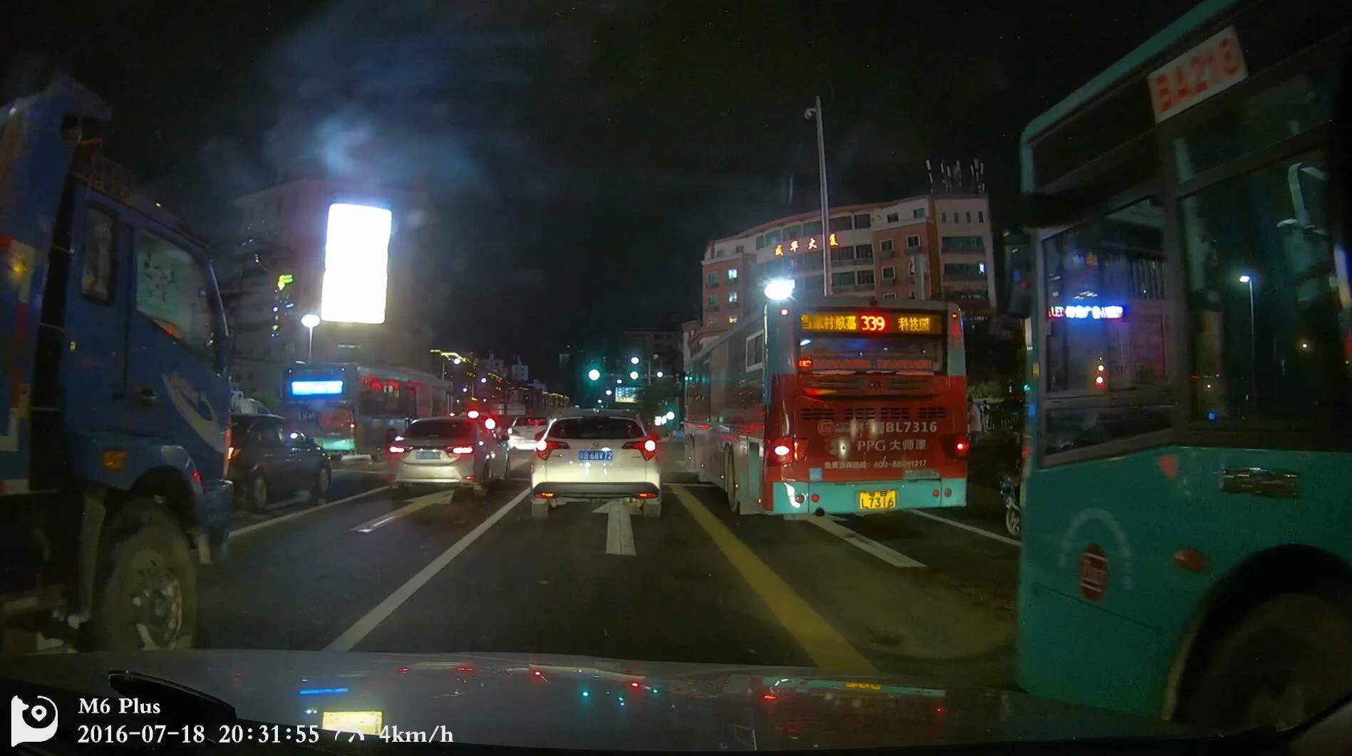

    Only the first one picture is from A119S sony sensor, the 3rd picture is from A119 OV4689 version latest IQ. I did comparison between A119S/A119/M6 PLUS together.

    As I see in your screenshots, both the A119 and the A119S-beta have a sharper image compared to M6 Plus, looking to the car plate numbers.

    Regarding IQ, we mainly focus how to see clearly for the car plate number, so maybe the M6 plus is brighter than A119, but if you pause or just check the car plate number, it is not so clearly than A119.

    In the first pair of pic, AE table made A119S become dark. That's why we can see number plate in A119S but can't see number plate in M6 plus. You may chose others pictures which can show a quality of sensor. Example: pictures when running/parking in a dark street with a little light will be good like the sencond pair of pics.

    Regarding the A119S, I thought some area maybe too dark.
    While I talk with engineer, they told me the M6 PLUS gamma setting is much different compared to A119.

    Collecting more light using WDR or a longer exposure time will result in more motion blur so may not be desirable if trying to read plates on moving cars. Look at the wheels of the moving cars in the above images.

    The M6 plus have less contrast, and the car plate number is not so clearly.

    The A119 and M6 plus use same sensor OV4689.
    The M6 seems brighter , one reason is it use very low contrast.

    You can see from the motion blur on the wheels of the moving car in the M6 image that it has used a longer exposure than the A119s and that has given a lot of the extra brightness.
    We want to avoid motion blur, so if you can brighten the dark areas by using more gamma instead of a longer exposure then it will give a better result if it doesn't make the image too noisy. I guess noise on this sensor is very low so you can probably use a lot of gamma.
    I think the WDR on these sensors also increases the motion blur because it does the bright and dark exposures as separate frames so there is a significant time difference between when the bright light and the dark light is collected which means that it looks blurred when you combine them if there is movement in the image - don't just test it with images with no movement, accidents only ever happen when there is movement!

    Using low contrast, so the dark area is not too dark, that's why M6 plus is more bright in some area.
