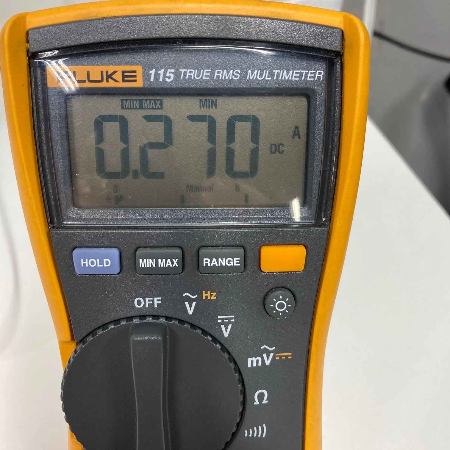

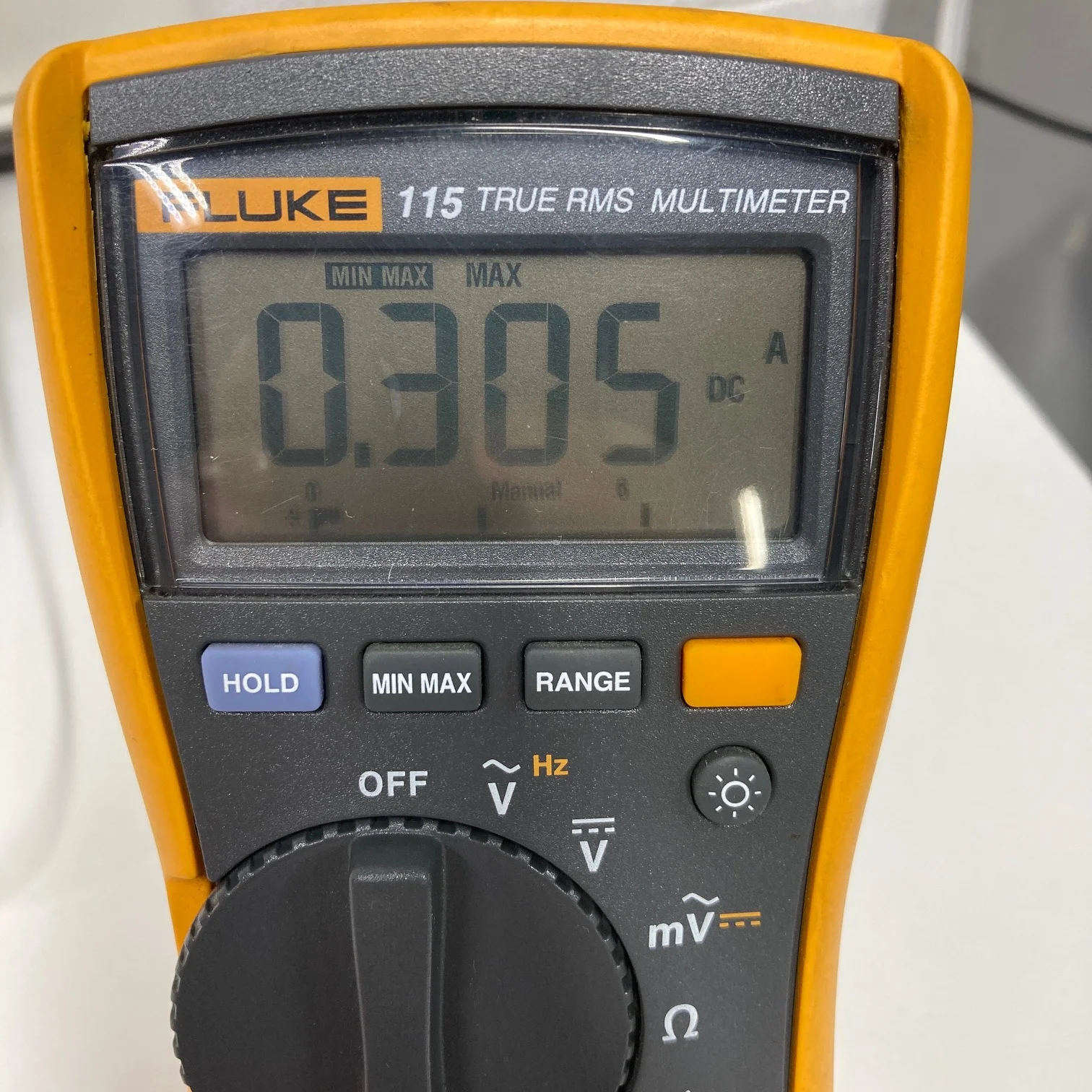

5-Pin GPS - Power Down Testing
I read the new 5-Pin GPS mount with the A119 Mini & A229 Duo is to enable a power down to conserve energy by disabling the GPS Module during Parking Mode. I think this is a fantastic idea, and want to confirm & verify exactly how much power savings it provides.

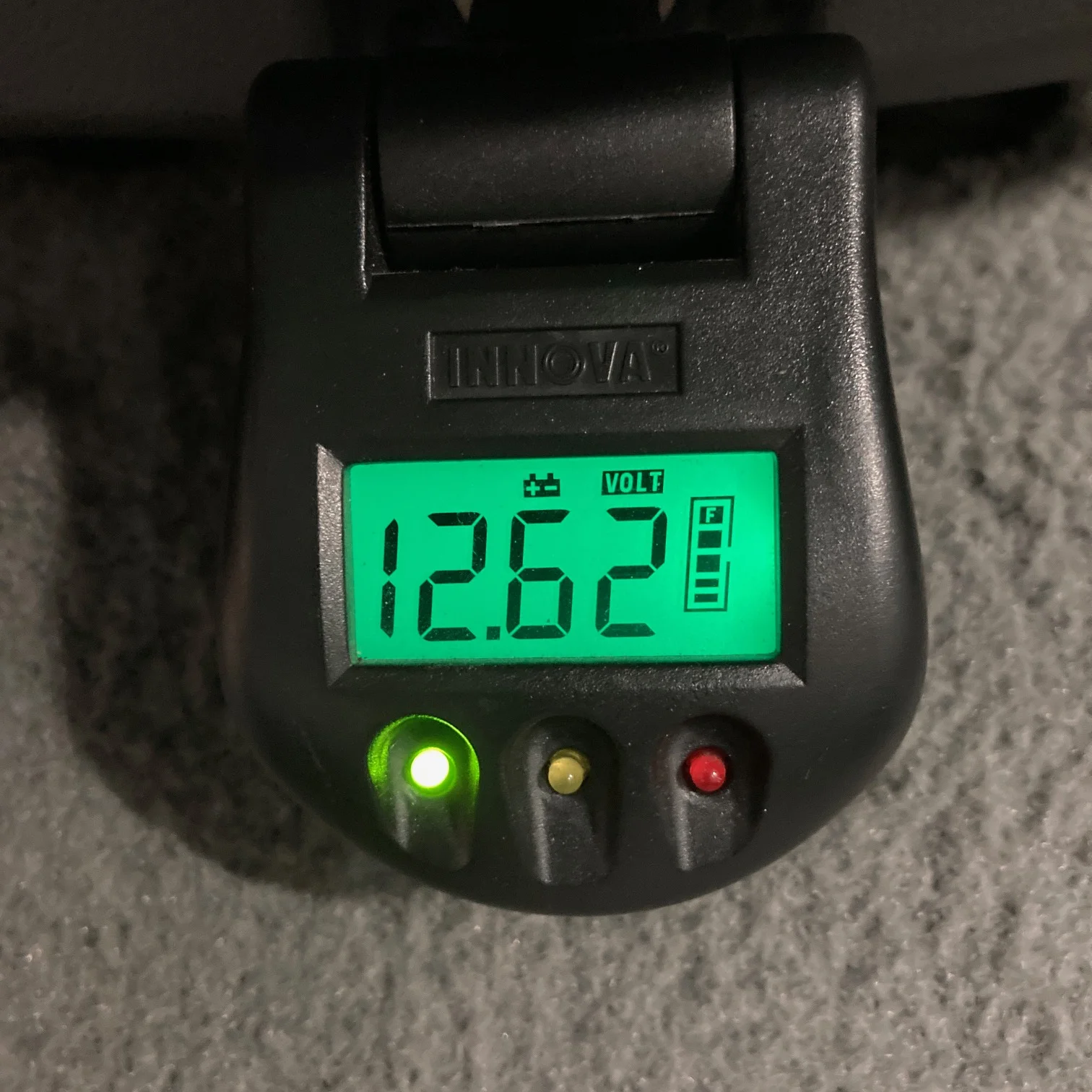

I set up my A119 Mini on the bench with the hardwire kit, and enabled Low Bit Rate Parking Mode.
After entering Parking Mode my Fluke Meter readings are;
MAX 305 mAh @ 12.6V
MIN 270 mAH @ 12.6V
AVG 279 mAh @ 12.6V
I monitored for 30 minutes, and the Fluke measurements never changed, they remained constant. I reviewed the recorded footage, and the GPS Coordinates remain on the text overlay.
Am I doing something wrong?
Has anybody else been able to verify the GPS Module powering down to conserve energy?
-Chuck

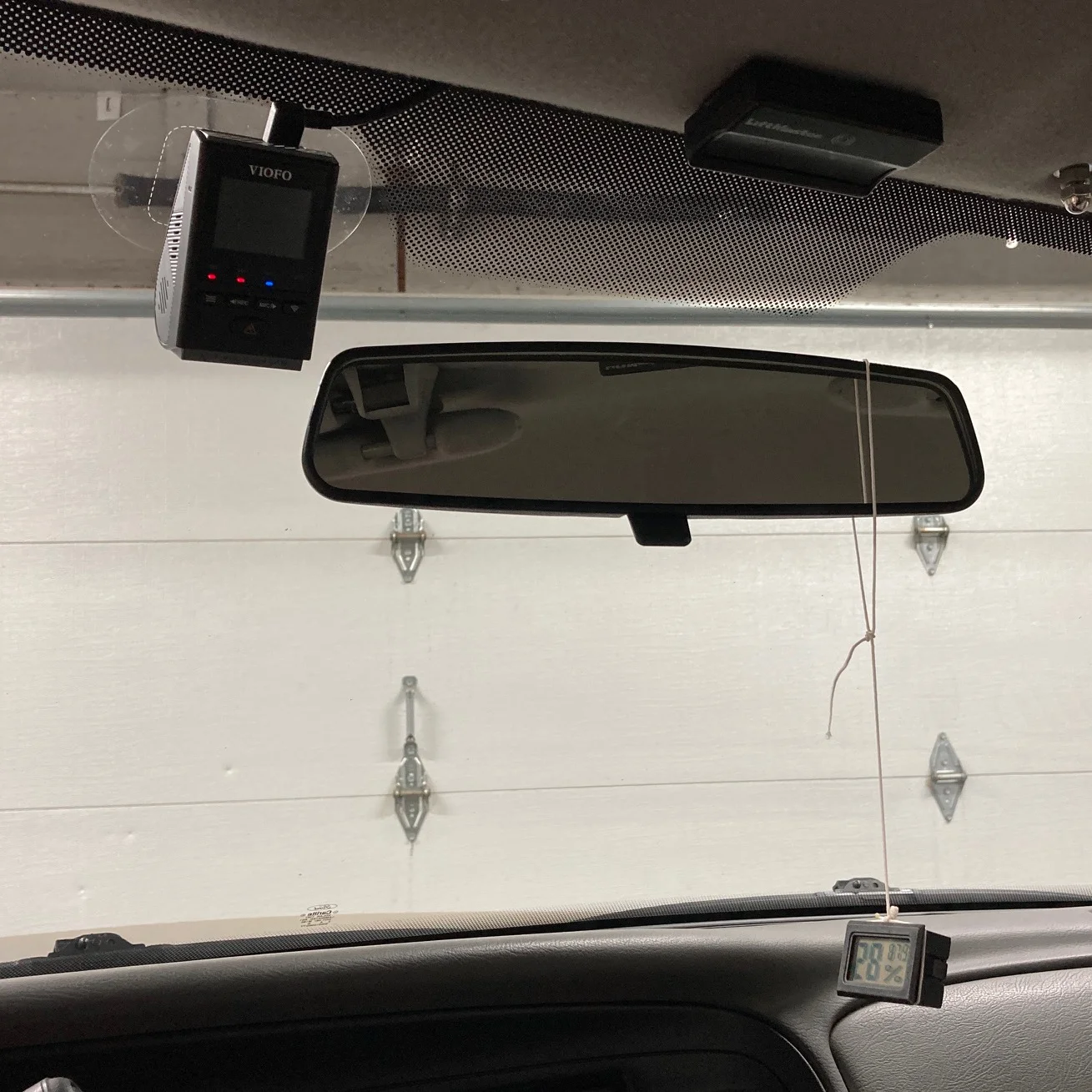

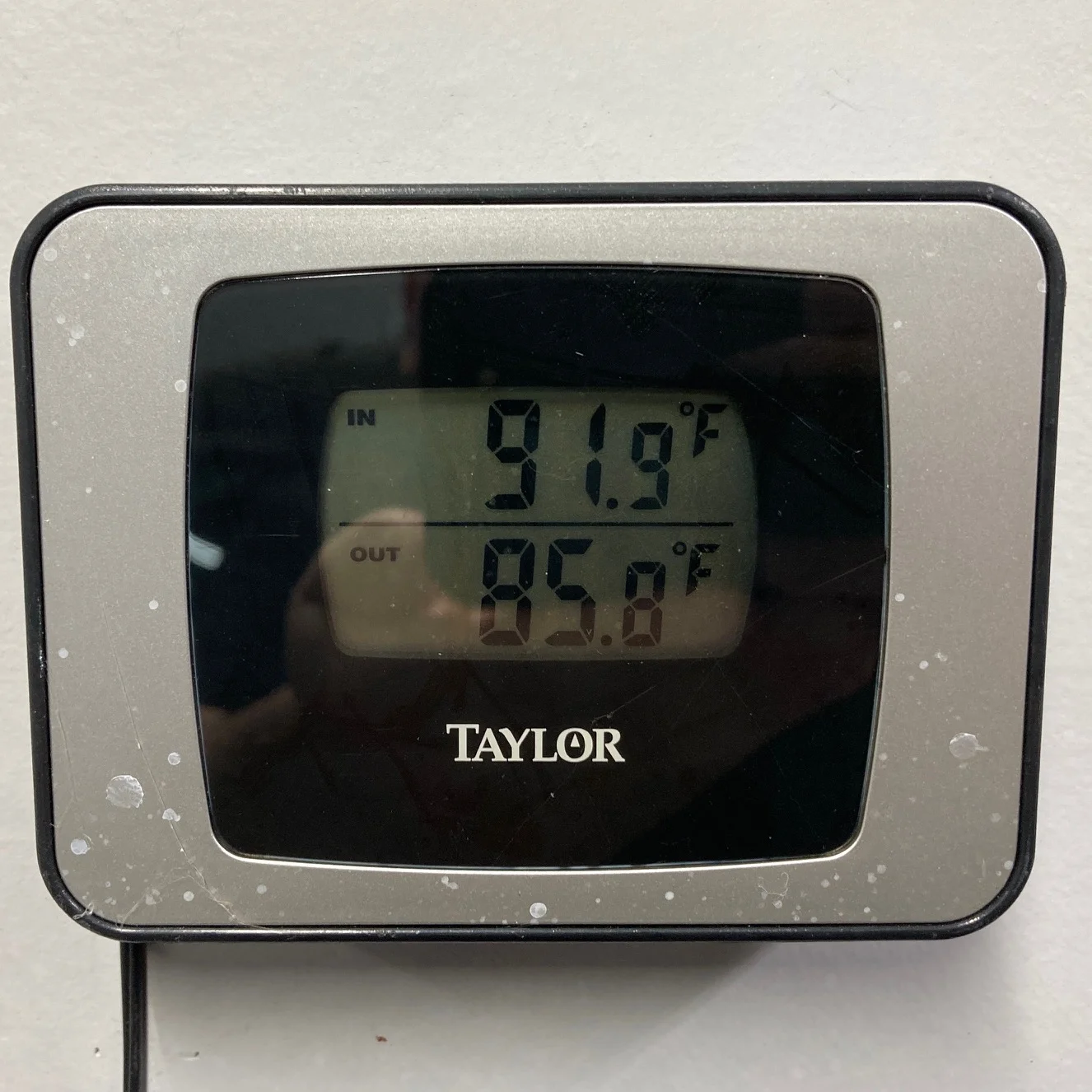

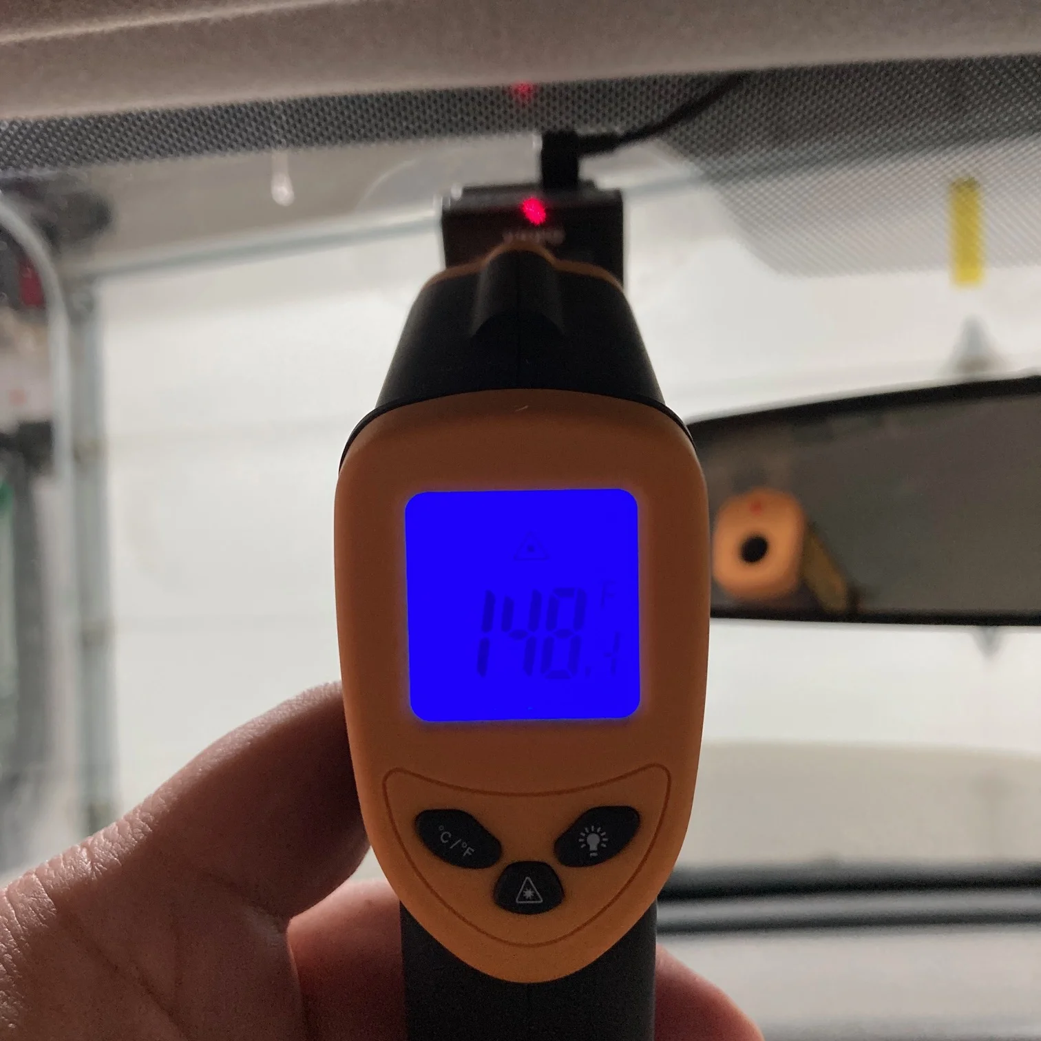

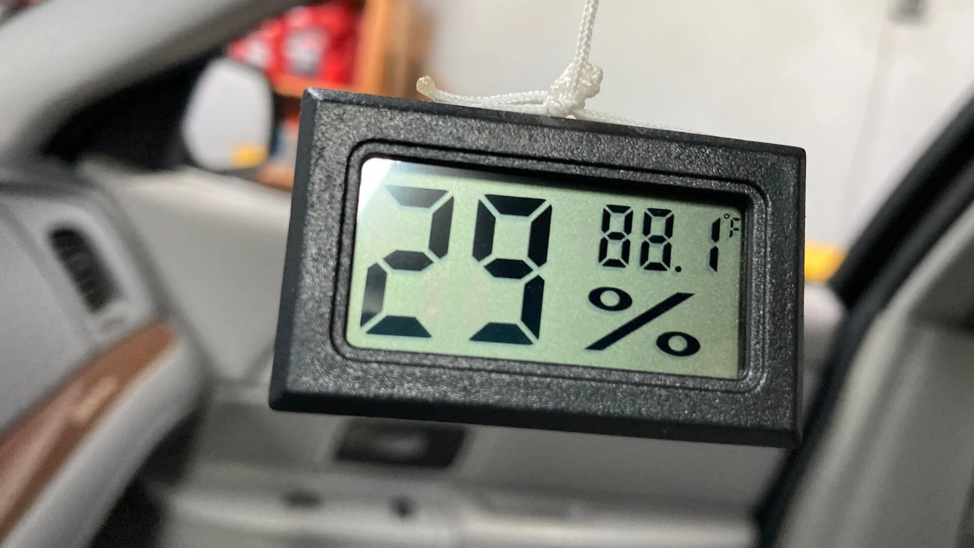

"Gentle" Heat Test:
At 8AM I started the A119 Mini in normal recording mode in my car in the garage, (2K@60fps high bitrate).
I checked the camera every few hours, and it functioned properly.
At 7PM the temperature of my garage was 92℉ / 33℃.
At 7PM the in car temperature was 88℉ / 31℃.
At 7PM the camera temperature was 148℉ / 64℃.
At 7PM I checked the recorded files on the SD Card, and found no malfunctions.
I wonder if low bitrate will let the camera run a little cooler, and by how much?

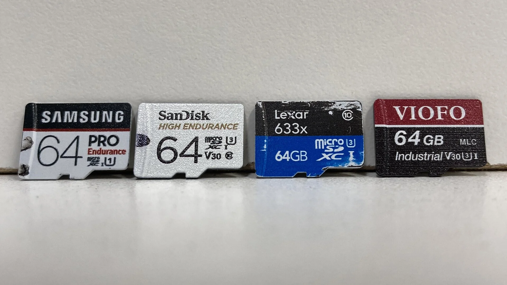

I’ve been testing my A119 Mini for a week now running it 12-16 hours a day.
I’ve been using a few different SD Cards, and I have not encountered any malfunctions.
Samsung Pro Endurance 64GB - Bought on Amazon 2020 ($13);
https://www.amazon.com/gp/B07B9KTLJZ-
Sandisk High Endurance 64GB - Bought on Amazon 2022 ($12);
https://www.amazon.com/gp/B07P3D6Y5B-
Viofo 64GB - Provided by Viofo with A119 Mini ($33);
Lexar 633x 64GB - Bought on Amazon 2015 ($??)
