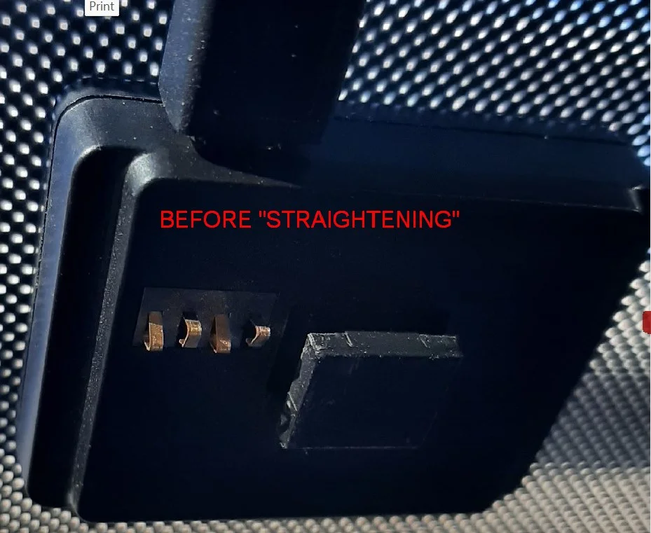

I recently noticed that the videos recorded on my A119 v2 were lacking the GPS info that they had before (coordinates, speed), and then I noticed that a "No GPS" message is displayed in the lower right corner of the display soon after bootup. Then I noticed that some of the pins on the mount are bent.

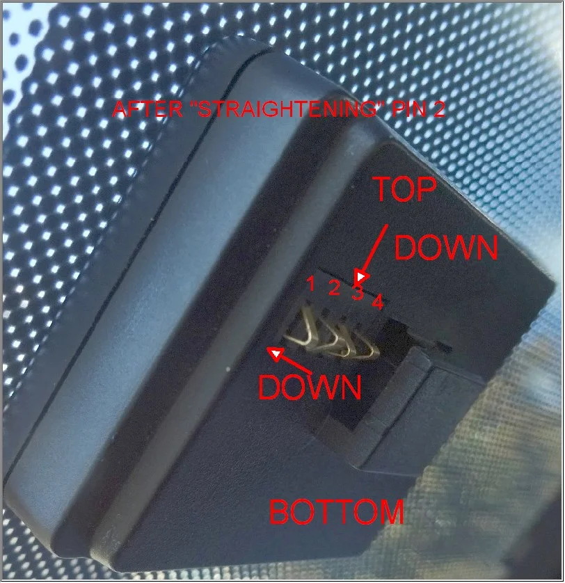

I'm not sure how the mechanism works, but I'm guessing that when I slide the gps down over the mount, it pushes the raised part of these pins down, as indicated in the photo, until they make contact with a pin inside the mount, thus completing the circuit. I'm not sure of that at all. The second pin was particularly bent, seemingly pushed towards the top, and the bottom surface which goes into the hole was rounded. I tried pinching that pin with a needlenose pliers to flatten that bottom surface curve, hoping that it might have a better chance of making contact inside the mount when pushed down. Still I am getting the "No GPS" message.
I may be misunderstanding how this mechanism works, and what I need to do to make contact again. Could somebody advise me about this?
