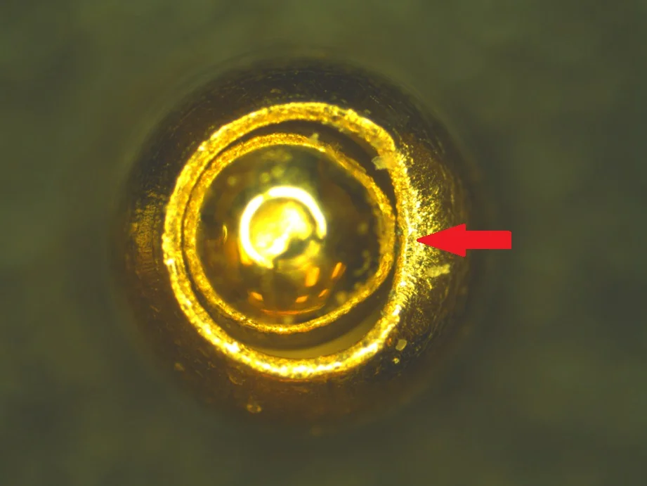

So I came across my first stuck pin. When I sell a GPS mount I always try to remember to press the pins to make sure they bounce back. This one did not. They are so small, you really can't tell what's causing it to hang up. So I put it under a microscope and took this picture. Something must have bumped it and deformed the pin sleeve (or whatever it's called). I wonder if this is the case with a lot of these stuck pins. I was able to stick a scribe tool into the hole and bend it back. I believe they are brass, so it doesn't take much. Now, as soon as I did this, the pin bounced up, but only about half way. Upon further inspection, I could see what appeared to be plastic inside the sleeve next to the pin. It took a few minutes, but I was able to get 2 pieces of plastic out. I used very pointy tipped tweezers, but a pin would probably work as well. I can only assume the plastic came from the bag the mount comes in. I bet a lot of people press the pins through the bag, I know I have. I'm thinking the pin pinched the bag and some got stuck inside. I'm not sure how the electrical connection occurs inside the pin, but I wonder if pieces of plastic could be causing some of these electrical issues with the mount.
I know most users don't have access to a microscope, so they probably won't be able to see it well enough to fix it, but maybe this will help someone out. Also might be good info for @viofo. Might want to put these mounts in a different kind of bag.
No it's gold plated. Brass will corrode fast = lot of bad connection.
that photo will be very useful for @viofo to show the hardware engineer and the production manager

It appears that the base material for the pins and sleeves is too soft, too thin, or both if they can be manipulated so easily. If these are outsourced by the Viofo factory there might not be an easy solution available unless that same size device is offered in a more robust material. Otherwise that part of the mount would need to be redesigned for something better which is compatible with the cam as-is. The automotive environment is tough to survive in which makes designing for it equally tough and any deficiencies will show up quickly in the hands of the consumer no matter how well the design was tested in the factory engineering lab.
