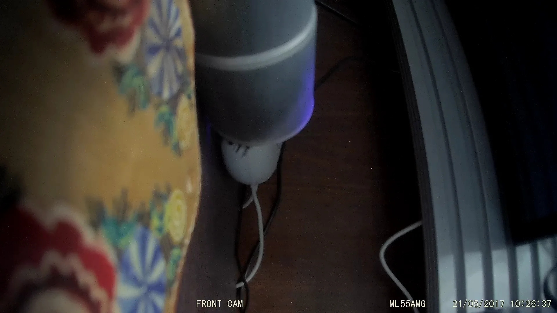

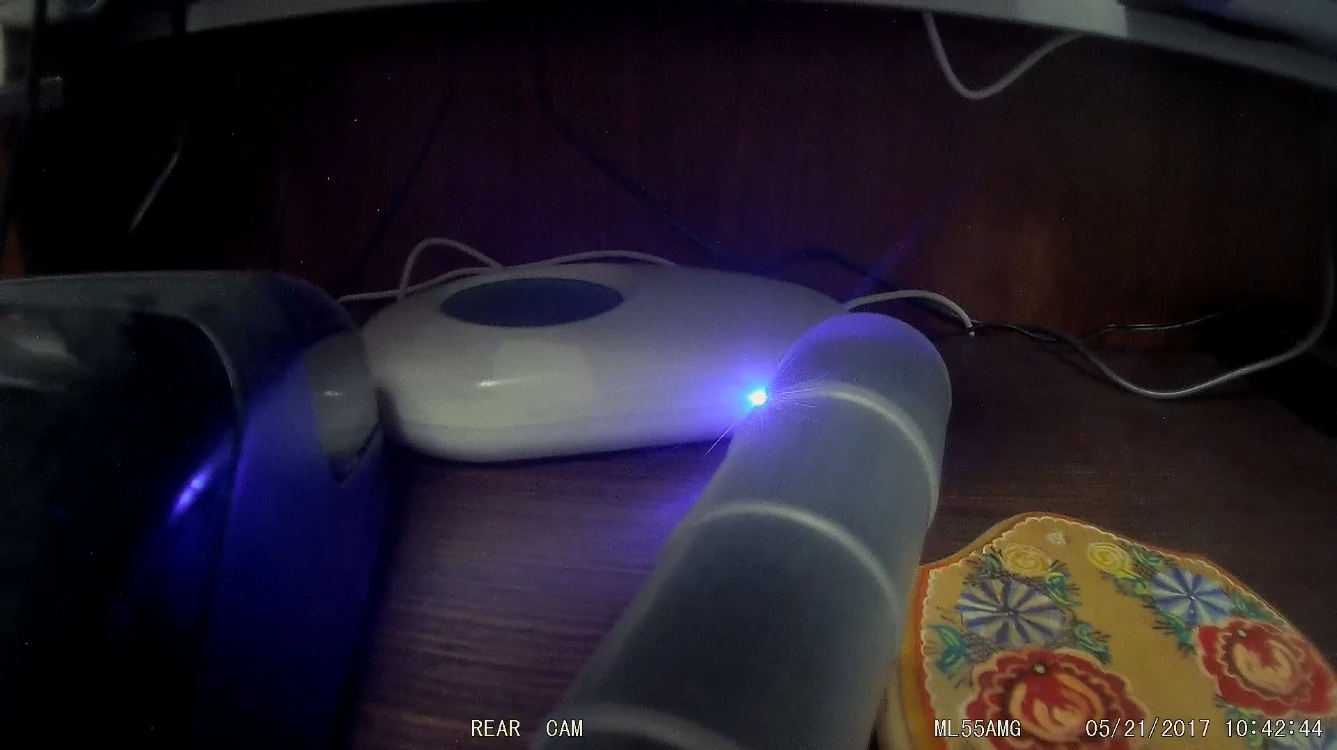

Just received 2 Viofo A119S v2 Cams from the AliExpress supplier "Shenzhen Smartway Technology Co., Ltd." Have the same issue as described in the thread above: both cams have tons of bad (hot, white) pixels. The picture looks completely ugly because of those. Is there finally a solution for this problem? Or shall I return the products to the seller? Do they have quality control there at Viofo at all? Wanted to write a review on the cams, and actually wanted it to be positive... Am very unhappy with Viofo quality now.
There is only once source for Sony sensors. All sensors have hot pixels that need to be calibrated away. A new auto Calibration future firmware update will address this. It's not a defect. You just need to be patient for the update to come out. If you return them for new units you may have less hot pixels but some will most likely still be there.
