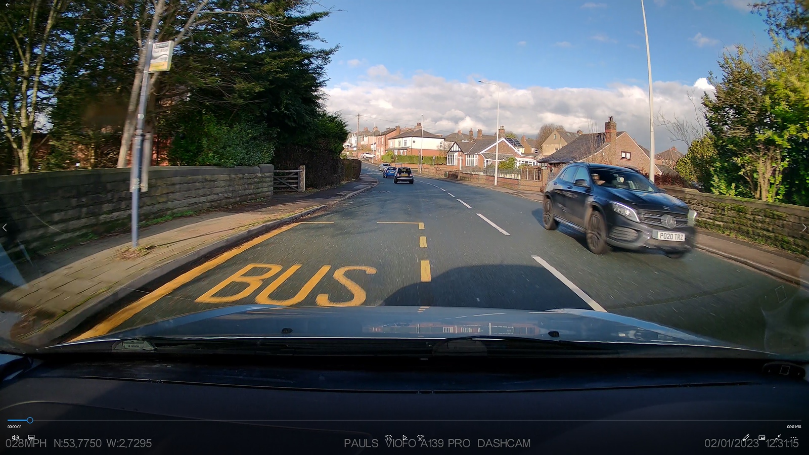

I noticed this on a freeze frame from the other day - HDR is on:
Anyone else? I assume this double edge (on the plate and car badge) is an effect from the HDR feature.
Paul.
Yes, that appears to be normal for the A139 Pro Clear HDR. It is a combination of a short and a long exposure, captured at the same moment in time. The low sun behind you permits the short, bright exposure. The long exposure fills in the shadow detail.
If you look closely, you will see the double edge in all bright/reflective areas of the image, notably the car, road markings, road sign.
Daylight example. Pretty impressive I'd say.
Paul.
It shows that A139 Pro HDR is very useful in daytime, without it you wouldn't read that plate. Remembering that it is winter, and the A129 Pro had lots of problems with winter lighting when it was first released at Xmas, but was working well by Easter!
