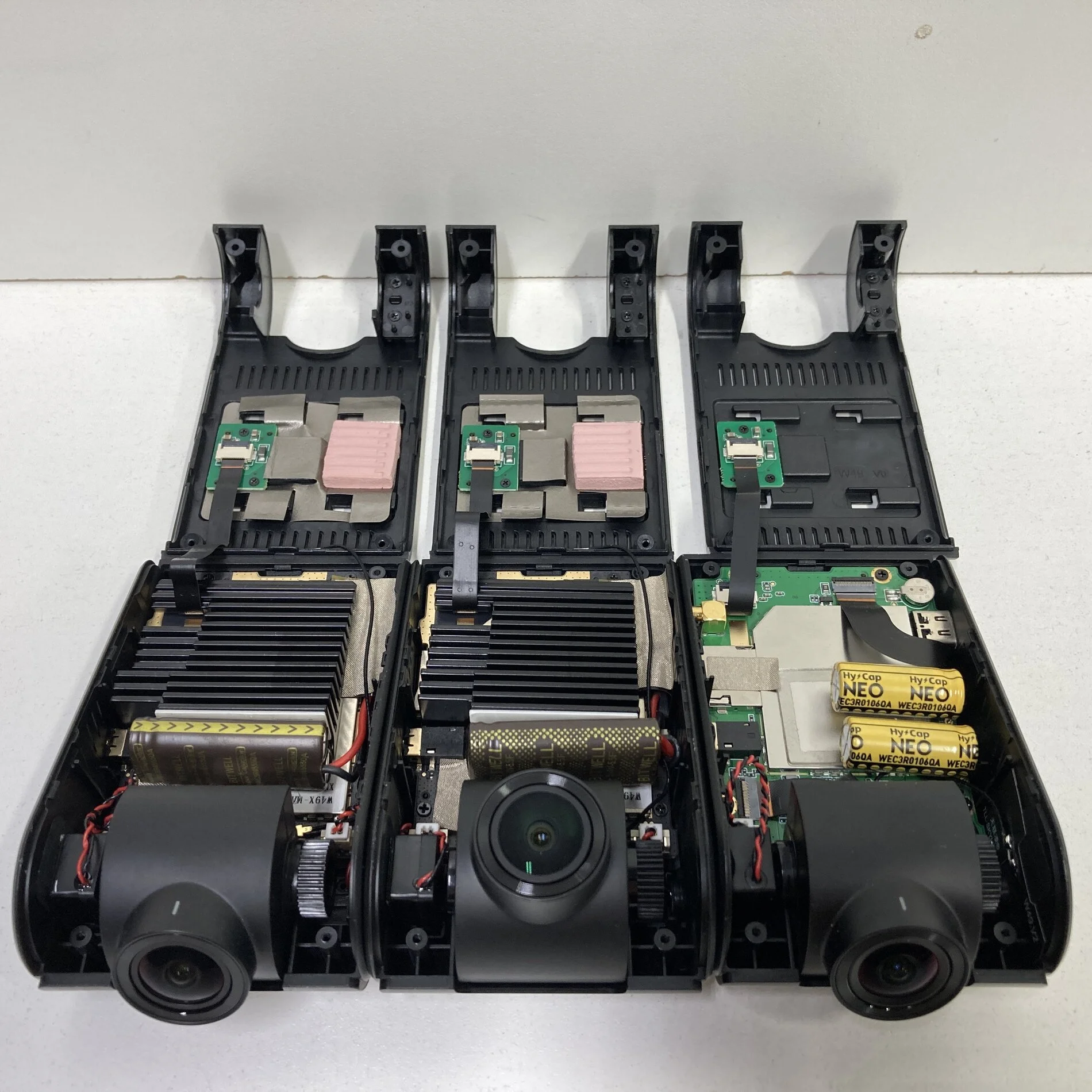

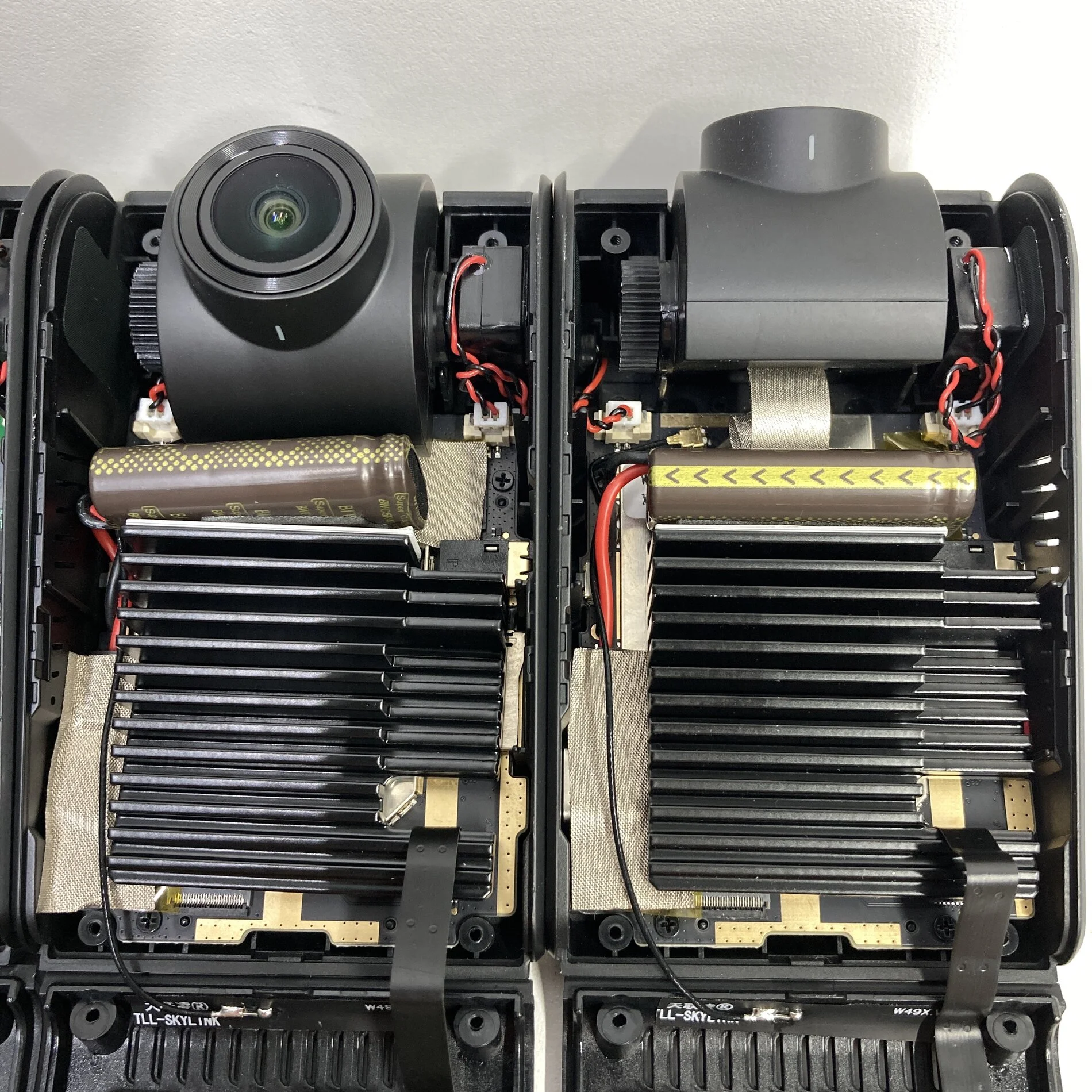

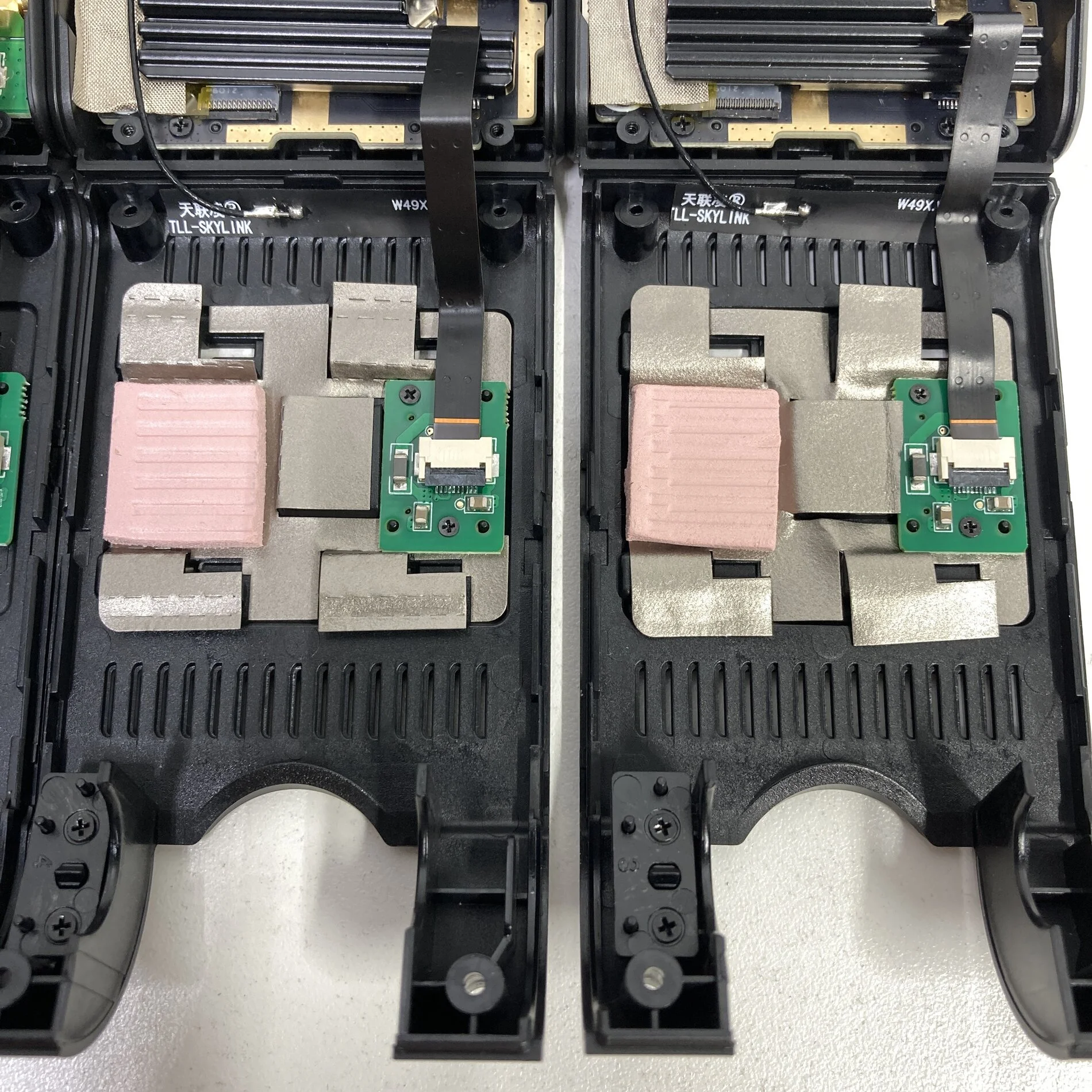

This post is for @VVonderwalle
Q: Does the A229 Plus have the same heat sink as the A229 Pro?
A: You tell me, (plus is middle).

My a129pro died after 2y, I found that the thermal paste was a tiny spot (1/10 of the area). Any chance that we can reapply the thermal paste for a229pro and add more heatsink/vents to decrease its max temp of 75°C down to a229plus' 5x°C?
Yes, you can apply more paste to the heat sink/chip. Just do not over do the paste. I have two of the A229 Pro, one installed and one not installed. Think I will disassemble the second one and see how much thermal paste they have on the heat sinks.
Any thermal paste will work, I have Thermal Grizzly and Noctua paste, both are excellent.
