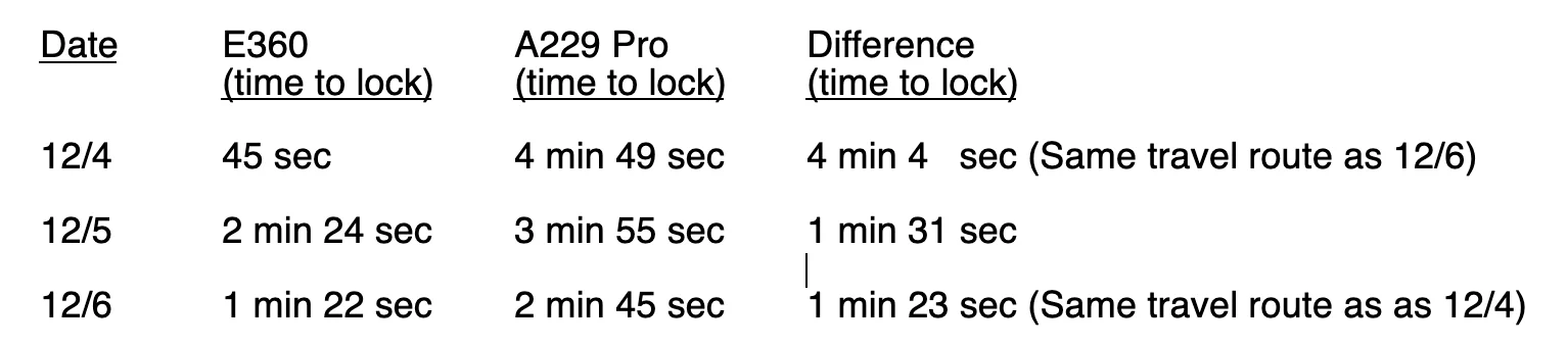

This thread got me wondering. What's the difference in GPS lock time between my Viofo A229 Pro (241024 F/W) and Vantrue E360 (2024-12-06 F/W)?
Both cameras are mounted to the windshield at the same time so in theory the time to lock should be identical.
The A229 Pro definitely took longer. I will repeat this after updating A229 Pro F/W with 241206.
