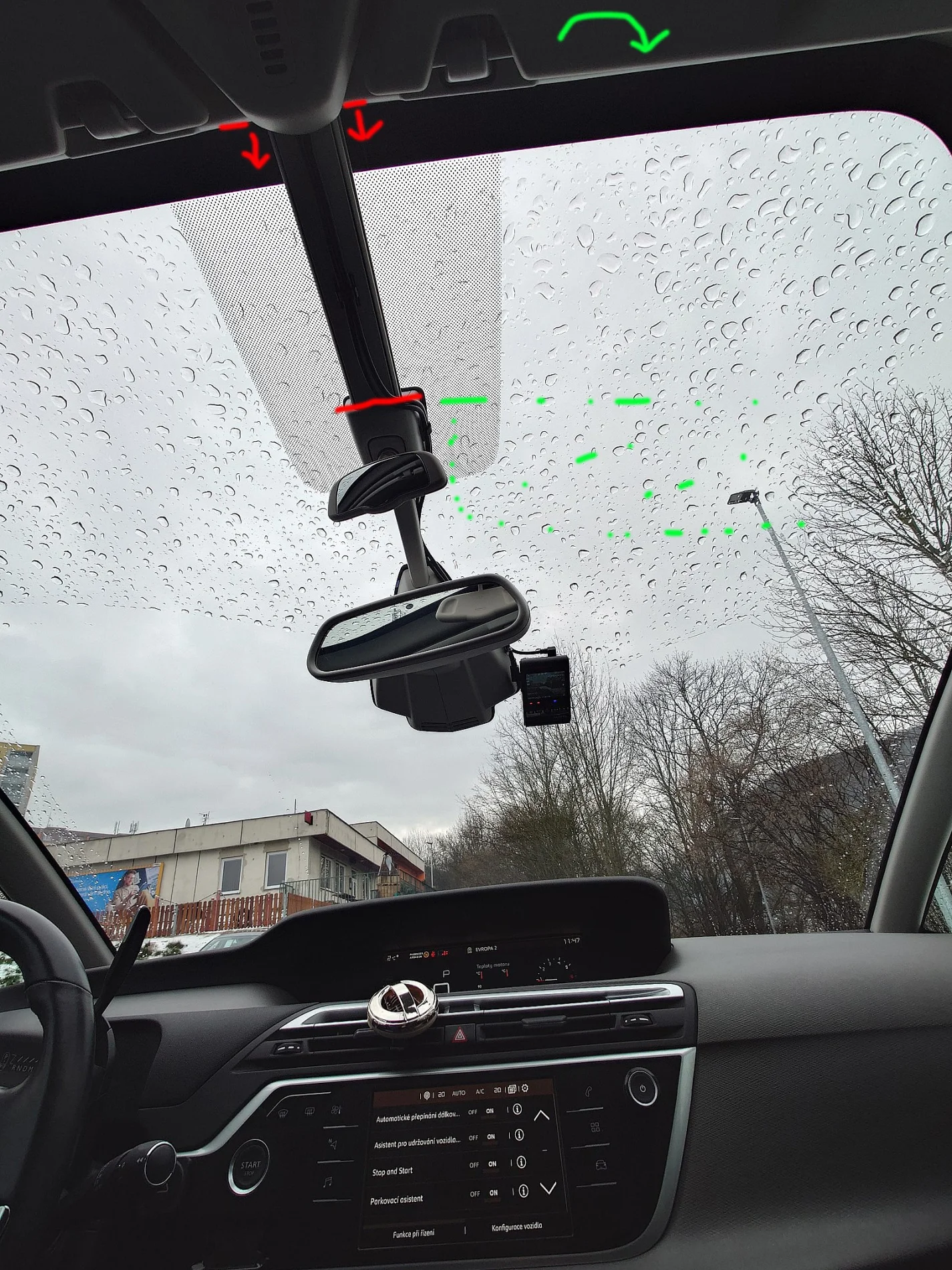

Hello, so after week tests, when I was more and more confused, it seems that I found the reason with poor GPS lock. In short - big athermal windshield in Citroen C4 Spacetourer (Grand Picasso) 2022. Today I found this thread and situation is same for me. I don't understand one thing - why my old A119 v3 with much older HW worked fine with GPS more than two years on same position like this new "much improved" HW πŸ˜• Much annoyng.
BTW I think, that I had A119 v3 more then 5 years and previous car was same C4 Grand Picasso 2016. Never had GPS issue.
Like I tested, maybe it will be better for me to draw it, than explain it in English πŸ˜‰. Anyway, whatever you can think of, I've already tried 😎
As I said, I had one not yet instlled A229 Plus so I took it to my car. Few days I watch it leaved loose on passanger seat, on that seat under a cloat, on the dashboard, in middle compartment in the dashboard... and GPS lock was everytime very fast (immediately or no more then 30-45sec.). During these days A229 Pro on windshield had no more then 2-3 locks. It looked like GPS modul from A229 Pro is realy bad (I tested even swap cameras and problem persists on the windshield no mater if Plus or Pro was attached). So I swaped the GPS moduls on windshield. And? Problem persists on the windshield again 😑 and now original "bad" GPS modul works fine out of windshield.
I also tried another CLA, short power cable between CLA and GPS modul, powered from powerbank in "death" car to prevent interverence, also ferrite filter on power cable even cable from rear cam... Nothing worked
In Citroen C3 2016 or Mercedes Vito 2022 works another A229 plus very well. But both cars have not athermal windshields and windshields are much smaller then in C4.
So now what... πŸ€” Maybe solution can be the above-mentioned GPS modul from A329 ? Obviously it can work when the old A119 v3 worked. But our all 4 cameras was buied in two purchase in December 24 from Czech Viofo dealer, so maybe it already cointains improved modules (like was previously mentioned here) πŸ€·β€β™‚οΈ. I found, that on 3 pieces is marked 2431 on the board and on one 2423 (maybe - not good readable). Maybe the date of manufacture (yyww)?

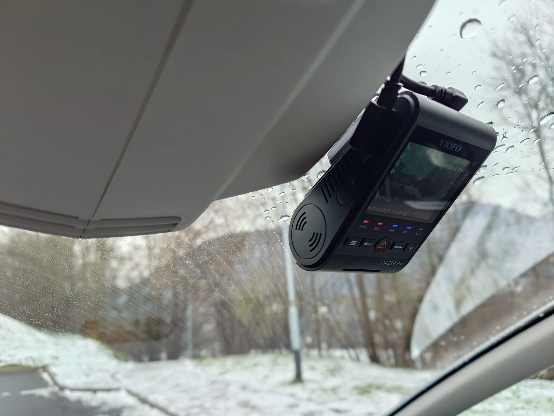

Can you mount the GPS module a little further away from the glass? Maybe on the car sensor pod, or maybe just put two layers of sticky pad on. That may be the difference to the A119.
These windshields that block radio waves often have an area that doesn’t block signals.

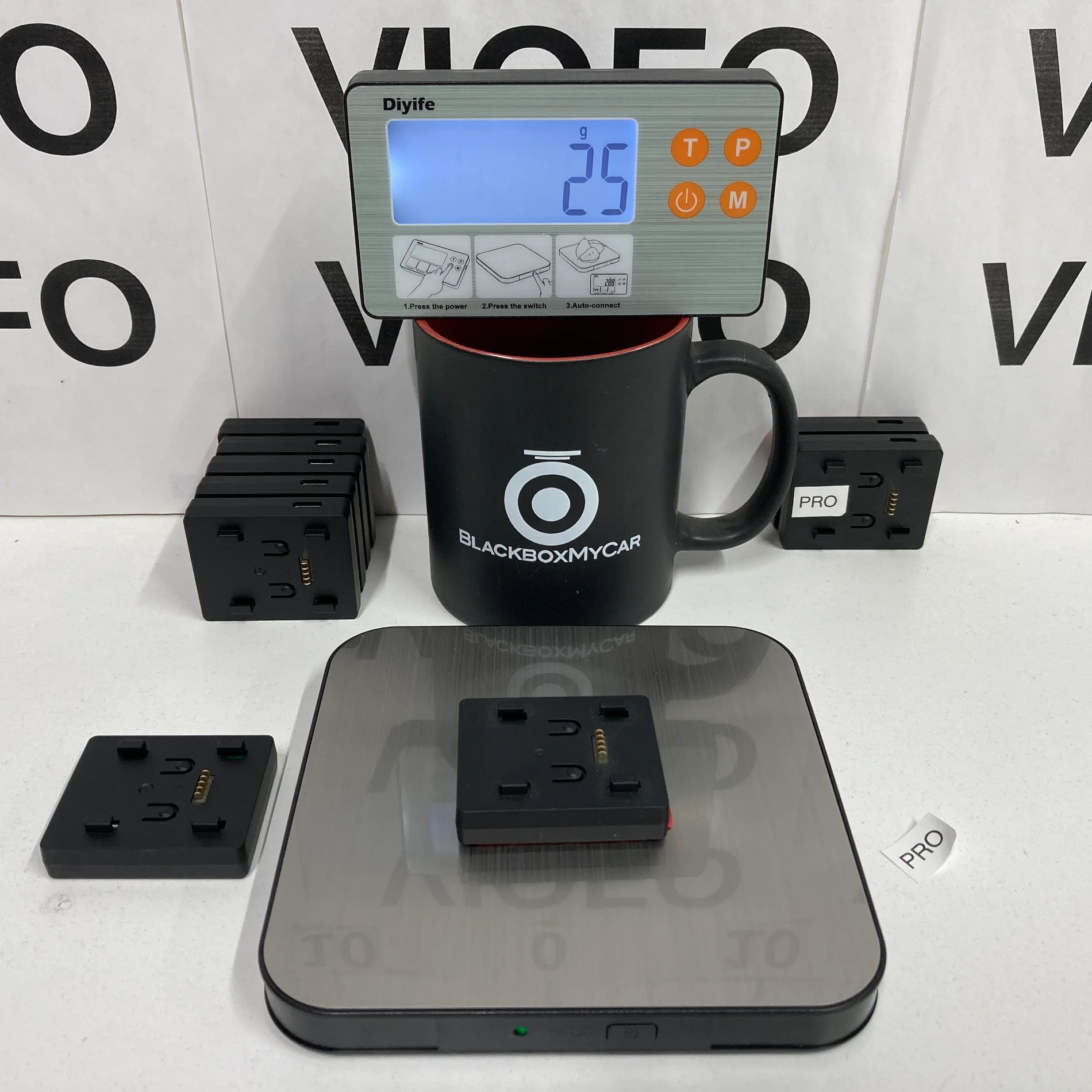

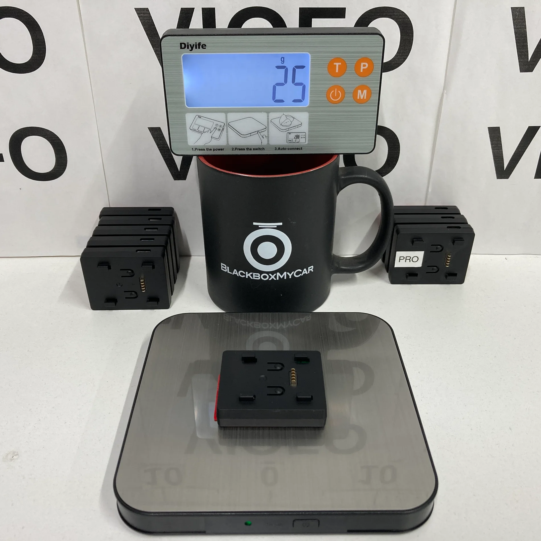

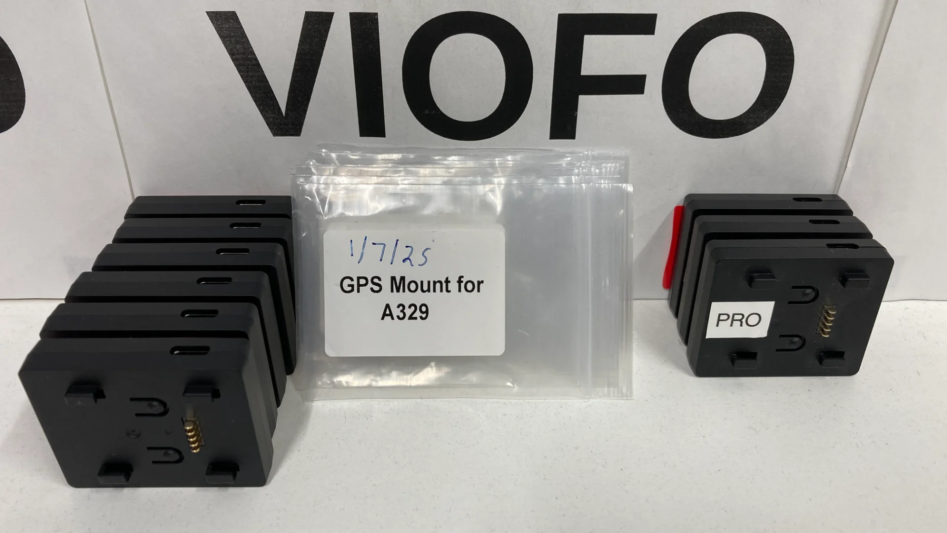

I received my (6) replacement A329 GPS Mounts today for my (2) A229 Pro Units, and (1) A229 Plus Unit.
Q: Why 6?
A: 3 for mounting inside car, 3 for test rig / bench testing.

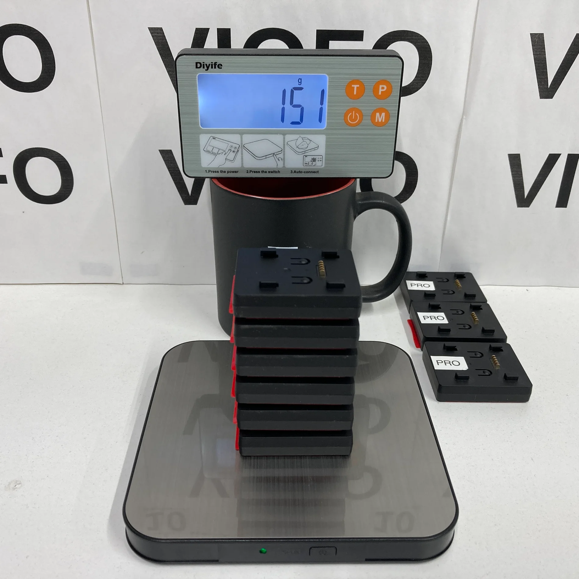

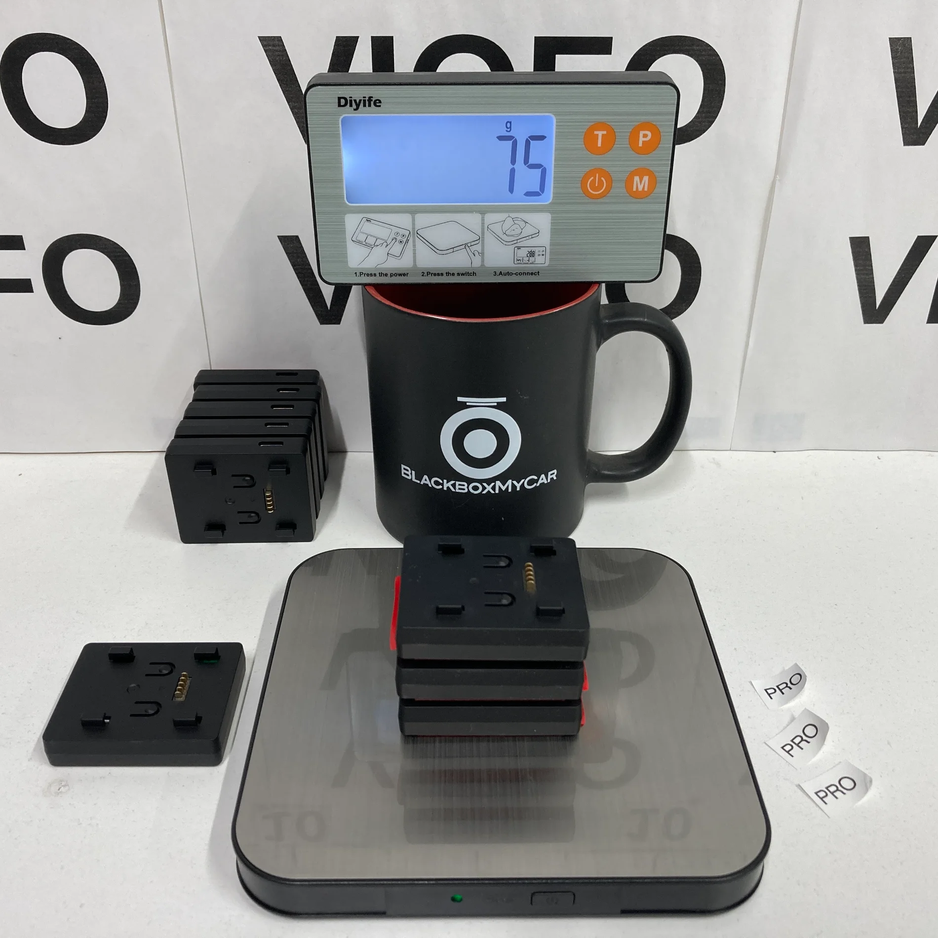

I used my $15 cheapo scale to weigh the mounts;
https://www.amazon.com/gp/B0DCFQ9XH1
Each GPS Mount weighs 25 Grams.
However, (3) A229 Pro Mounts total 75 Grams, and (6) A329 Mounts total 151 Grams.
I guess I need a more expensive scale with higher resolution.
Or, my scale is not accurate.
Now I just need to remove the original GPS Mounts for my (2) A229 Pros, and (1) A229 Plus, and install the new A329 GPS Mounts.

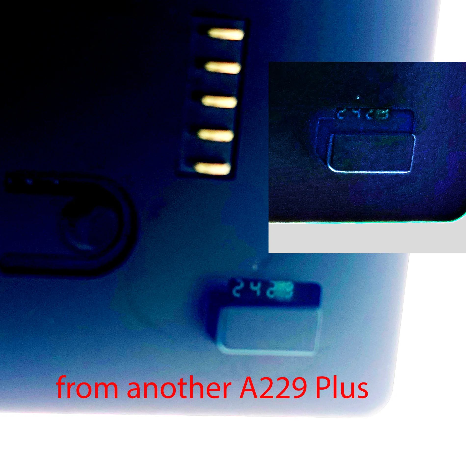

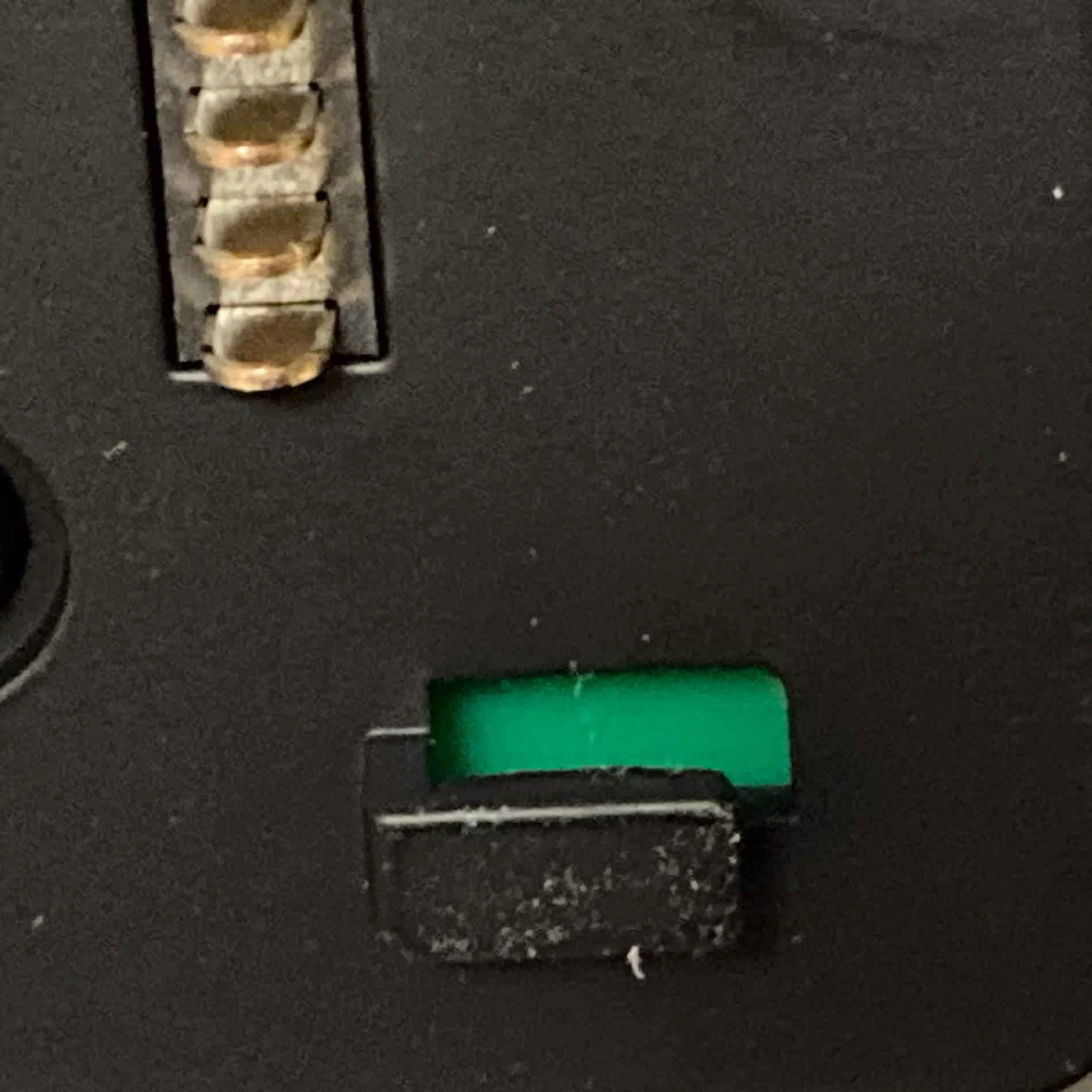

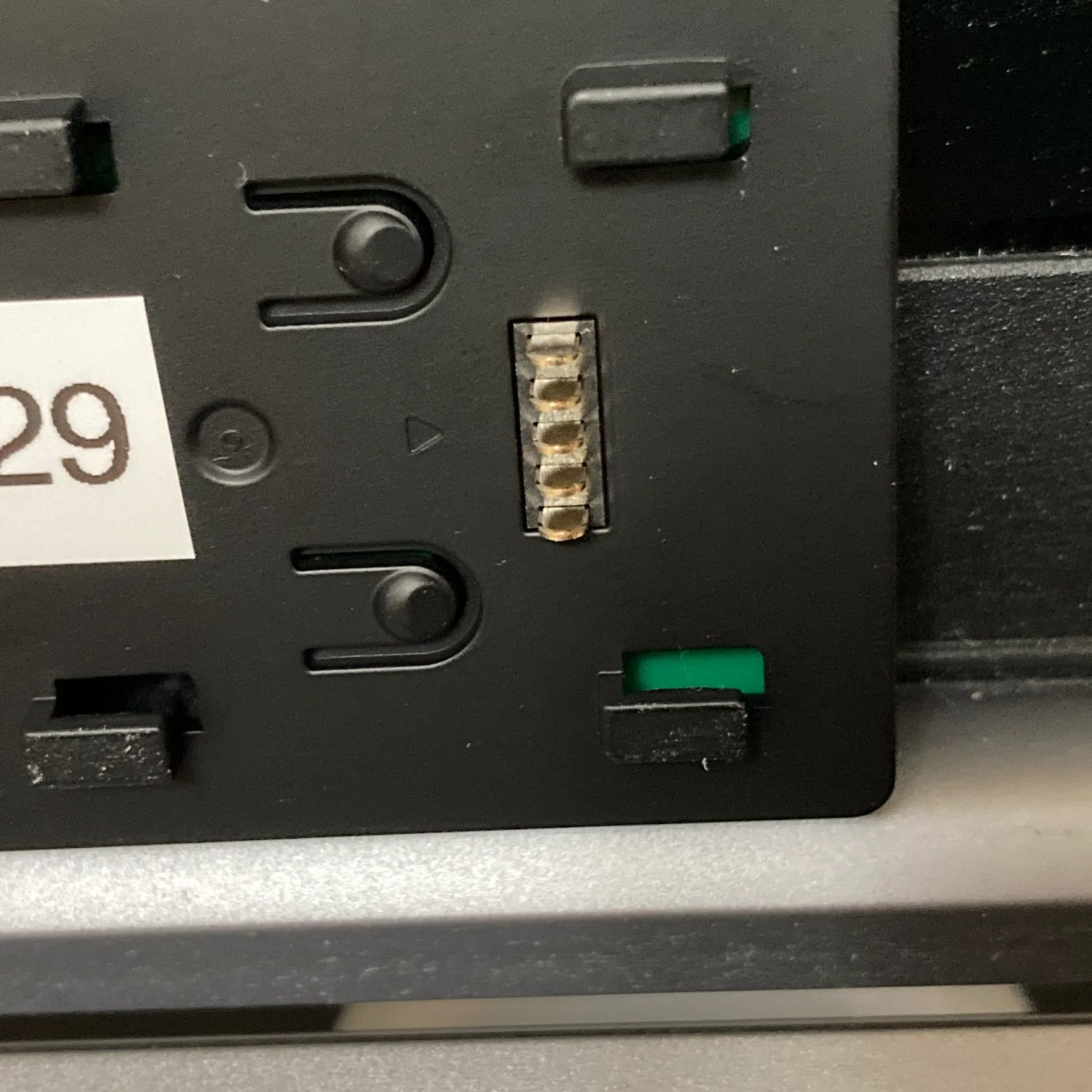

Out of curiosity - what are the markings of the plates inside A329 modules, see my last post?
Nothing, they are all blank.

Thank you! The first difference. Now I'm very excited to see how it works.

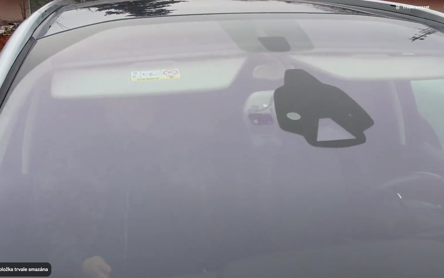

So... now I'm pretty sure, that problem is in athermal windshield, maybe in combination with a larger and heavier camera in comparsion to A119 v3. So the GPS modul is shielded from both sides :-( I recorded this video which makes it clear:
The free camera had a GPS lock in the dotted part of the glass within seconds, firmly attached camera in about 20 minutes. Loses of GPS signal through the windshield with athermal treatment is clearly visible.

Why not mount the camera in the dotted area, where there is a good signal?

Because in this car is dotted area almost level with the roof and above the sun visor (there is approx. 2cm space between glas and sun visor so there is not space). Also dotted area is out of reach whippers (more than 25cm). Current location is highest possible possition for good view)... :-( On last photo from video are the sun visor closed so you can notice the distance between dotted part and camera.
