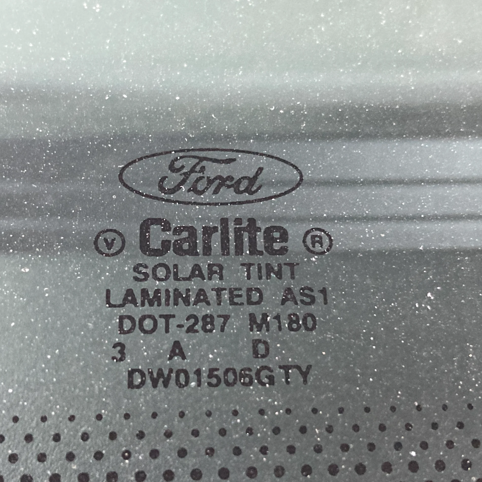

Cause of malfunction is heated windshield metallic signal interference.

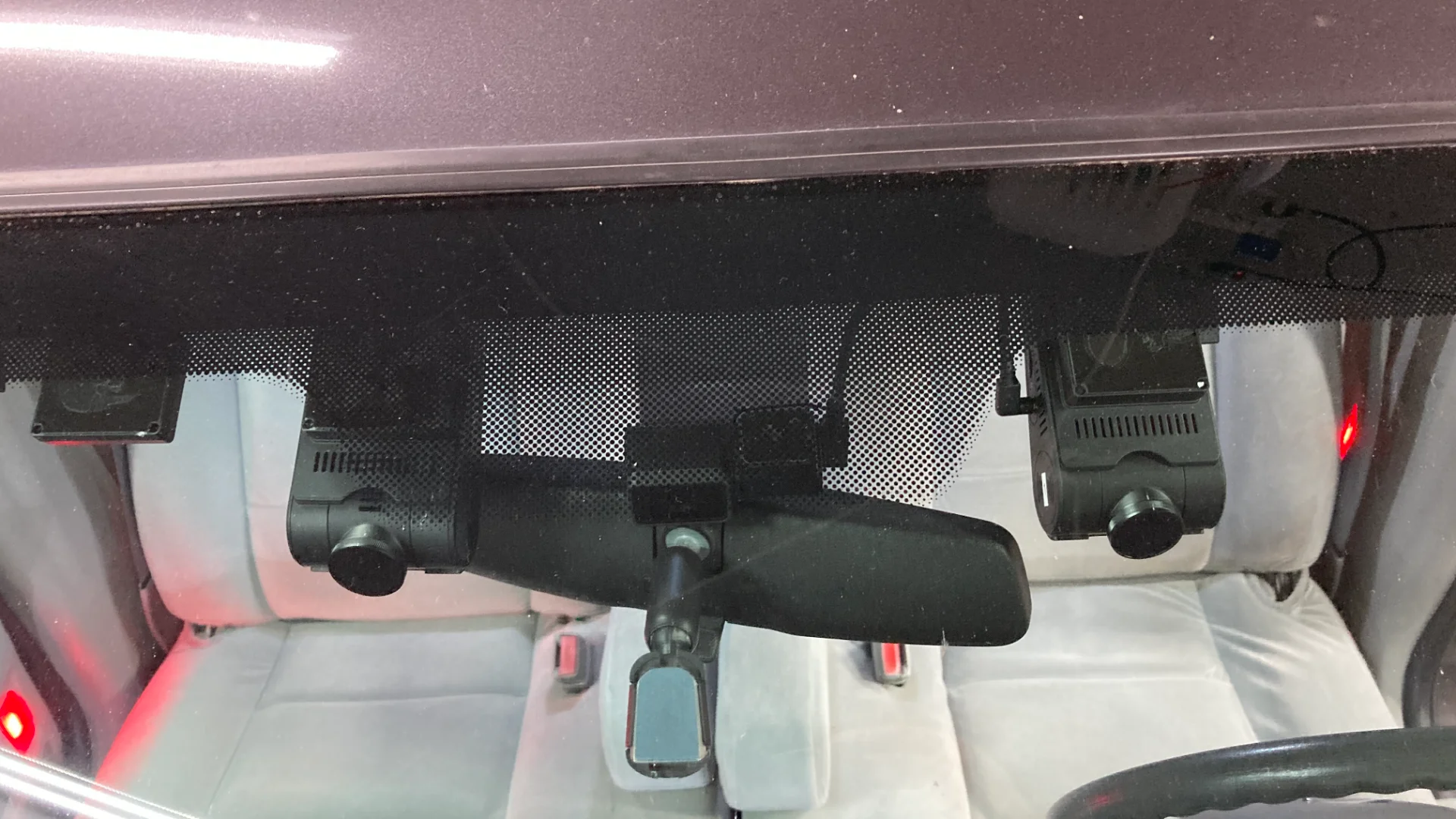

I just got done removing the original A229 Pro GPS Mounts, and installing the new A329 GPS Mounts on my windshield for my (2) A229 Pro’s.
So far it’s not looking good.
After 15 minutes of watching the blinking blue LED GPS status indicator, and the GPS icon on the LCD screen my (2) A229 Pro’s did not obtain GPS signal.
During the 15 minutes I performed a factory default reset, put my settings back in, and did several power cycles.
After the 15 minutes was up, I powered on the A329 that had not been turned on for over a week.
The A329 obtained GPS signal after 10 seconds.
I haven’t lost hope yet though.
I have a feeling once I actually go for a drive, and get my car out of the garage the (2) A229 Pro’s will get GPS signal in a snap.
But I will also review the test footage to see if the GPS signal goes in / out during driving like it sometimes does.
Stay tuned for “driving testing” update.

But it seems, that you have A329 installed in the middle of the windshield on the dotted area, isn't it?

ok, that make sense... I wonder what will happen when the car will be out of garage...
because at this moment it is better situation for A329 - only garage door are in the way, instead A229 which has in the way garage door and probabbly metalic foil in the windshield...

I don't think Panzer has metallic foil in the windshield, very few cars have issues, the French ones seem to be worst, but it is not all of them, and some, especially Ford, have heater wires, which are not so bad but do reduce GPS signals a bit,

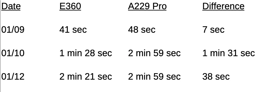

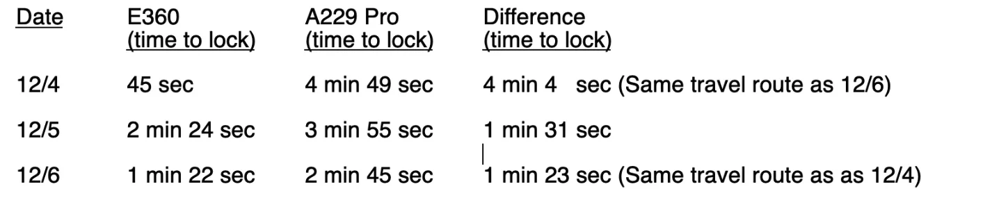

This thread got me wondering. What's the difference in GPS lock time between my Viofo A229 Pro (241024 F/W) and Vantrue E360 (2024-12-06 F/W)?
Both cameras are mounted to the windshield at the same time so in theory the time to lock should be identical.
The A229 Pro definitely took longer. I will repeat this after updating A229 Pro F/W with 241206.
I've updated F/W to 241206 and reran test. I don't think this was very conclusive, need more data points.

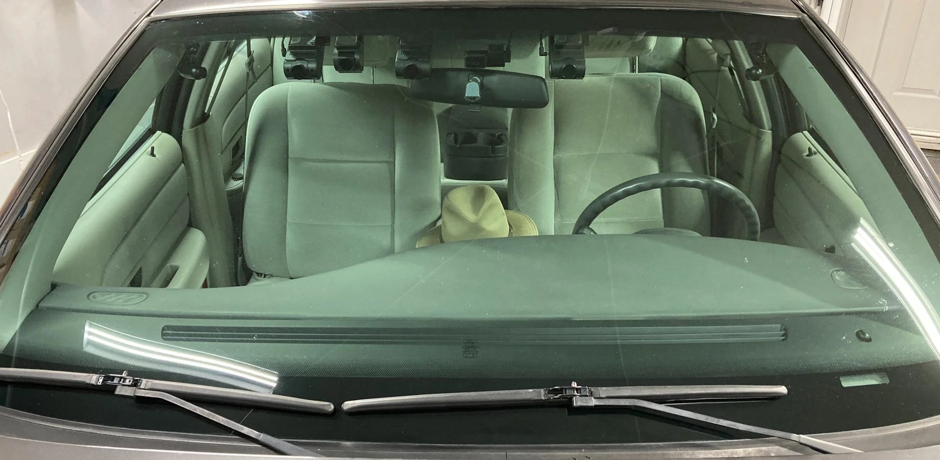

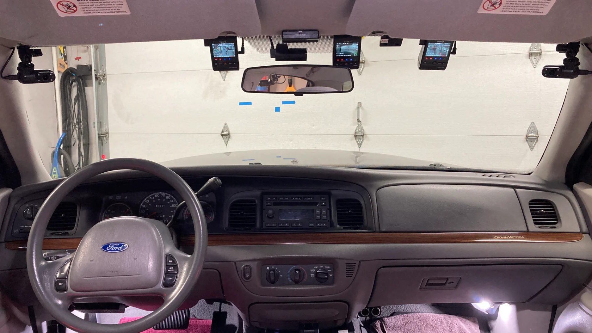

Before I removed any cameras for swapping locations I powered them all on, and guess what?
They all got GPS Signal in 10 seconds. lol
I guess the satellites were right over my house?
See attached photos.

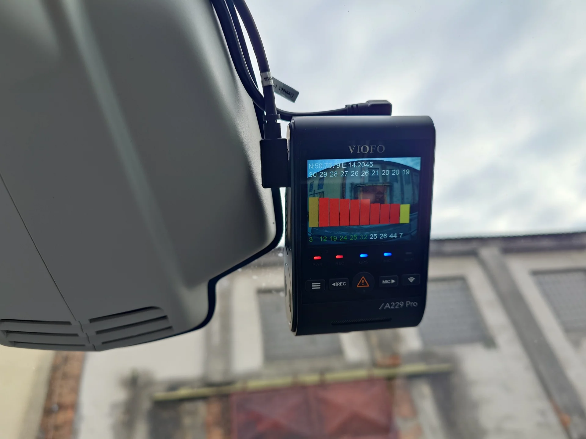

If you test the dashcam outside of the car, the GPS signal is better or not?
I once carried it in the side pocket of my backpack. With external power from a power bank since the firmware update. It detected its location within 1 minute and did not lose contact with satellites during the whole hike. But in the car the situation is “floating”. Here is from my last trip:
Outside the city, when the interference of the GPS signal was left behind, it suddenly determined its location and did not lose connection for 300 kilometers. I stopped at a gas station. But after the start, it still did not catch the signal again and for the next 200 kilometers I drove without GPS, although on the phone and Radar-detector the connection was stable.
I have a suspicion that if I carried it in my side pocket regularly, the connection would “float” the same way.

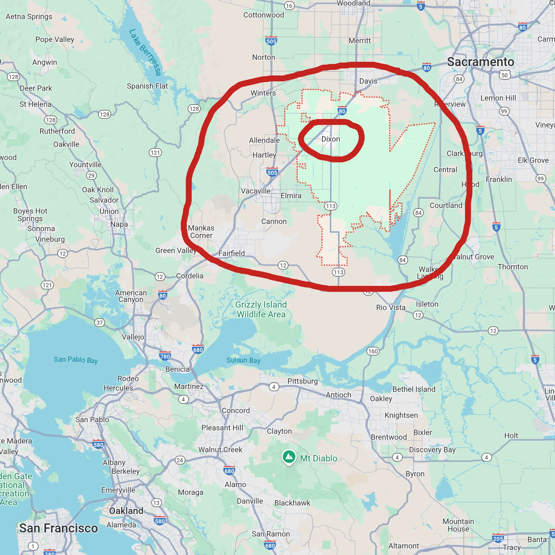

I believe my issue may be possibly caused by my location to the satellites, or any other “skyward interference”.
I live next to Travis Air Force Base, and a few other major airports.
I have almost constant air traffic (military / civilian) over my head.
3.) I think it’s going to be impossible to 100% accurately diagnose my malfunction without specialized equipment so I can see all the satellites above me with their signal strength.

It's still possible the malfunction is caused by my location to the satellites, or interference from the military / commercial air traffic above my city see attached map.
I live in an area with almost constant air traffic, especially from Travis Air Force Base in Fairfield, CA.
