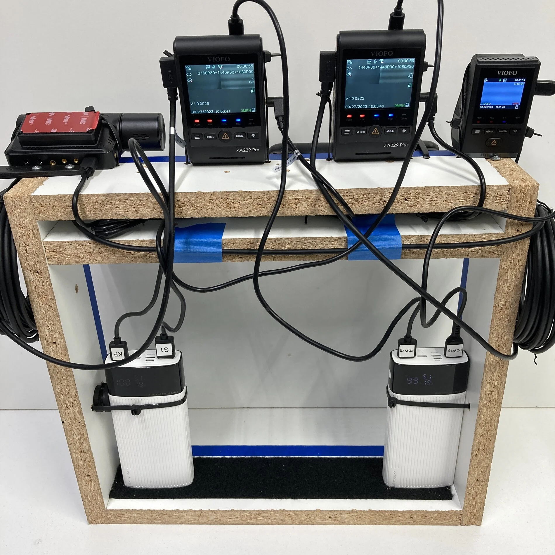

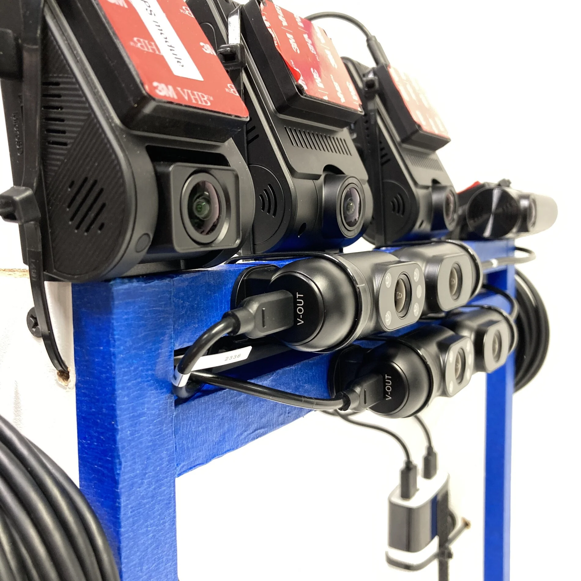

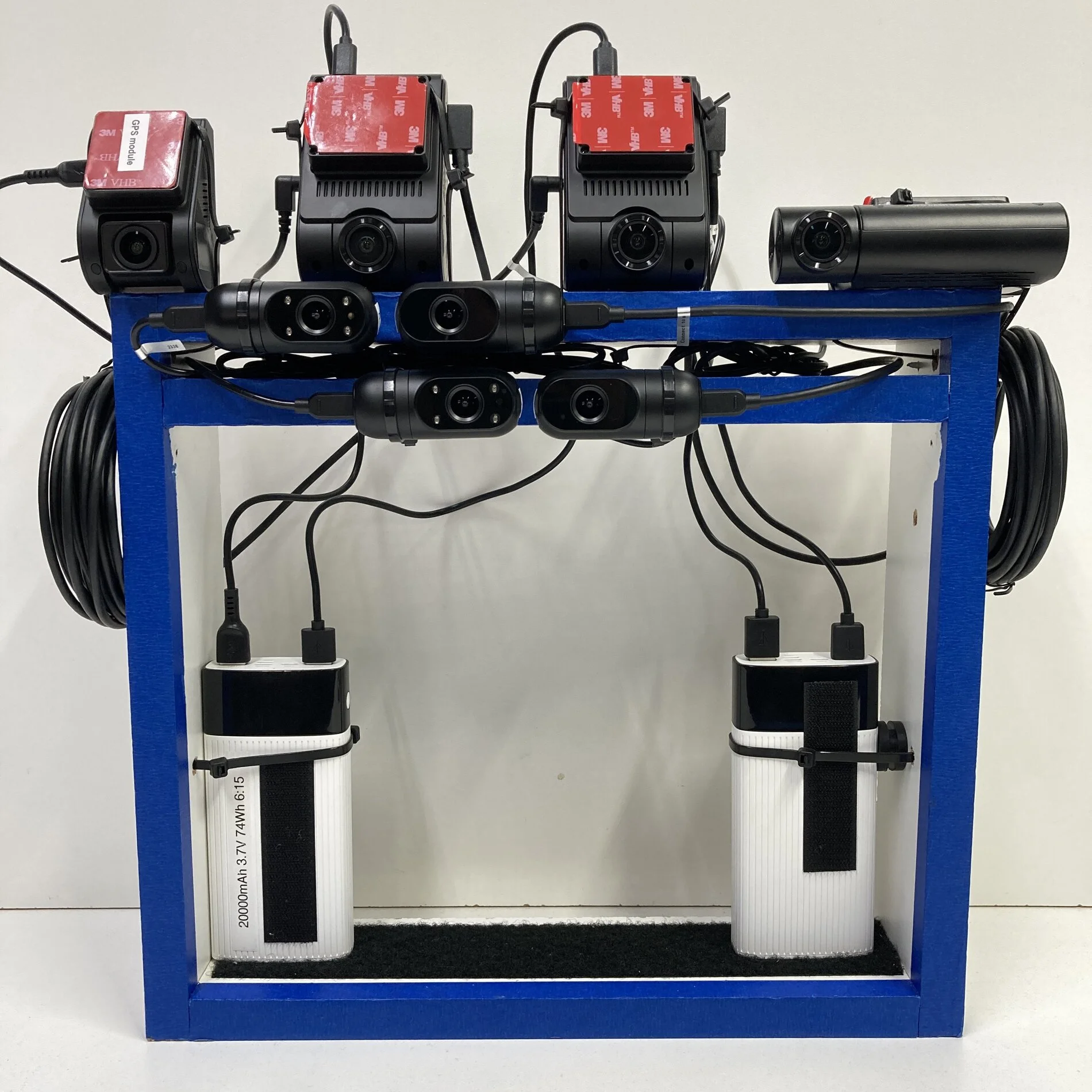

Let’s get ready to rumble.
I just got done reconfiguring my scrap wood test rig.
I felt a sigh of relief getting the Vantrue S1 Pro off my rig, and some “real” cameras on for testing.
A229 Pro 3-CH ...Novatek 96529 (IMX678) + (IMX675) + (IMX307)
A229 Plus 3-CH ..Novatek 96580 (IMX675) + (IMX675) + (IMX307)
A139 Pro 1-CH ...Novatek 96687 (IMX678)
A119 Mini 2 .........Novatek 96580 (IMX675)
Sorry @Jeff_Vantrue but based on what I’m seeing Vantrue is just not ready for Prime Time yet.
The first order of business is to check cold & hot focus to make sure the cameras don’t lose focus after getting up to operating temperature after running for a few hours, so we can avoid the debacle of the A119 Mini 2.
Right now the A229 Pro & A229 Plus are cooking.
In a few hours I’ll take some thermal photographs to check for any differences since they’re now both at the same ambient temp.
Place your bets, how much cooler do you think the A229 Plus will be compared to the A229 Pro?
My guess is 15℉ (9℃) degrees cooler.

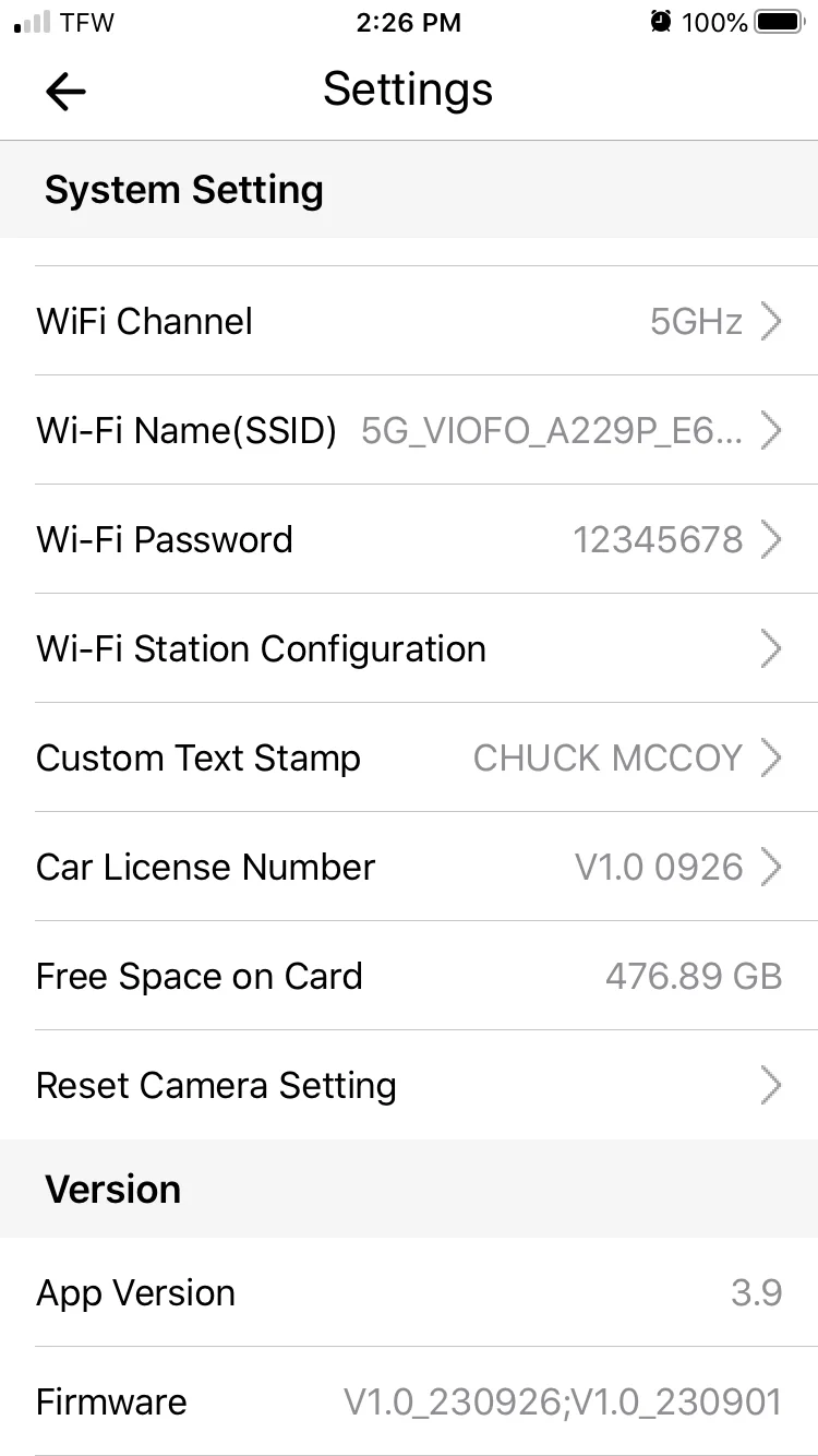

Boy, do I love the voice commands for turning On/Off the Wi-Fi it sure comes in handy.

Throwing wild guesses out there but 7 degrees Celsius cooler. Loving the rig!

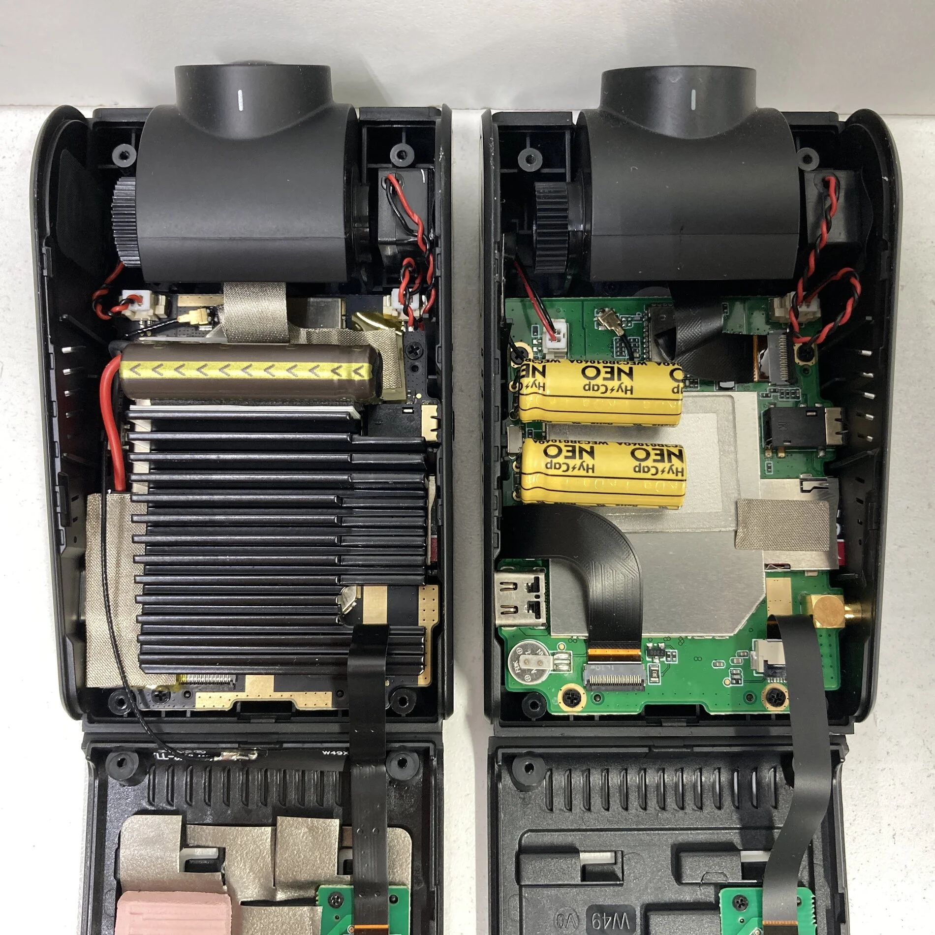

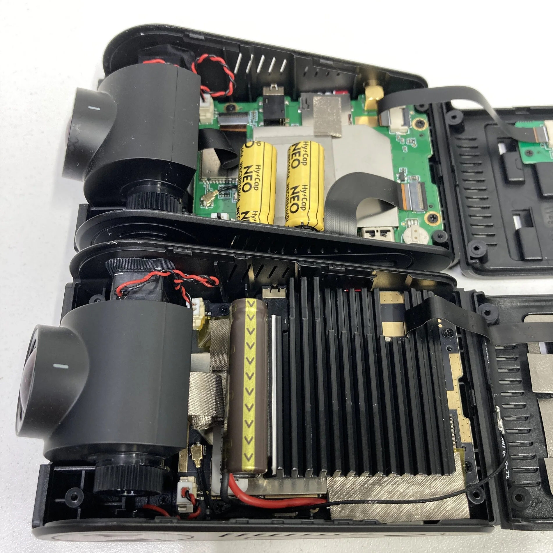

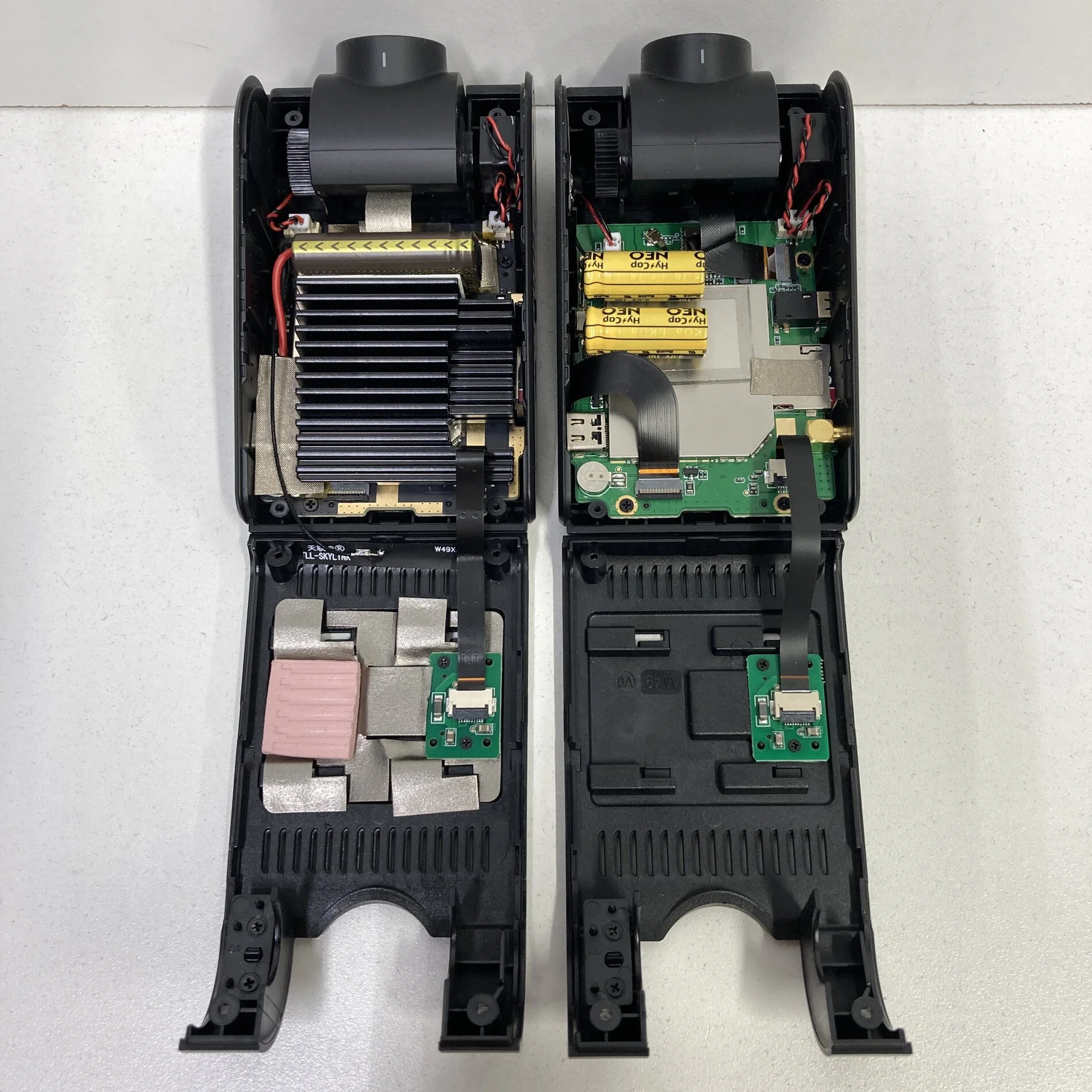

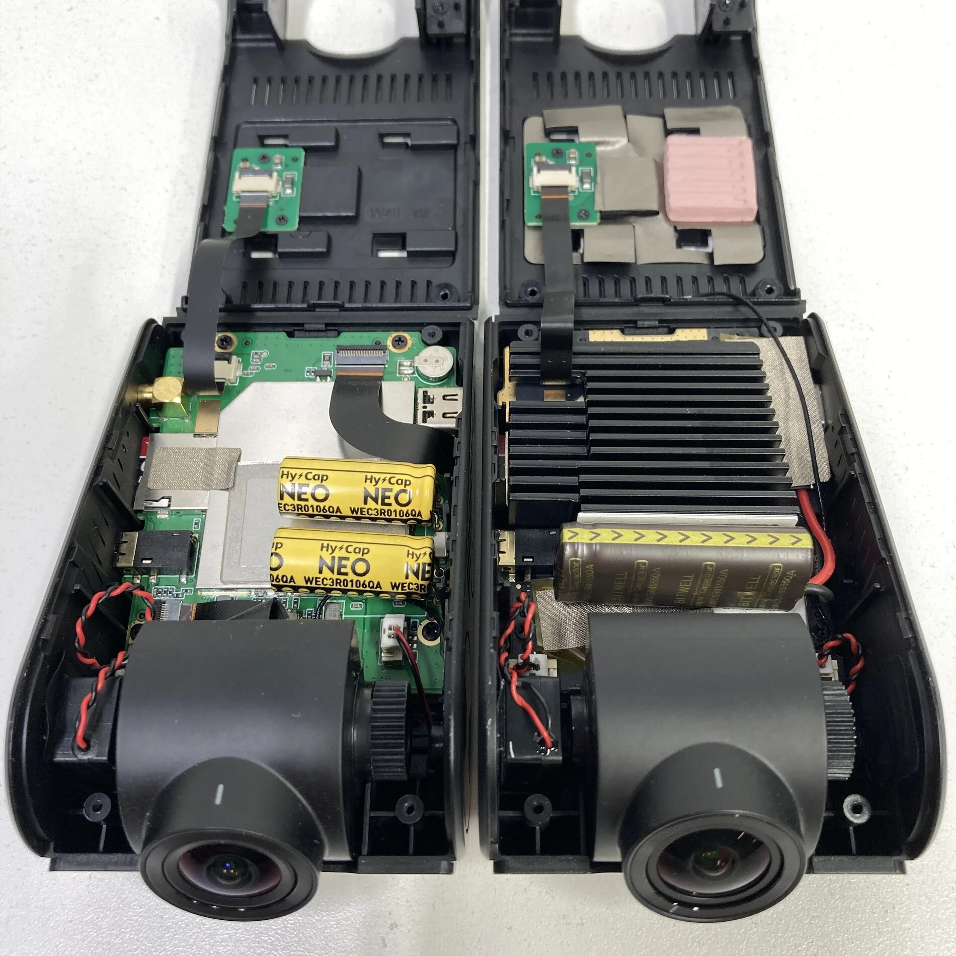

@LateralNW @Agie

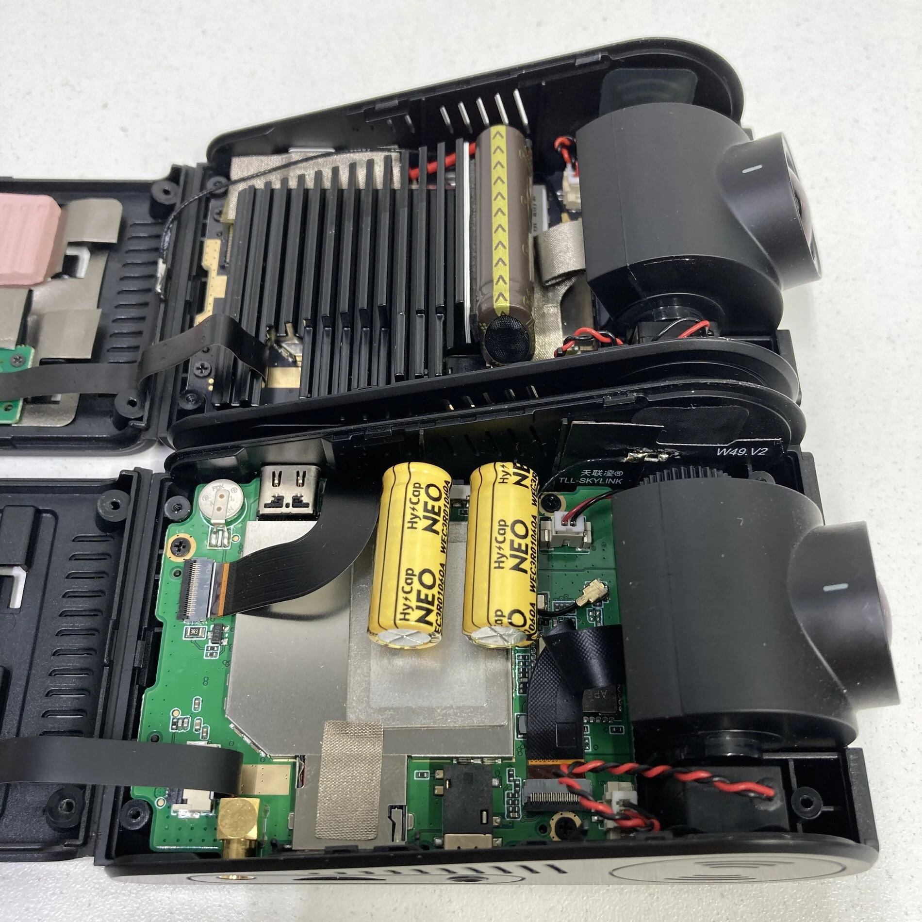

Well no wonder the A229 Pro weighs 1 oz. more than the Original A229 Duo.
They installed a huge 1 oz. heat sink.
Geez, that thing looks massive.
This was my first time taking apart a Viofo dash cam, and I’m kind of impressed how sturdy the components feel, and the screws have “precision” feel to them.
I’m almost sure I can put them back together without any damage.
Oh yeah, it looks like they relocated the Wi-Fi Antenna.
Thanks for photos it's quite telling.
At first I didn't realise your photos are of two different A229's
Very clear photos nice work.
That heat sink and its position and shape is very telling the work Viofo have put into the A229 Pro.
Your photo looks like it answers my question about some form of heat relief for the sdcard. It looks like the heat sink covers the card which is a clever economical way to help reduce heat stress I expect.
The capacitors while I can't read the values look like they maybe the newer 5.5v caps and the length might also mean larger capacity. This could show up when the power is removed you'll notice the Dashcam will take just a little longer to shut down.
in your photo 2.jpg it looks like either the backing plate is covered with emf shielding or maybe a form of heat shield to protect or prevent the gps mount interfering with the internal or vice versa.
These photos make me think this Dashcam will be the new standard that others try to rise too.
Cheers

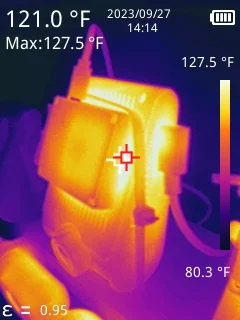

Preliminary Heat Comparison - A229 Pro vs. A229 Plus
Garage Ambient Temp: 80℉ (26℃)
Cooking Time: 3 Hours
Normal Recording Mode
Pro V1.0 0926 3-CH 4K + 2K + 1080p
Plus V1.0 0922 3-CH 2K + 2K + 1080p
Bitrate: Maximum
IR LED: ON
Pro SD Card: Viofo 512GB
Plus SD Card: Viofo 256GB
Loop Record: 1 Minute
Pro Hottest Temp: 166℉ (74℃)
Plus Hottest Temp: 138℉ (58℃)
Difference: 28℉ (16℃)

Wow Plus looking very good
Can only imagine what temps the Pro would get up to here in Australia on a hot 45 Celsius day. Throw a parked black car out in the sun on top of that....
Based on those temperature figures it's possible to get first degree burns eg superficial burns.
What's it like when you touch them?
Think they all get hot these days, it's hot to the touch for me with my Nexus 4 Pro and summer hasn't even hit yet. The hardware can handle the heat no issues but yeah some have concerns about the temperatures, which is warranted
Compared to all other heat testing I’ve done on Viofo dash cams these temps are “normal”.
We’ll have to wait till next year to see if parking mode in a hot car makes the LCD screen go all whackadoo like the original A229 Duo.

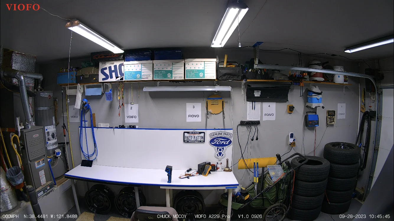

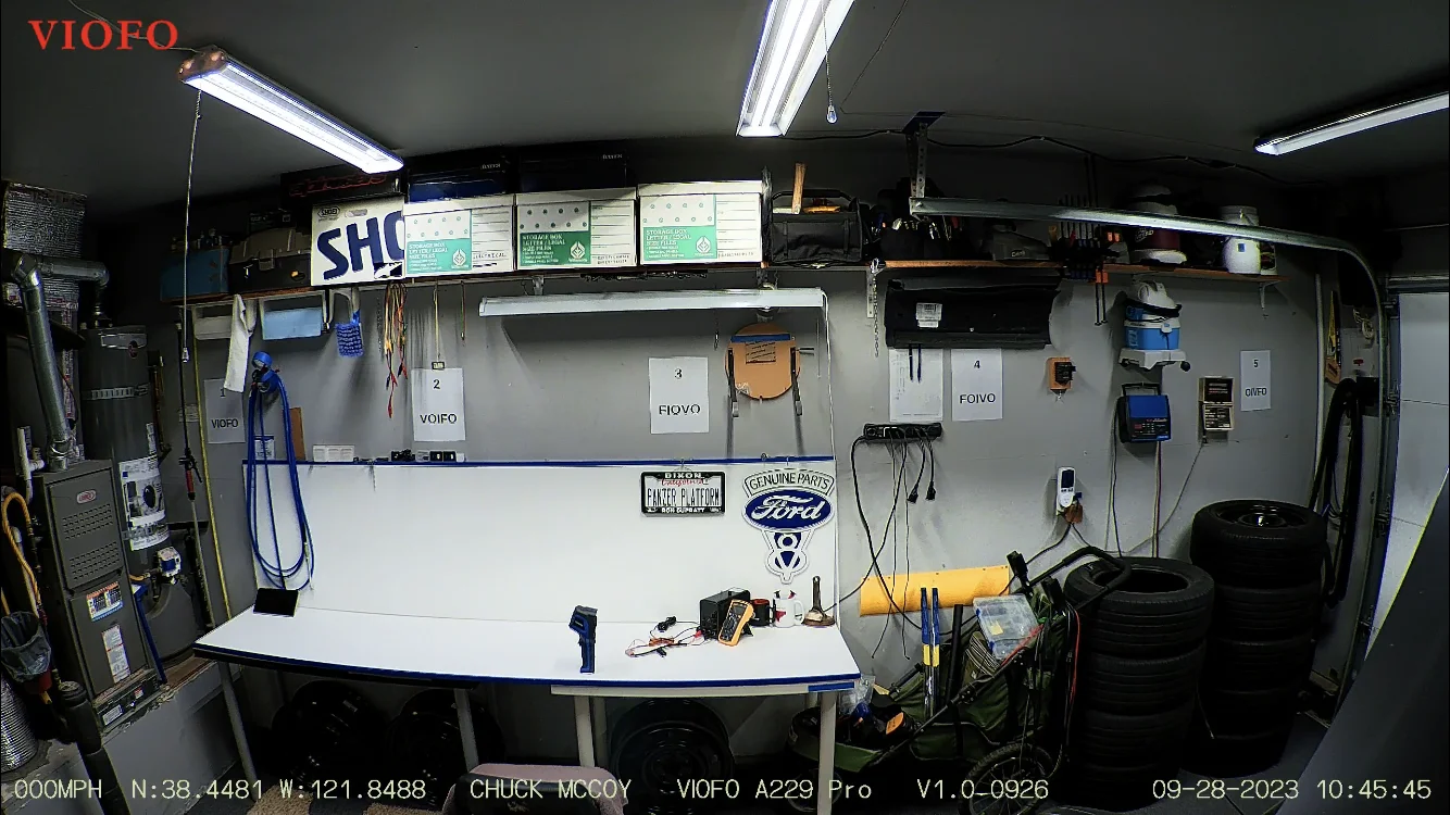

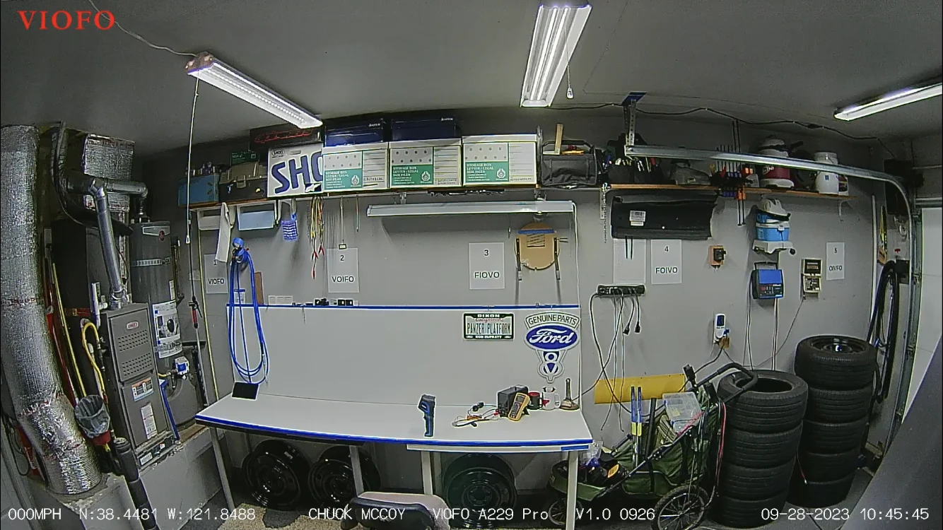

Indoor Focus Check
Keep in mind I will follow up with an Outdoor focus check.
Take note how tiny the characters are in the text overlay at the bottom of the screen on the front camera compared to the others.
I’ve been complaining about this for the past 4 years, ever since the A129 Pro Duo was released October 2019
I always get the same response from Viofo;
“The smaller character size is due to the 4K resolution.”
That answer does not make any sense to me.
Does that mean when we get 8K cameras the characters will shrink even smaller?
I’m no engineer, or computer expert but this sounds like a lazy excuse, and it will take too much time, and effort to get the characters on the 4K cameras the same size as the 2K, and 1080p cameras.

That's it, when we hit 8k, give up and get your grandchildren to read it out to you hahah
That is not entirely accurate, in fact it is nonsense. What they are saying is they do not care to do the code to scale for slightly larger, easily readable fonts. IMO
