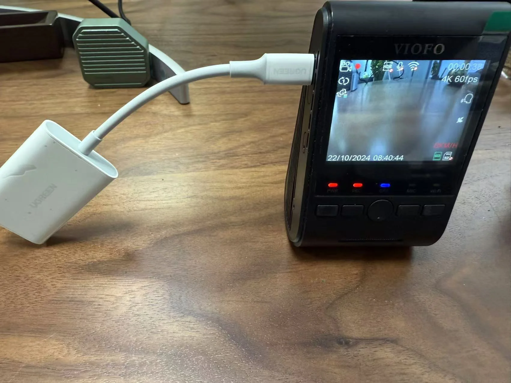

No, not the extender, I was talking about A329 with the USB-C out for remotely mounted Micro SD or SSD.
I guess the controller would be in the reader itself since the USB-C can support both the SSD and the Micro SD
Here is the link showing Ugreen card reader working with A329:
