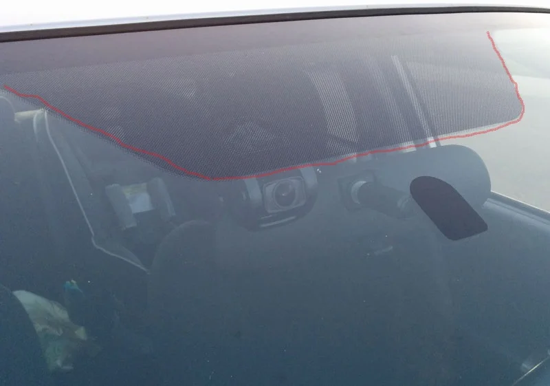

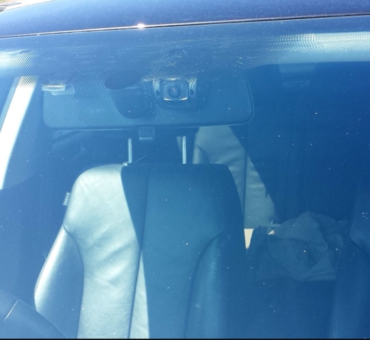

Still didn't mounted on the car - wonder myself where to place it. If is hidden behind rear view mirror, the display wouldn't be visible when driving. If is placed left on the mirror, will look a bit noticeable [emoji2]
Most cameras you don't need to see the screen during normal driving. I like to see the LEDs at the top of the camera, and I was able to mount mine so that I can just barely see the LEDs above my rear view mirror. If I ever need to see the screen, I do it while stopped, and just lean forwards to see it.
Finally, the best position will be behind rear view mirror, on the right side. So, I will only see led lights and wouldn't have problems removing the camera.
But wondering will a tape harm black dotted protection folio on the window when removing?

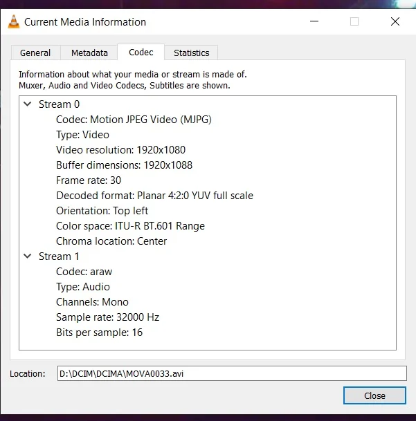

Forgot to mention that I'm using a voltmeter and USB cable for charging. Formating again the card and drive for more than an hour and everything works. Recorded files are 3 minutes long, but looks too bigger - 600 mb each.

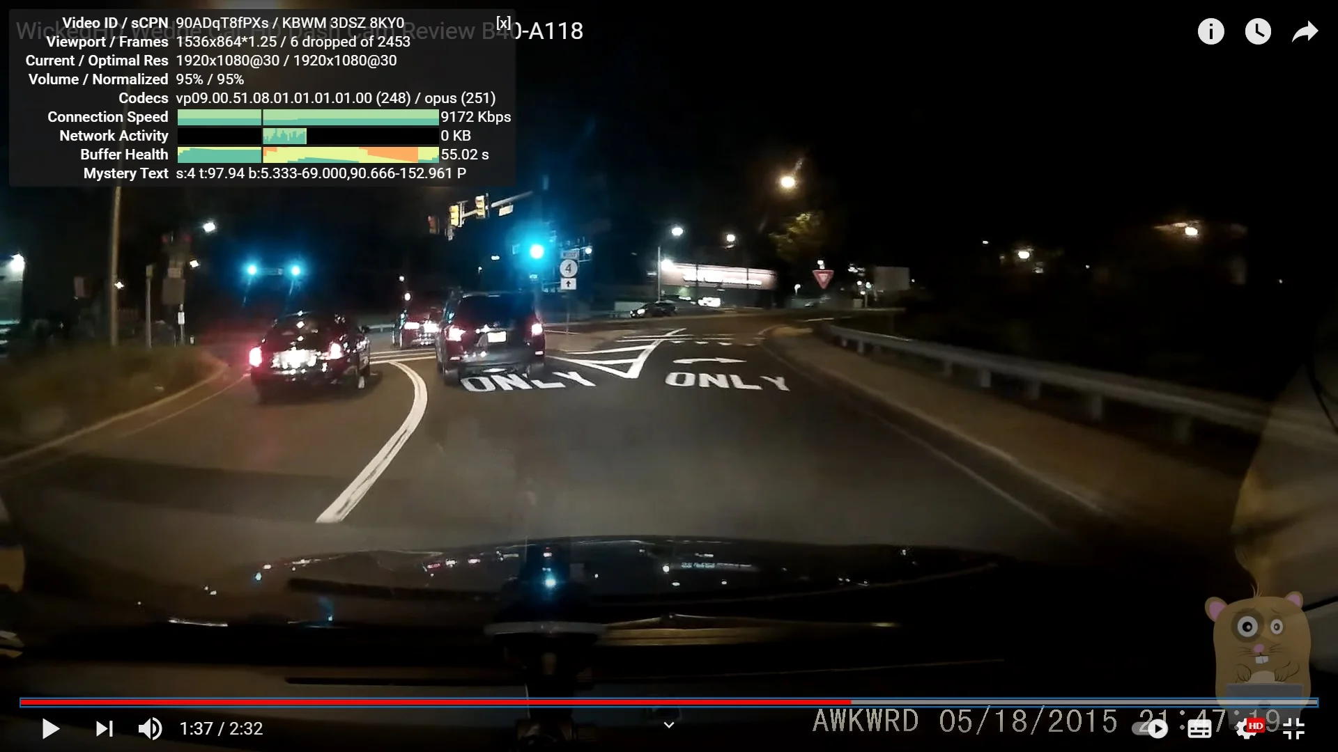

That's a screenshot from the player - does it looks well?
Cannot see the license plate of the vehicles in front of me, but on those on the left and the right - yes... maybe because of the lights.

PS - I'm attaching youtube screenshot which looks slightly clearer than mine

Maybe I've made a wrong choice [emoji849]Do you think that Xiaomi 70mai 1s will be better? It has SONY IMX 323 Image Sensor.
B40 A118 cost me 25€
You bought cheap and got the level of performance you paid for, the IMX323 will give a better result in low light, there are still better options to be had but you need to raise your budget to get there

For now my camera works, just wondering why no matter of the length, files size is 600 MB when loop recording is set to 3 minutes? 1-second file - 600 MB, 3 minutes files - again 600 MB
Have you viewed the video files both ways? If you can get the cam to record reliably all of the time I would just go with however it is which gives you that.
