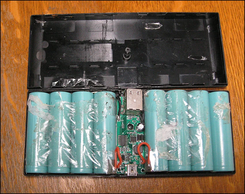

Another reason to question the capacity of the alleged 50,000 mAh power bank is it's size. In all likelihood, if you measure how many 18650 cells would fit inside the case (plus some space for the pcb and other components) you'll find that it would hold eight cells. With eight 2500 mAh 18650 cells you'd have a 20,000 mAh power bank. I suppose it could have 3000 mAh cells yielding a 24,000 mAh power bank but at that price they may be even lower capacity cells than 2500 mAh or perhaps of questionable quality (or both).
Amazon banned most power banks that claimed 50,000 mAh after receiving many complaints.
physical size is usually a giveaway
As mentioned, typically this type of power bank holds 8 18650 li-ion cells which interestingly is a holdover from their original heritage as laptop battery battery banks. Somewhere along the line someone realized that old school 8 cell laptop batteries would make for a great stand alone product and the power bank was born.
BTW, this particular battery bank, (purchased on Amazon) was billed as having a capacity of 50,000 mAh but it is very likely 20,000 mAh.
If you're lucky, a lot of the cheap ones don't even use 18650 cells
Some of these cheap banks have 18650 cells but they are of highly questionable quality. Best to buy from a reputable brand now that we have some good companies in the business.
The one in my photo is interesting. It was purchased on Amazon for 22 dollars and it was billed as having a capacity of 50,000 mAh. I bought it expecting about half that and that wasn't too far off. I believe it to be 20,000 mAh with eight 2500 mAh cells, The bank has performed superbly and is about three years old with plenty of life left in it. Unfortunately, it developed a connectivity problem with one of the USB ports which led me to recently take it out of service and at this point I intend to salvage the cells for another purpose. It owes me nothing.
I have an identical power bank which has been in almost daily hard service in my truck and is nearly four years old (in March) and still going strong. It's showing a mild deterioration in charging capacity but is nowhere near end of life.
These were generic power banks that sold on Amazon under different names but were all manufactured by a company named Ecptek in China that was known for manufacturing some decent quality battery products. It's unfortunate that they felt the need to slap a 50,000 mAh label on the thing which eventually got them banned from Amazon because in this instance they built an excellent quality product which sold a very attractive price.
