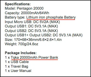

Are these Lithium Iron Sulphate? If so, what sets them apart from the Tqka unit I'm awaiting, apart from capacity? Electronic wizardry I guess?

The battery in David's link is indeed Lithium Iron Phosphate. (not sulphate (sulfate) )

The Tqka lithium iron phosphate power bank arrived yesterday, as purchased here: https://www.amazon.co.uk/gp/B073QQPKVY
I note it was designed in the UK. Anyone heard of Welsky?...
Otherwise, it works, fits in my armrest, fits in my glovebox, fits in the map storage net by my under-dash 12v socket, and fits the bill of what I need for parking protection. I think I'll take my front A119 power cable back to the armrest (12v socket in there) which will make it easier to switch from car power to PB power than messing around in the glovebox.
