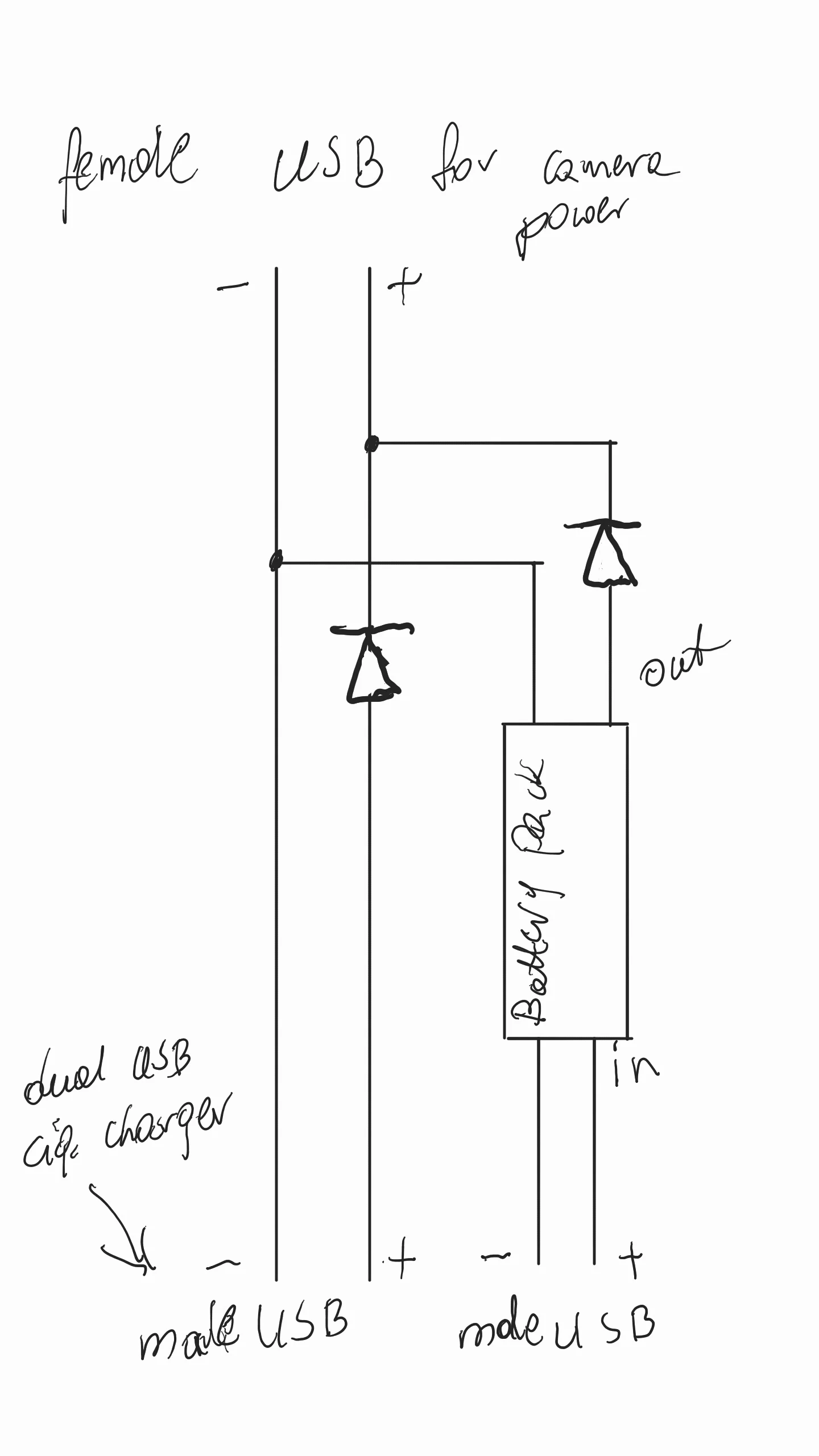

I was thinking if that would be possible use normal dual usb cigarette lighter phone charher, 5V battery pack, and couple modified cables to power dashcam in parking mod . In my car cig. lighter is only powered when car is ON. My idea is to use dual usb high output phone charger to power battery and charge battery bank at same time. With car OFF the bank would power camera while in parking mode. Can someone with more knowledge than me verify if that would work before I buy and destroy few cables?

Ebay has Dual USB in , one USB out plugs ... No need to butcher anything .
