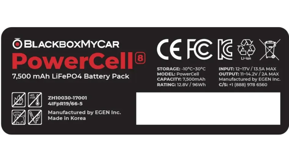

The reason I brought that up is that I've been following a competitive LiFePO4 product (not made by EGEN) for a while now. It has this feature and advertises it.
Would like to know the charging temperature and discharging temperature limits. The website seems to list storage temperature:
Lithium batteries should not be charged below freezing. I'm wondering if there is some built-in protection to ensure that does not happen. There are many times when we get below freezing in the Winter here, and I'm sure that is the case in Canada as well...

Here is where I found the operating temperature spec.
If it is charging below freezing temperature then this will reduce effective capacity of the unit and is not good for longevity. Lithium batteries should not be charged below freezing.
There are 2 ways to avoid this:
Either have Low-Temp protection where it does not charge at all below freezing, or have some kind of "self-heating" or "built-in heating" mechanism that will let it charge under freezing conditions.
That comment is not really specific as it cites "operating" temperature...The question is how is it operating under freezing temperature.
If it is operating (discharging) under freezing and also will not recharge, that is okay.
If it is operating (discharging) under freezing and also recharges under freezing, that is NOT okay unless it has some kind of "self-heating" or "built-in heating" mechanism that I mentioned.

I agree with you 100%
