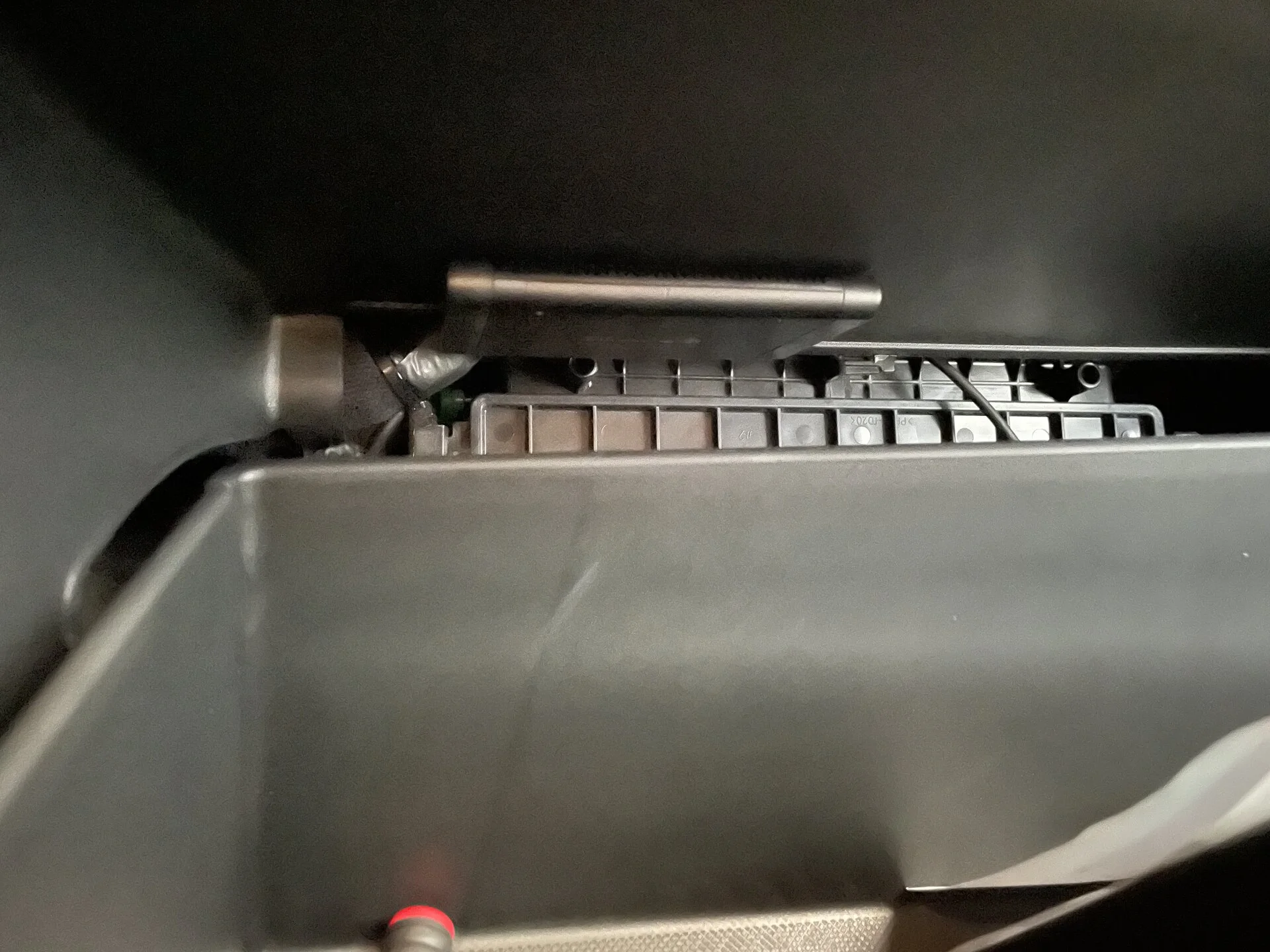

With your (very cool) RD/Camera setup, where the heck are you gonna put that module?
I think I am going to tuck it in the headliner.. Should not really effect reception much (or at least I hope not).. If not then I'll need to find a hiding spot for it as I am NOT sticking it to the windshield...
My 2nd option might be to run the cable along the headliner then down the trim to the glovebox area or fuse box area and stick it somewhere there out of sight..
I'd like to be able to access it in case the SIM card goes bad or whatever.. I also wonder if tucking it in the headliner will cause heat issues.. If I can't hide it, then I won't be using it and my search will continue...

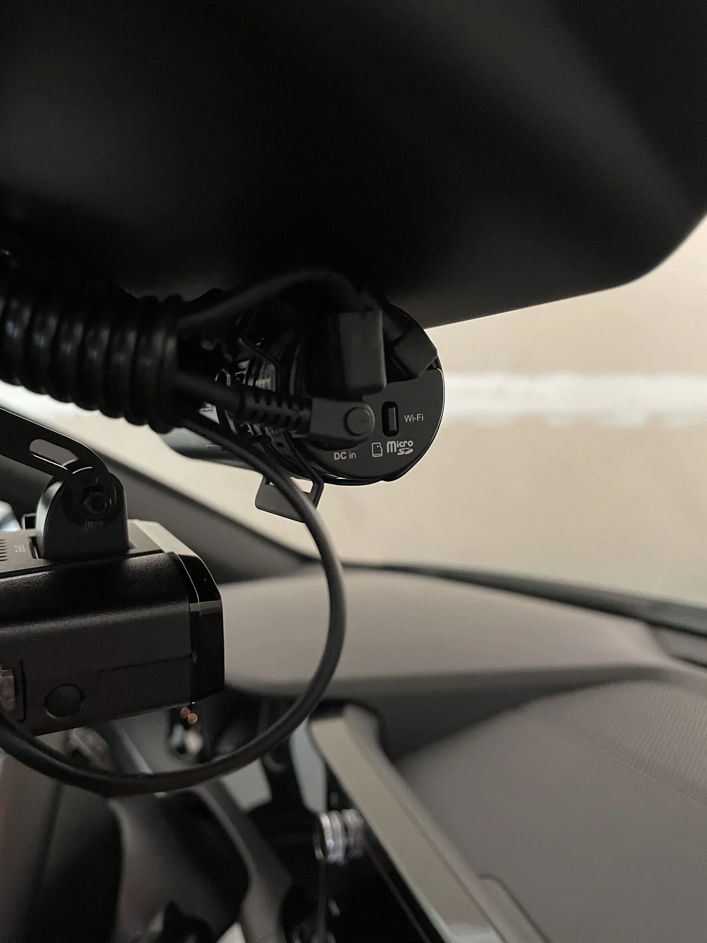

Got it installed and operational. I used a T-Mobile pre-paid SIM card for data only and went with the 5GB plan for $20 a month. I may downsize that after I see how much data the camera and radar use. I did not enter any APN info for the SIM and just left everything blank.. Connected to T-Mobile almost instantly and has held data connection all day..
I ended up putting in the glovebox area. I tested it on the windshield and where I have it in the glovebox area and didn't see any degradation in reception strength..
My radar detector connected to it just fine and it auto connects each time it turns on.. When the detector turns off (when car is turned off) it disconnects from the WiFI hotspot allowing me to connect to the camera using it's WiFi for the BlackVue app if I want...
You might have to zoom in on the 2nd photo to see the module. Taking a photo of it was difficult.. I left enough cable to where if I ever need to access the module I can just take it down (secured with the 3M double sticky tape) and I'll have access to the SIM card slot..
