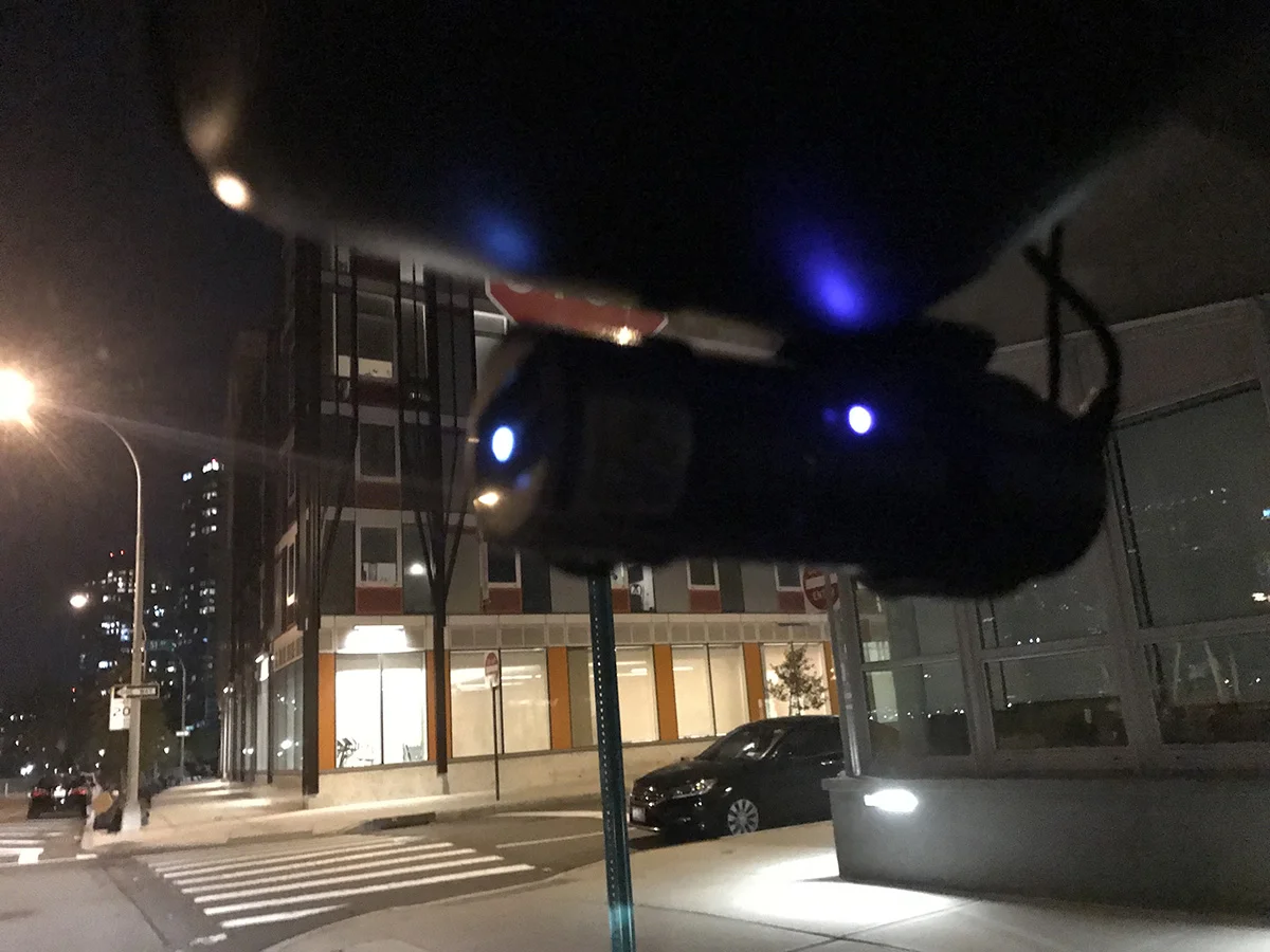

*** This is a long one and I apologize, but I wanted to include as much info as possible. Here goes! ***
I installed the Blackvue in my 2017 Toyota Highlander with the Power Magic Pro (PMP); firmware updated in July.
Early November I noticed the camera powers down 10 - 15 minutes after entering "parking mode."
The PMP's voltage and timer DIP switches are set for 12V and infinity, respectively (1= OFF, 2 - 5 = ON).
The config file shows that the LED's are off and WiFi auto on/off is disabled, yet as you can see in the image, the WIFI LED is still ON.

Hopefully someone can help. Can't seem to figure this one out. The vendor initially ignored my emails and after contacting BlackVue, I'm disappointed with their helpdesk. They want to pin the problem on the power cable feeding the camera or the PMP.
This only happens during parking mode - when the car is parked! If it was a loose power cable, I'd have random shutdowns while I'm driving.... Duh!
Any help would be appreciated.
Thanks!
Raphael
