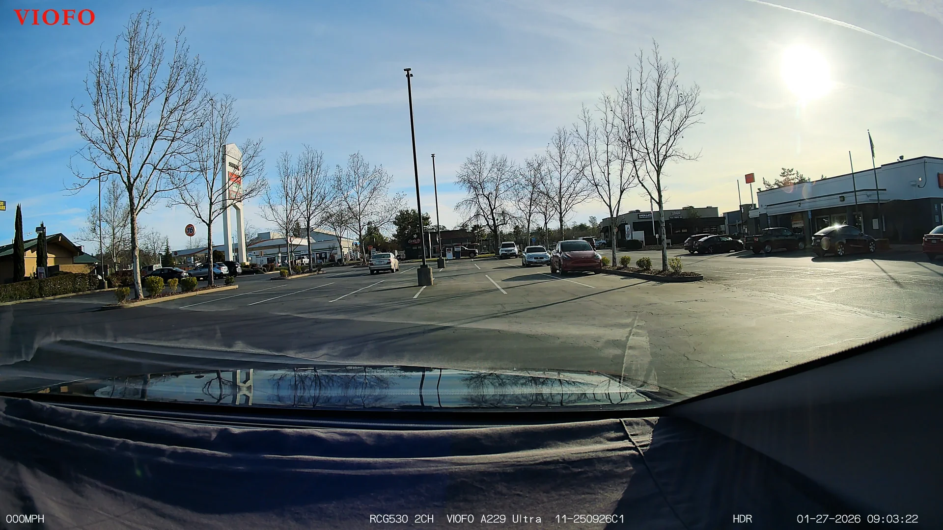

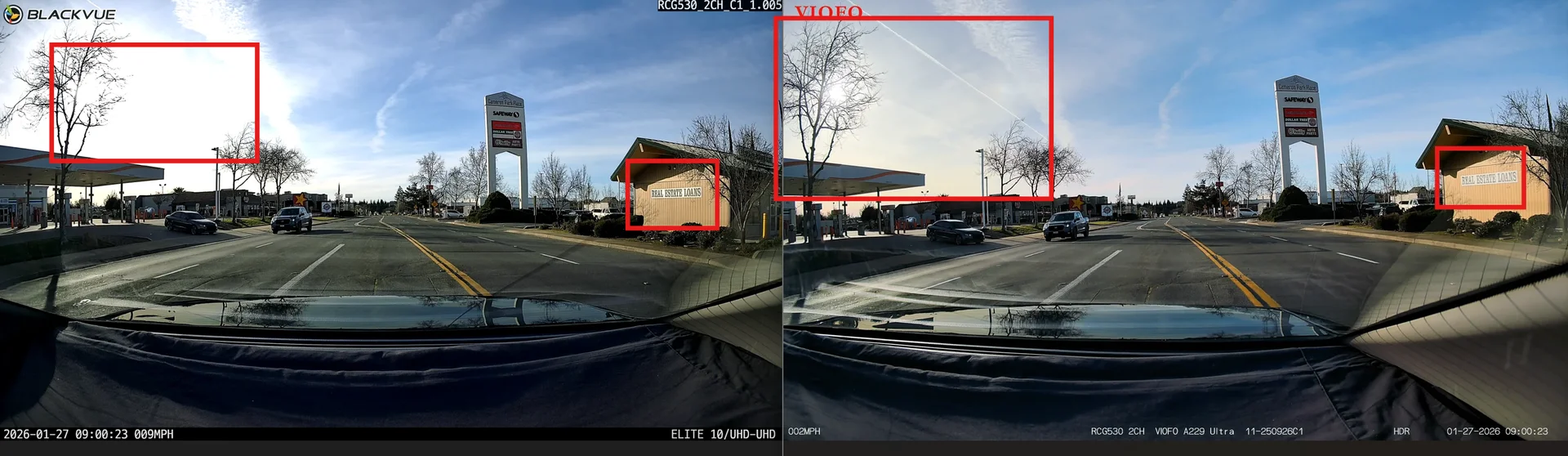

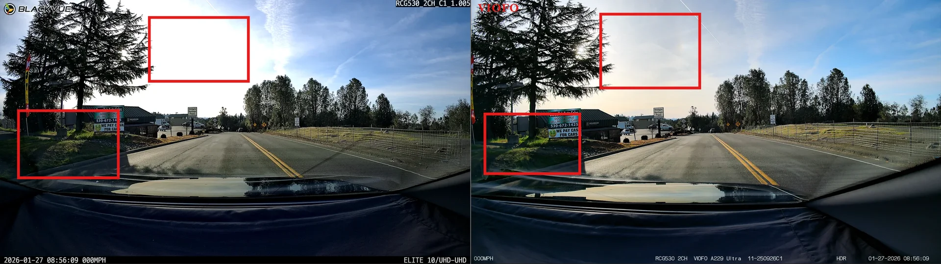

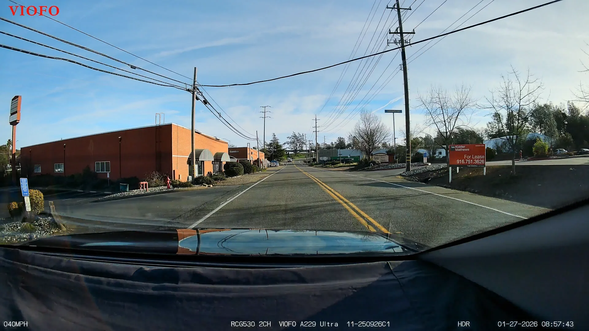

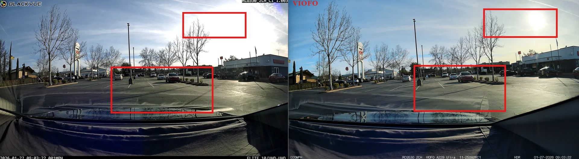

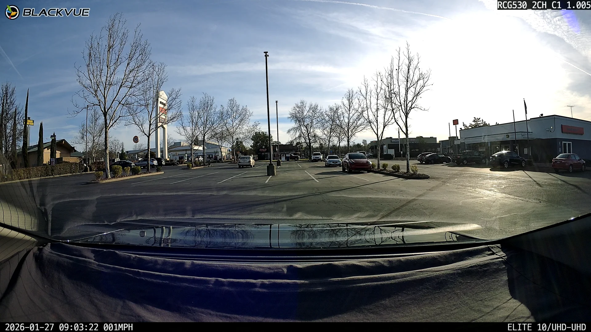

Here are a few Elite 10 4K rear frame grabs along with corresponding VIOFO A229 Ultra 4K rear frame grabs. This is to see what no HDR [Elite 10] looks like compared to HDR [A229 Ultra].
01_Elite10_20260127_085527_NR.mp4_snapshot_00.42.webp01_A229_Ultra_2026_0127_085559_000048R.MP4_snapshot_00.10.webp
02_Elite10_20260127_085729_NR.mp4_snapshot_00.13.webp02_A229_Ultra_2026_0127_085659_000050R.MP4_snapshot_00.43.webp
03_Elite10_20260127_090015_NR.mp4_snapshot_00.08.webp03_A229_Ultra_2026_0127_085959_000056R.MP4_snapshot_00.23.webp
04_Elite10_20260127_090318_NR.mp4_snapshot_00.03.webp04_A229_Ultra_2026_0127_090259_000062R.MP4_snapshot_00.22.webp
05_Elite10_20260127_090722_NR.mp4_snapshot_00.02.webp05_A229_Ultra_2026_0127_090659_000070R.MP4_snapshot_00.25.webp
As expected, HDR allows the details on the very bright spots to come out. I wonder how this will translate to night performance out the rear as the front benefits greatly. Thanks for sharing.

i am very confuse why blackvue make a 4k carema without hdr
maybe blackvue want sell more elite9
Thanks to rcg530 for collecting and sharing the video comparison tests. From the footage, while the VIOFO A229 Ultra shows some advantages in overexposed areas due to its HDR performance, the ELITE10 appears to offer better overall image clarity, particularly in dark-area details and the readability of certain billboards.
a229ultra can update his firmware to deal with what u say
but elite 10 can not add HDR forever
BlackVue could add HDR in future by firmware. They did this with the DR970X Plus.
actually i compare elite 10 vueroid s1 and viofo 329t
s1 better than 329t better than elite 10
I look forward to your review and comparisons
